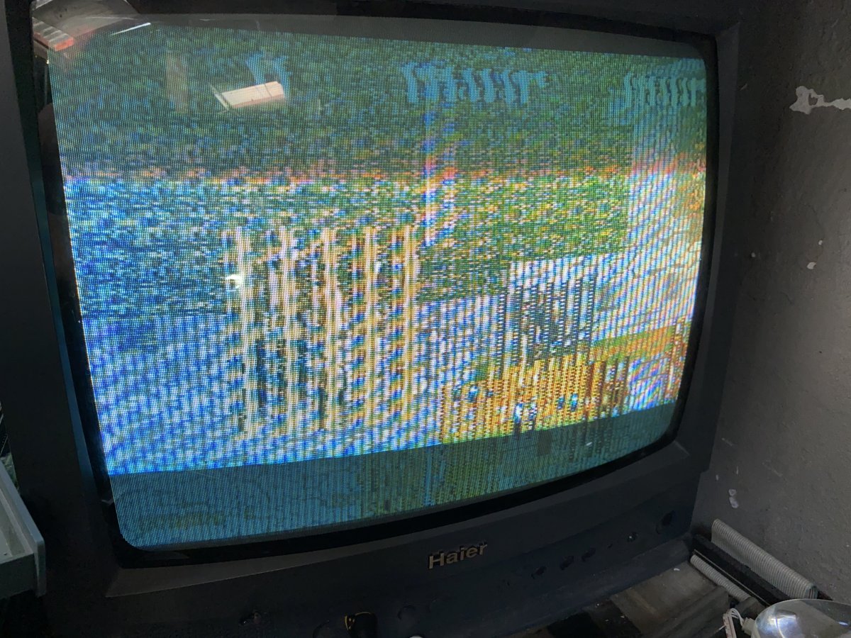

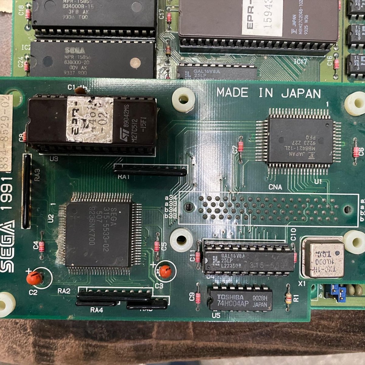

Replaced the 4 GA2 Eproms. I’m getting this. It takes credits, however, start doesn’t work and try to access the service menu returns a blue screen. I just burned the 4 main eproms as I have the original pcb and the custom security IC died. Jumpers are OK. Security pcb was removed right after the 4 V60 code eproms were replaced.
I’ll replace the pcb SRAMs, just in case. Anything else I should check?
Thanks!!

Only because you have it in your photos… did you remove the security pcb completely?
