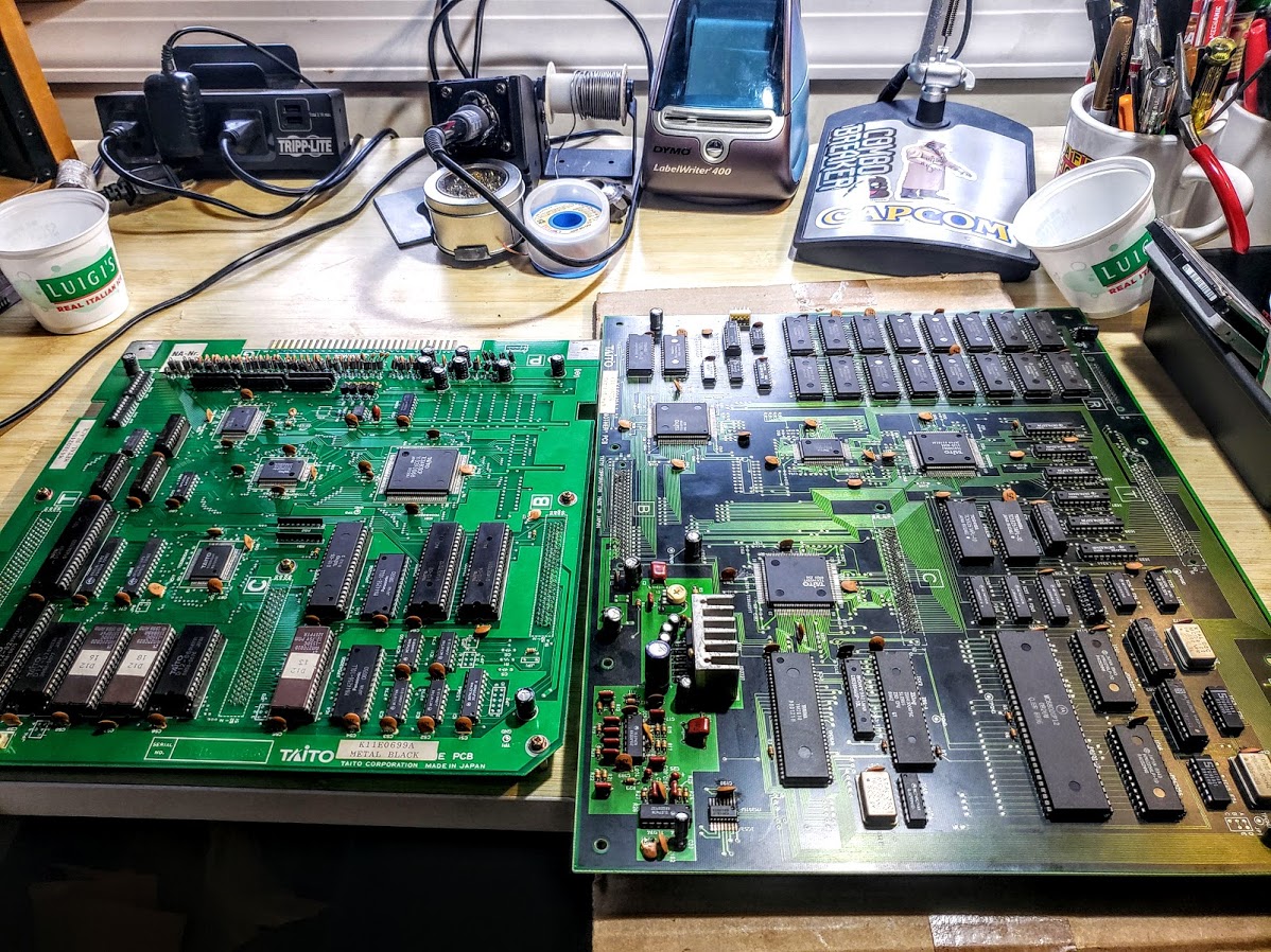

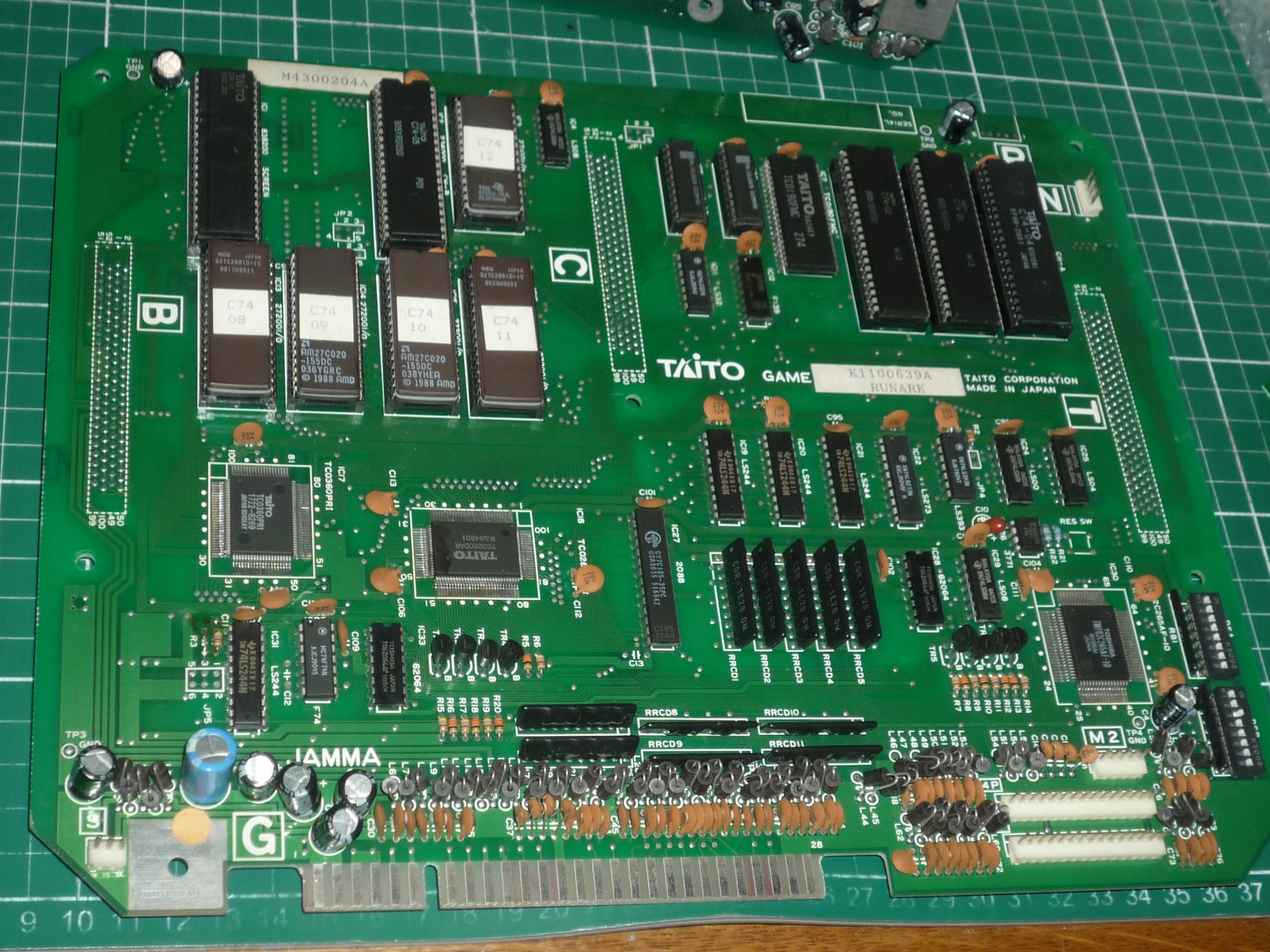

I see a lot of Rom boards for Taito F2 out there.
Runark/Growl
Ninja Kids
Dino Rex
Dead Connection
Majestic Twelve
etc.
Example...
So I got this Metal Black.
I was under the assumption it was a Taito F1 platform board, but it's 2 pieces.
System 16 doesn't really explain what it is outside of the fact its shown as 1 board.
So is my Metal Black technically an F2 or an F1?
Can I buy those above rom boards, and just plug em in to the mother board and they'll work or do they need PALs or something?

That's definitely a F2 motherboard, the "long" variant to be exact. There's also a shorter more compact version.
You should be able to attach any F2 rom board :)

I trust this is the "Short board" mated with a "Dead connection"
I assume the variants of the Long vs the Short have certain differences?
Is one better than the other for certain games over the other???
Thanks for the knowledge on this.

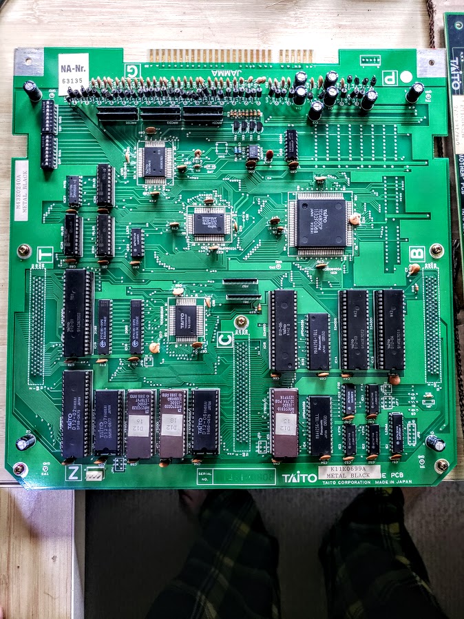

AFAIK there's no difference between F1 and F2. while the system 16 website separates the games the MAME driver lists them all as "Taito F2"
https://github.com/mamedev/mame/blob/master/src/mame/drivers/taito_f2.cpp
I own several of the games on System16 F1 and F2 lists and can tell you the mobo is the same.
there are two variants, the long and short as oneleaf stated, but they're functionally identical.
a lot of these games also came as single board versions, essentially the mobo and game board rolled into one. I've started to collect the single board versions, since the mobos seem extremely difficult to track down. and they're a lot more compact.
And before anyone asks about conversion... it's really not all that viable. nearly every "ROM board" and single board version is unique.
There are a few games that use "very similar" PCBs but even those would require PCB modifications and additional chips to make a conversion work.
I've played around with trying to convert Football Champ to Dead Connection, I think it's possible but it requires some 74-series logic ICS and adding wires for extra address lines. without access to a real Dead Connection PCB to see how it differs in routing I couldn't get very far.
For this same reason I don't know that a Multi would really be viable on this platform either, there are a lot of different custom chips that are only used by one or two games each.
yeah, if you wanted to you could just buy those ROM boards, plug them into the mobo on your Metal Black and go, nothing else special needs to be done.

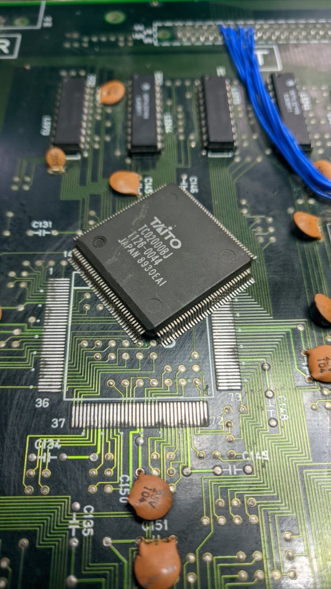

Hi,
I have some glitch on my Metal black.
Do you have an idea where can I found this custom chip please?
