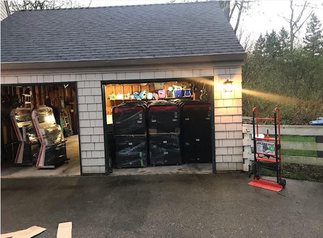

My next big project would be coming up with a solution to replace the stock monitor. I'm going to invest money on this since I greatly benefit from this. I work at a company that custom manufactures monitors for aircraft. I have a rough idea but I'll need a person to create a model out of it to have it manufactured. I have to decide if I want to manufacture a custom frame or work around the existing frame. I'm going to look into my other 24 vewlixs and see what solution would work. I already documented my Vewlix L frame so it'll be interesting to see how F and FC differ. Off the shelf monitors these days doesn't have any stud points so it makes it harder to design something. I'll make a thread sometime today.
