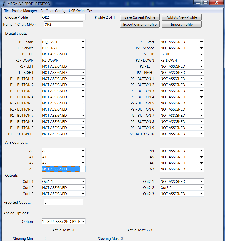

@Darksoft does the controller ports also support analog or is there a way we can hook up analog channels to it would be nice :) With a switch on the i/o or something

Where this IO excels is driving games. Unlike stick and button games which more or less follow a standard, the mappings for analog and digital inputs in driving games are all over the place. So in one game 1P SW1 could be shifter up, in some other game it could be view change. Brake could be acceleration and vice versa. If you wanted to have a multi driving cab, you would need to swap harnesses all the time. With the Multi JVS you just press a button on the IO to swap to a different mapping and off you go.
Yes, it has the standard 26 pin input for analog controls. As I said it supports up to 6 channels of Analog inputs, which can be configured as simple as this:
That's what the 26-pin JST RA connector is there for?
