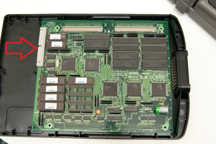

So some of you may have heard us mention that we were thinking of making some CPS2 communication pcbs for use with SSF2: TB so that anyone could put on their own tournaments and parties. It would be a clone of the original design and would plug into the B-board inside the case. Then if you had four (4) SSF2 B-boards you could install the TB roms and link them together to start your own tourneys.
Good news is this will work with the CPS2 multicart as long as you leave the side port available and dont use it for reset. See picture attached.
I plan to make a small batch on demand at cost price for those interested. I will release the gerber files for those who pledge in case they want to do themselves the PCBs.
Please NOTICE VERY IMPORTANT! In order to play tournament edition, you need to have 4 CPS2 systems with 4 communications PCBS connected together. If you don't then they'll boot as normal SSF2, without tournament.
Let us know in this thread if you would be interested and and how many you would want. Thanks! I foresee a price of 50 USD per PCB more or less but this is to be confirmed.

Most likely, I guess they just need to have the comm jack available.
They link with s-video cables.
With comm jack @Derick2k would mean the side port on the B board where the comm PCB will plug in.
Right, I'm asking if the DS board will be all that we need, or if there is some additional piece of hardware that we'll need to acquire in addition to a normal ROM-swapped b-Board.
You just need 4 B-boards with SSF2:TB installed, 4 of these comm pcbs, three S-Video cables, and one S video jack that has been modified as a loopback for the fourth pcb. You can just cut the end off of one S video cable and splice two of the wires in the cable together.
