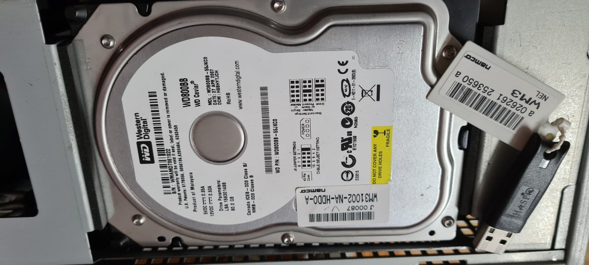

and you have the regular hard drive (EIDE) and the 2 usb keys?
@meyerli, can you post pictures of the HDD and dongle you're booting with that motherboard?
That's not a normal N2. The BIOS on a N2 contains specific offsets to load a WMMT3 drive. A normal WMMT3 drive shouldn't boot on any other hardware.
It's an IDE HDD and one USB dongle.
Strange. Will do the pics in half an hour.
That's the disk and dongle I got with the N2.
  • Like
Reactions: nem
This is VERY promising! I am blown away that you are using a regular motherboard to run this!
