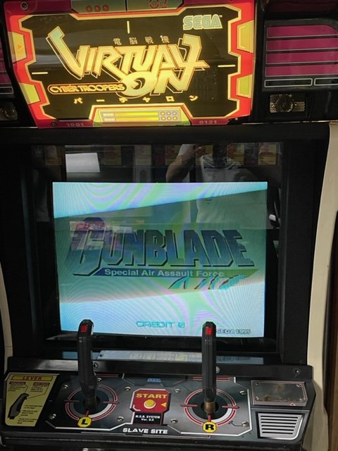

So after picking up a Virtual On early january, it took my a while decide what to move and make room for it in the basement. Time Crisis 2 was finally decided this weekend and reassembling this double cab has taken the most time of all the cabs I've brought down so far...
The good news:
They work!
The bad news: No link between them.!
Try this, try that, look at light from both side, make sure tx is going to rx ... all good.
Have spare board from early pandemic pickup! tried it ... same thing. Communication board must be bad ? tried swapping master to slave, nothing.

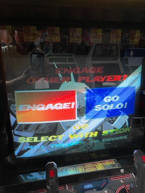

Until it hit me: I've been convinced the issue was with the slave side because the light was "pulsing" while the master was "no pulsing", it was just "on". The spare was also pulsing so I replaced the master and boom:
Very happy !!

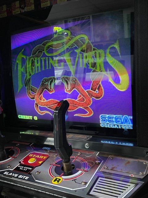

Was able to try a few other boards / ROM boards I have but never tried:
Left to do: the right side has no sound. I believe cause the 12.5 transformer, under load is only ouputting 8-9 v thus the soundboard is not starting? more investigation ASAP.

In french we say « plus c’est long, plus c’est con »… which translate to the longuer you search, the dummer the solution is.
So my sound problem, after having changed sound board, swapped transformers (the sound board is fine with 9volt), checked speakers, swapped pots, is resolved by… “it’s just a fuse” :
pressing and making a good contact on the 5v fuse fixed it 😑
