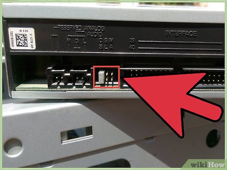

Did you set the DVD player Jumper to CL (Cable Select) ?

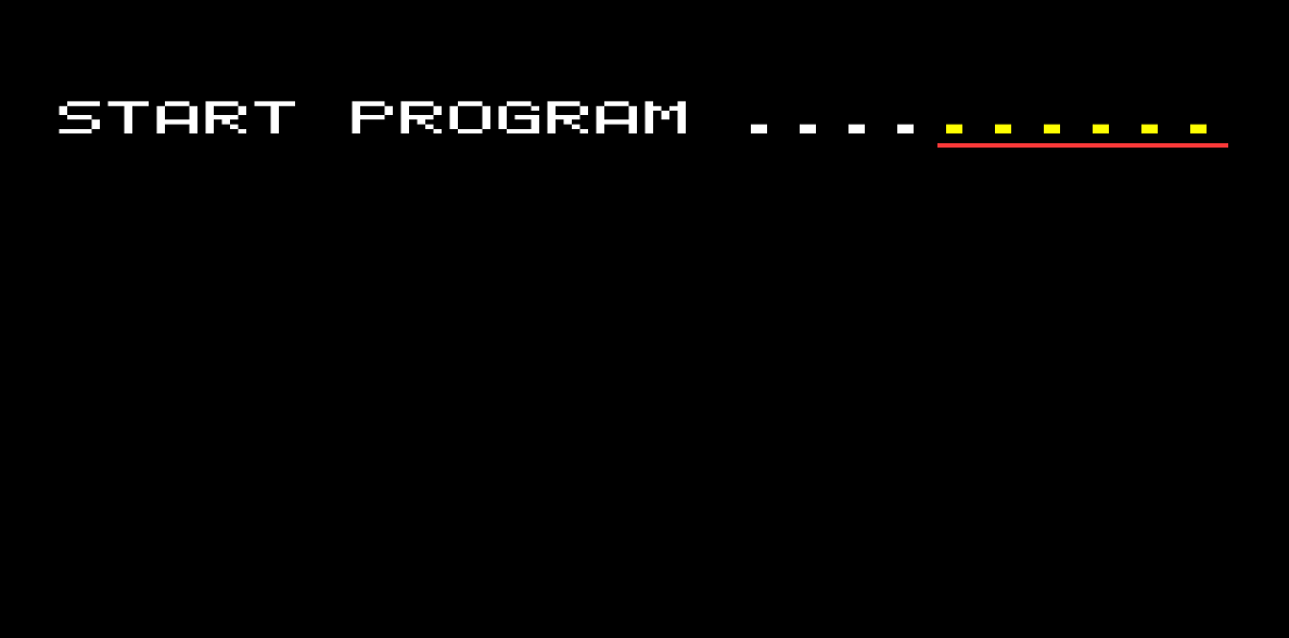

I changed to cable select and bumped the power up to 5.1. It's still showing green dots at start up and went to the black screen again unfortunately
you must configure your DVD player in cable select otherwise every other time it will go wrong

By configure the DVD player you just mean the physical jumper on the back of the DVD drive right?
Yeah its in 246+ mode.
Yes
Is this a thing for all 246 / 256 hardware that the drives should be in CS instead of Master??
Seems odd compared to the industry standard I would assume the drive is Master unless maybe something is dynamically needing to take master owner ship when the system is booting or something???

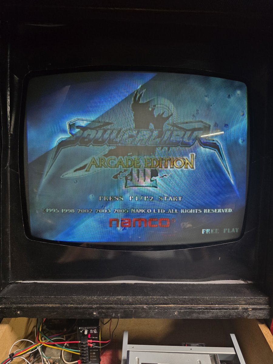

Made some progress! The disk version A got me to the title screen but it's still freezing.

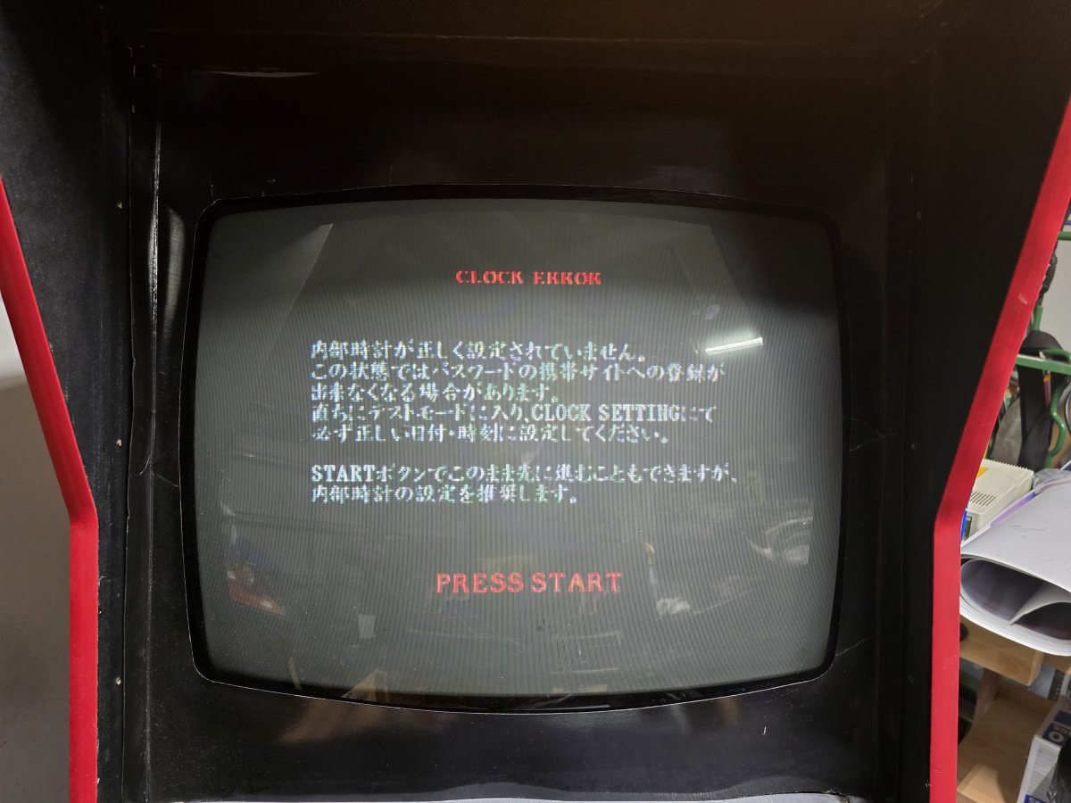

My dots on start program are still green and I got this error as it boots up. I haven't run it though a translator yet. I ran out of time to work on it last night

There is a coin battery on the motherboard - that is just telling you that it's dead. Replace it, and that error should go away. The fact that it's freezing is odd - your 5v line is up plenty at 5.1.
I can't imagine that is causing the game to freeze - but try that first.

Oh I have a fluke myself. I will check the 12v when I got home from work and I picked up a 2032 battery to replace the one on the motherboard.

Freezing at the namco screen. Going to chamge the battery now
Some progress. I change the battery (still get the clock error) and tried a few different things. I switched the version b disk and got yellow dots! Then it booted into the game and froze.
Then I tried switched the DVD drive back to master and it loaded and I was able to press start but then froze.
So then I put the 5v up to 5.15 and switched the DVD back to cable select and got here. Where I was able to load the character select but would let me select anyone and it just stuck

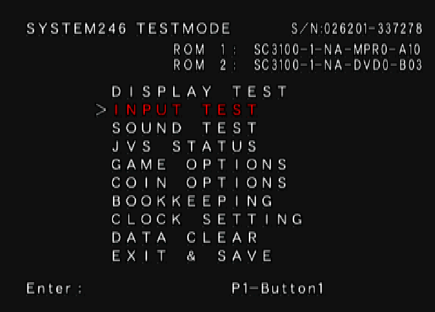

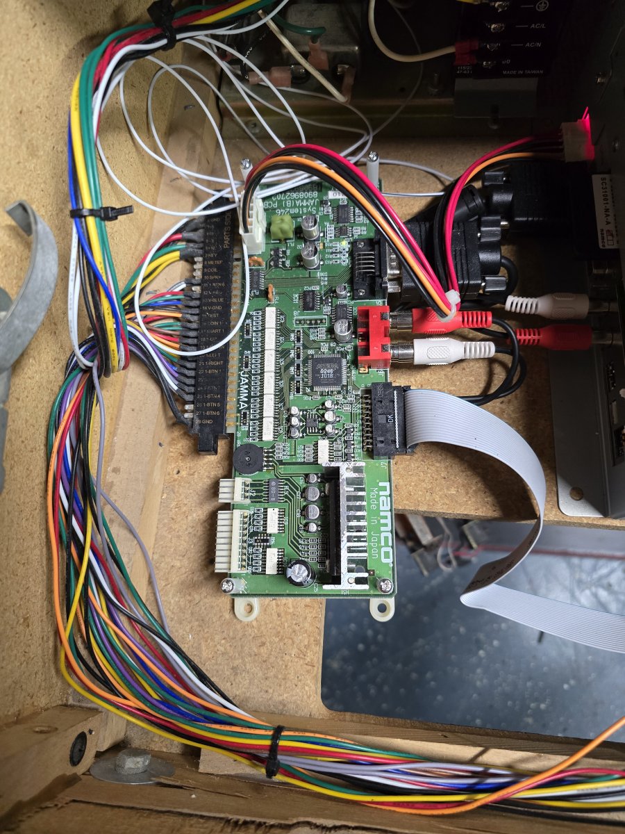

你这是因为IO控制板出现问题,或者按键映射错误,你进入服务模式测试下按键1234是否正常,因为每个游戏对应的按键会有变化,测试好然后再启动游戏
I confirmed my buttons and they are all working. I am still getting to character select and it will not progress into the game. The timer stops at zero and gets stuck. The music continues to play though
