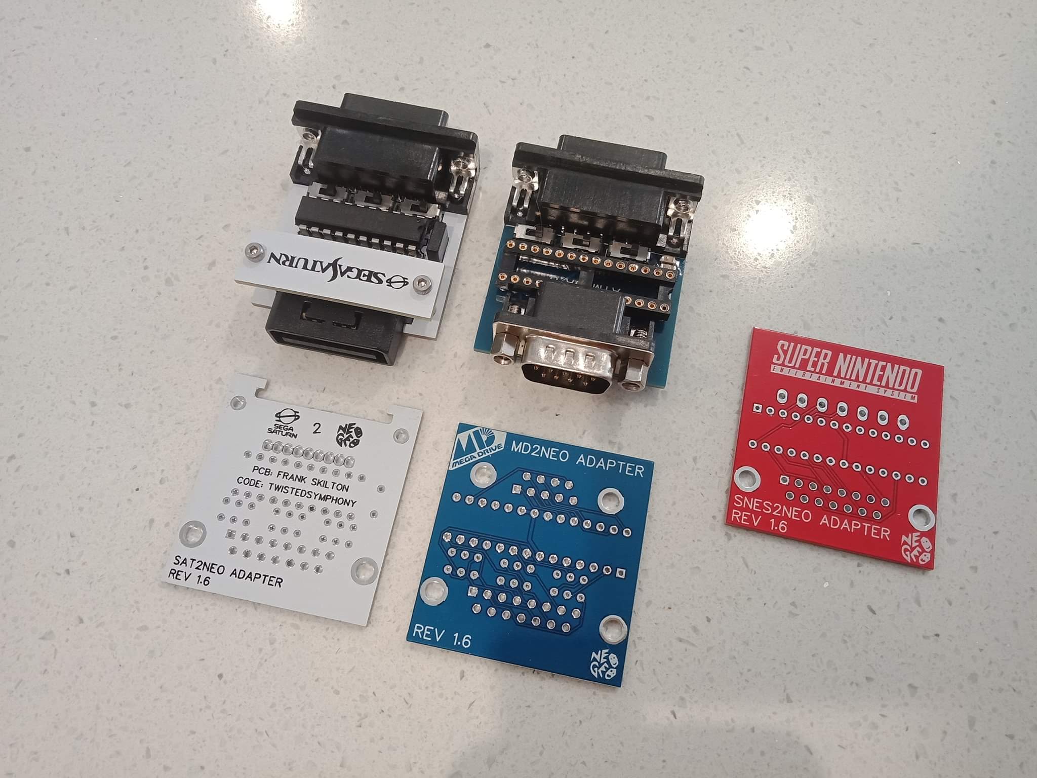

Had some white PCBs made, liking it.
Snes2Neo is awesome. I enjoy using the Snes pads as I find them comfy and they share the same button layout as Neo. Grab an 8bitdo bluetooth Snes receiver and many doors are opened.
$25AU for the Snes and MD adapters.
Those PCBs looks really cool. @Frank_fjs if these are your adapters, how do you drive the outputs?

Almost finished with this. Astonishing how well the Saturn connector fits.
Wanted to ask if you have a part number for the DB15 R/A connector. I like how yours is plastic and doesn't have a screw fastener. Reason being is that the ones I bought have the screw fastener and acts as a key preventing me from making a connection to the Minigun :).
