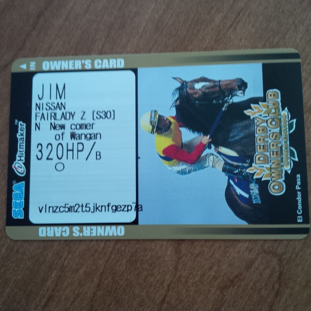

I got WMMT2 to boot with reader installed. I bought a card, finished a race and ejected.

I played a little WMMT2 with a card and noticed something odd. Apparently it updates the information printed on the front of the card. Is it supposed to be able to clear off the ink?
For example, I started with a car that was 320hp and upgraded it to 340hp. On my card, the 340 was printed over the 320.

I think it is supposed to be able to erase from what i've seen...
Interesting. As far as I've seen ID3 doesn't do that. Only new stuff in different locations is printed as you progress. Nothing gets updated.
If erasing does happen for WMMT I wonder if that's a function of the reader unit, the card or both. I'm clearly not using a correct card, so it's not a good test. I have a few WMMT cards and may eventually try it.
