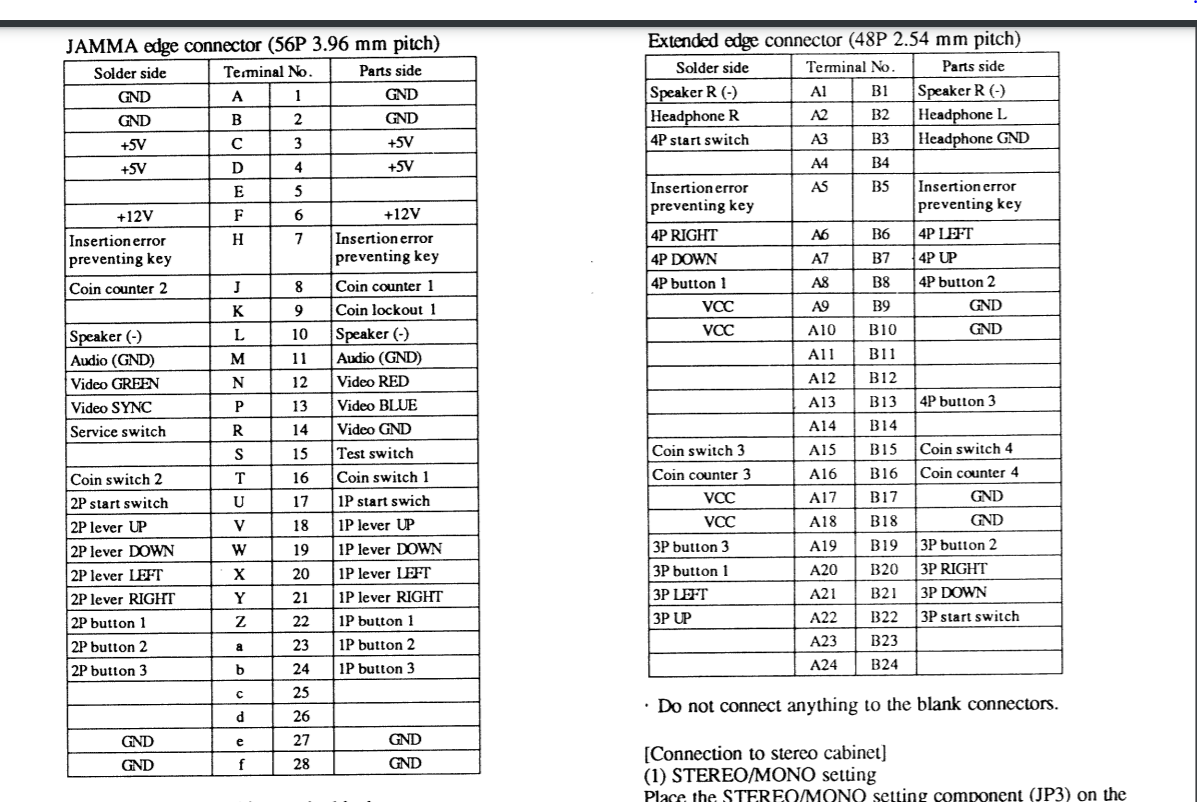

namco na-2
on the sound issue
according to the pin out i can have sound only if i use the the 48 pin extended edge connector,am i right?
can i solder a wire the sound from the 48pin connector to the jamma connector ?
no
mono sound is on the JAMMA edge pins 10 and L just like every other JAMMA board.
the extended connector is just for headphone or extra stereo output.
