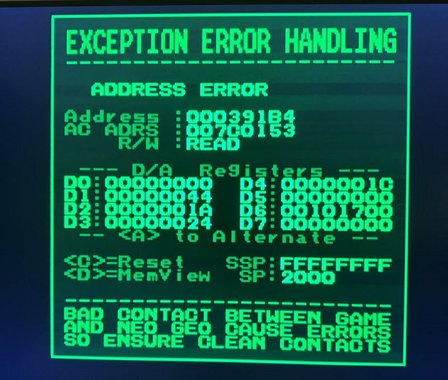

Fgto79 has kindly offered to help do testing on his AES DarkSoft Multi cart. He tested the neoragex 5.2a rom set of Garou but get's the fallowing error upon booting.
It's probably because it still uses the mapper mode 4, but not sure yet. I used the tool by aluzed to compile the set in Darksoft format.

The CRC32 hash is different for the Crom0 when using the python script that Darksoft made a thread about converting rom sets. Will test the Crom0 generated from the python script next when Fgto79 can test later tomorrow.

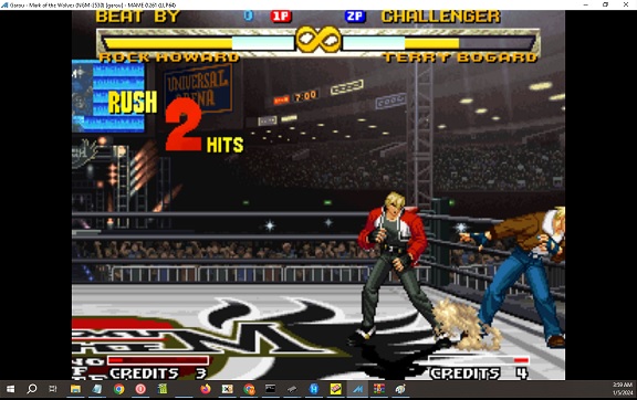

I've tried for a whole day to get it to work, but failed in the end. There are other neo geo sets in mame that address a single 8mb prom, svcboot and kof10th. I tried to overwrite the file names and adjust the m1 s1 rom regions and sizes in neogeo.cpp. Then compiled but just get a red or blue cross hatch screen. I tried to edit the Garou Bootleg entry with rom region and sizes of the neoragex set, but got the same thing. I tried a version of HBmame that has a some sets with a 8mb prom and changed the files from the neorage set to the hbmame set. This got the game to boot for whatever reason, but then immediately whet to a bios crash screen. I'm pretty sure both neoragex and mame prom files are in the same 16bit formats. They have areas that are the same in the upper header region when looking at the hex.
I'm at a loss here unfortunately. Can anyone please help getting the nrx set to load into mame so we can debug it.
So it turns out mame has all the debug data unencrypted already when using the final version rom set.
Couldn't figure out how the bank switching works. I fallowed this and was able to edit the Vram in these regions, but had no visible effect.
https://wiki.neogeodev.org/index.php?title=Fix_bankswitching
I then decided to comment out the srom bank switching in neogeo_spr.cpp. This showed the fix layer as if only the first 128kb are being read of the srom. Minimal fix layer corruption. Really only the power bars, combo counter, and the round win icons will need to be addressed. I'm going to try to burn this set and see if it behaves the same on the 161 in 1 cart.
Making progress. Combo, reversal topdown, ect works. Life bars and special gauge redid. Just have to do the icon for the S/P above the power gauge and the win icons. It all fits in 128kb so far without having to overwrite the neo geo into splash screen. Still haven't tried it on a 161 in 1 yet, but if there is still a bank switching issue I'll have to figure it out.
Got stuck on the S/P tiles. The hex doesn't show up in the Prom like it did for the life and power bars. I think because of their animation it's in a function or routine. I'll try to mess with it some more but if anyone who is handy with assembly could help please PM me.
