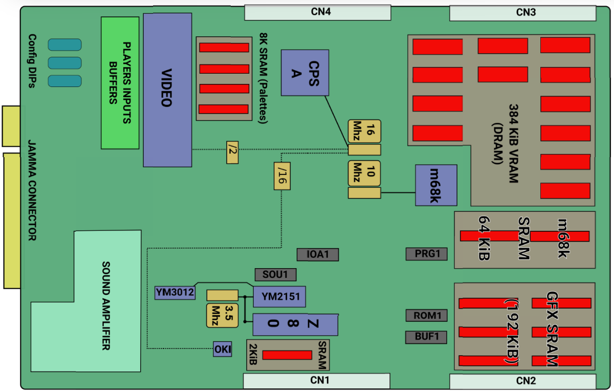

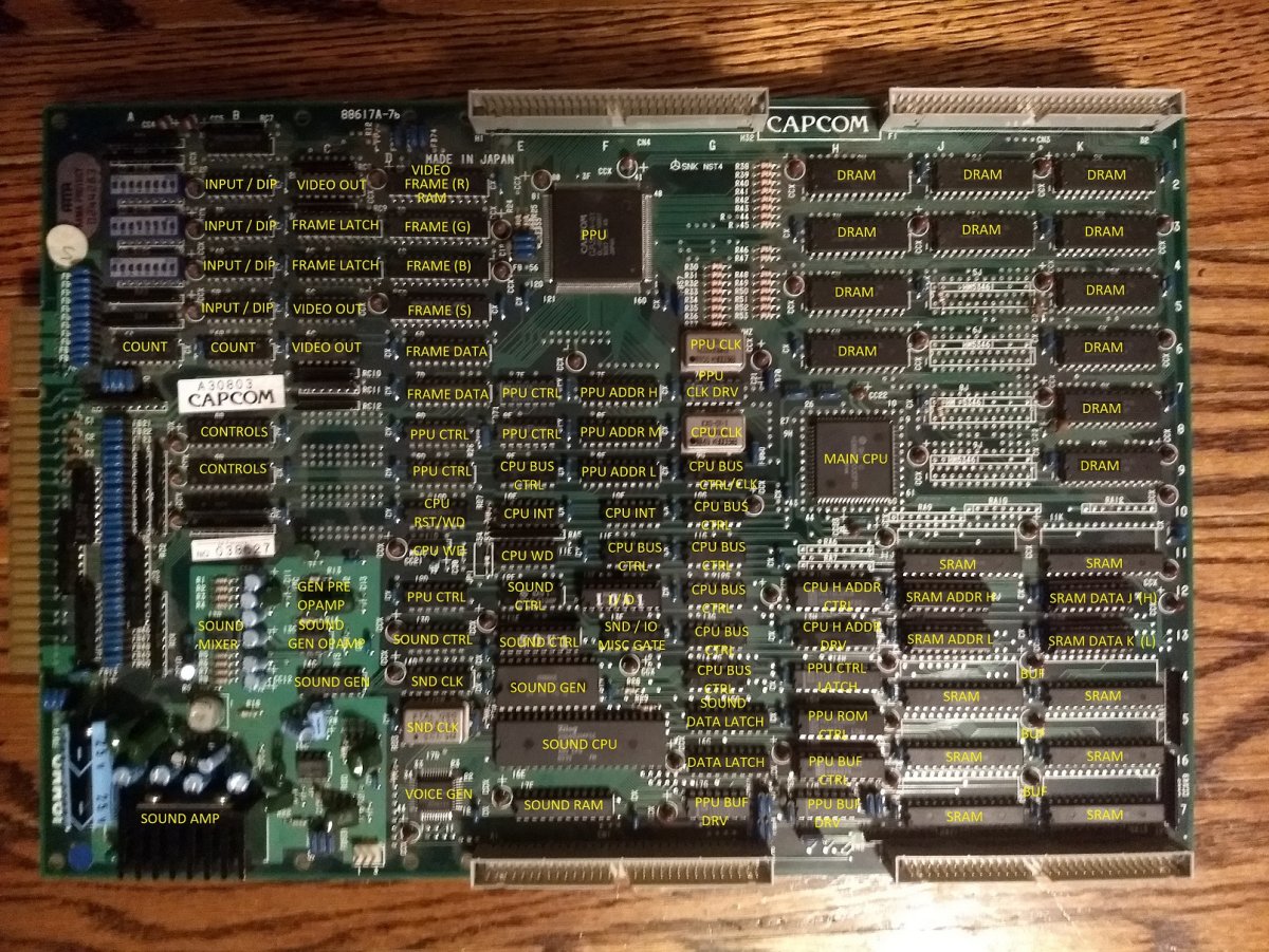

Sorry to hear your board is acting up. It definitely sounds like it could be a failed RAM chip from the diagnostic error, but try running the game out of the case first just to make sure the board isn't grounding out on anything. Try removing and reseating the A+B+C boards as well.
Here are diagrams of what chip does what on the A Board:
None of those are clearly labeled as SCR1, but I'm pretty confident your culprit will be one of the six SRAM chips in the lower-right corner of the main board.
