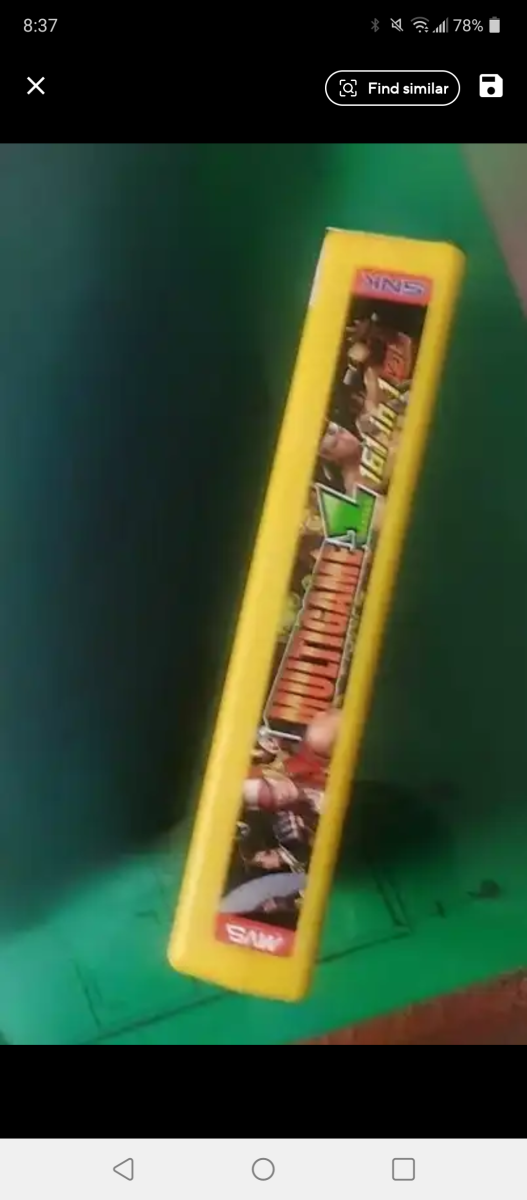

138 in 1 with Sammy chips ?
Are you thinking of sacrificing that cart? Please do not. Pretty rare now.
