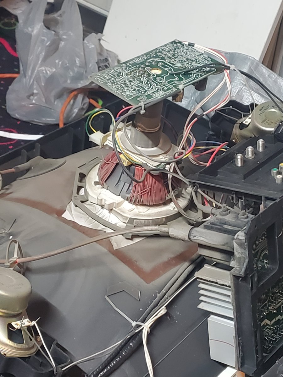

Thanks guys, here are some photos shot few days ago. Will check resistances and post here later.

I found a little 19" on the way to work today, covered in dew, and was hoping I could use it for one of my electro home or k-7000 19" monitors with PAC burn. Donor Model : F19253BC
I Tested the ohms on the V and H coming off the leads built into the yoke.
11.3 V
3.8 H

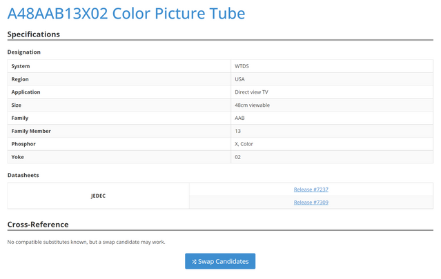

Here is the Tubular cross reference of the RCA tube model A48AAB13X02
I'm unsure of neck connector types and wondered if there was a database for arcade chassis that listed neck connector types and default Ohms.

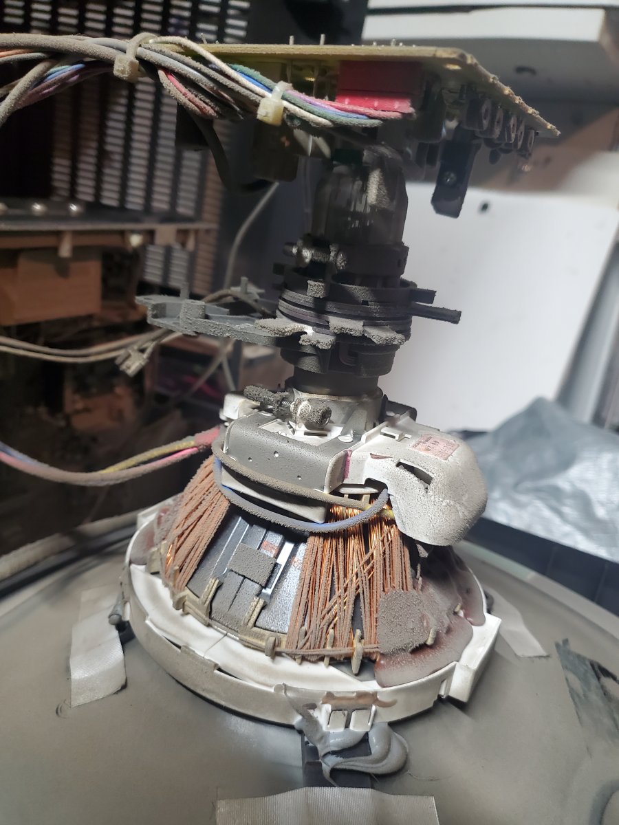

Since I had my screwdriver out. I decided to decase a PRO Scan PS27108 27" Semicurve to check if it would help my Nanao 2931
Ohms
8.2 V
1.0 H
I don't believe I have seen a yoke transplant on a 2931 or 33 and wondering if this is a waste of time as I will transplant the OG yoke anyways..

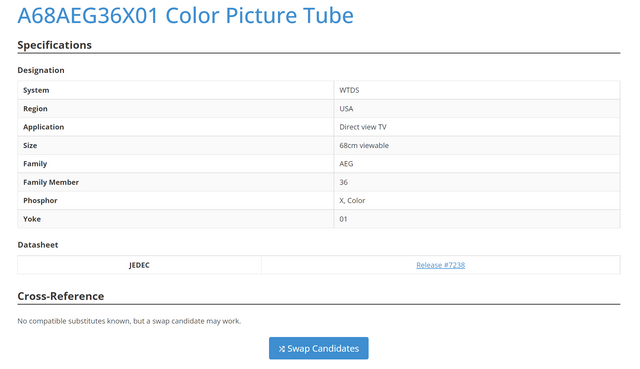

Here is the tubular reference on the RCA A68AEG36X01 tube.
Thanks for any help to hopefully get my candies monitors back in action.
I don't think you'll ever find a consumer television that has a 0.200mH yoke that will compatible with these chassis. You'll always need to transplant the original arcade yoke on to the donor tube.

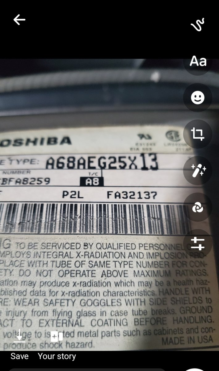

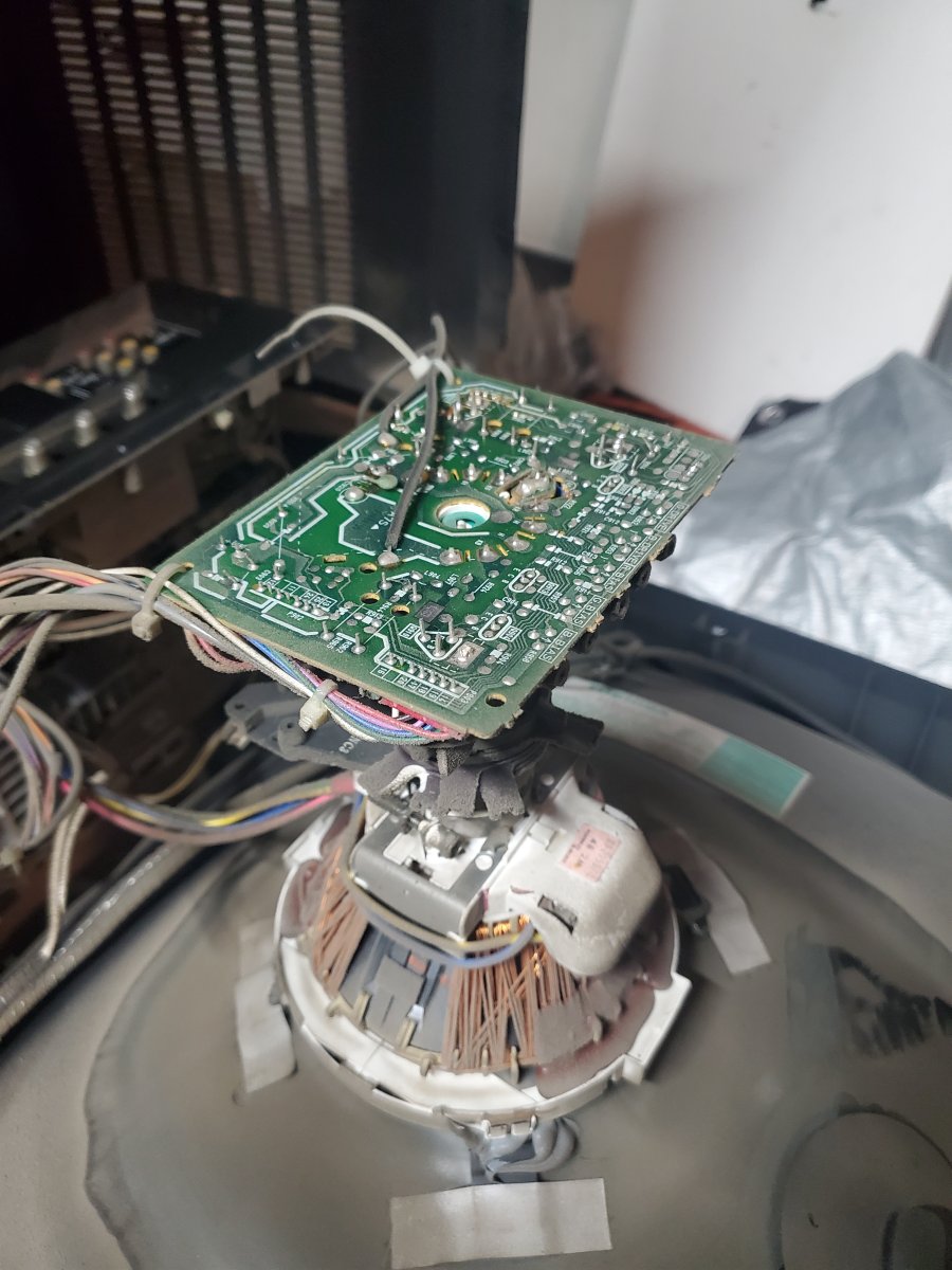

I have a question for those of you who tube swap all the time. I have two A68 tubes. Both from Toshiba 27" screens here in the U.S
The curve looks right. I popped Both out of cases, one has purity rings non bonded yoke and might work. But what about the 2nd one with NO PURITY rings and also probably no bonded yoke. Anyone use one this style??
Tube #: A68AEG25X13
One of the deflection connectors measured .219
The other one I couldn't read or think it said 12.789 or 13? Would this be a good candidate for an ms2931 tube swap??

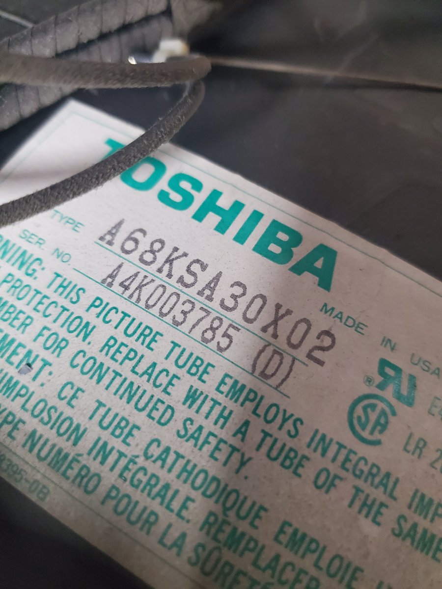

I also have this 2nd one I picked up tonight
Tube #: A68KAS30X02
This one does have purity rings, also appears to have no bonded yoke. Did not get a reading for it.

A68KSA30X is actually the standard tube most often paired with a Hitachi GMK chassis and sometimes a MS9. That's a great get.
I don't know of any consumer TV in this size that comes with a 0.200mH horizontal yoke, so I doubt either of these tubes would work as is with a MS2931.

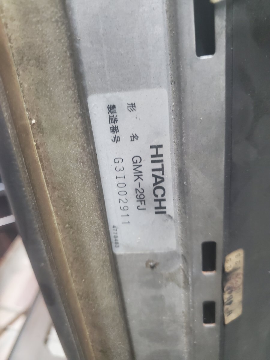

I have a GMK Hitachi chassis and that's totally different. My GMK tube is this one...you possibly meant GML??
Consumer TV tubes very unlikely have MS9 compatible yokes, but the tube itself is good.
I have three Neo 29 / Neo Candy 29. They all have A68KSA30X paired either to a GMK-29FS or a GMK-29FS2.

The picture of the 1st tube looks like a bonded yoke to me. To echo nem, its highly unlikely that a consumer tv yoke would measure out to meet ms9 spec or ms2931 spec yokes.
Consumer TVs (and their yokes) almost never were designed to drive 24Khz or 31Khz signals, thus are likely incompatible from electrical standpoint with those chassis.
This means you need the original yoke from the arcade monitor to swap onto the donor tube. In your case, if the tube fits the blast bezel, then you just need to find a ms2930/31/33 yoke to swap that arcade monitor yoke with the consumer tv yoke.
FWIW, 19" or A48xxx tubes usually can retain their yokes for the purpose of installing an arcade monitor chassis. Many 19" arcade chassis's (K7000s for instance) are typically made for low impedance 15Khz yokes and most 19" consumer tv yokes (from the mid 1990s onward at least) are within a similar spec and thus can be compatible without a yoke swap. I have never sourced a 27" or A68xxx tube from a consumer TV that is compatible with any dual res or tri-sync montior without a yoke swap.
