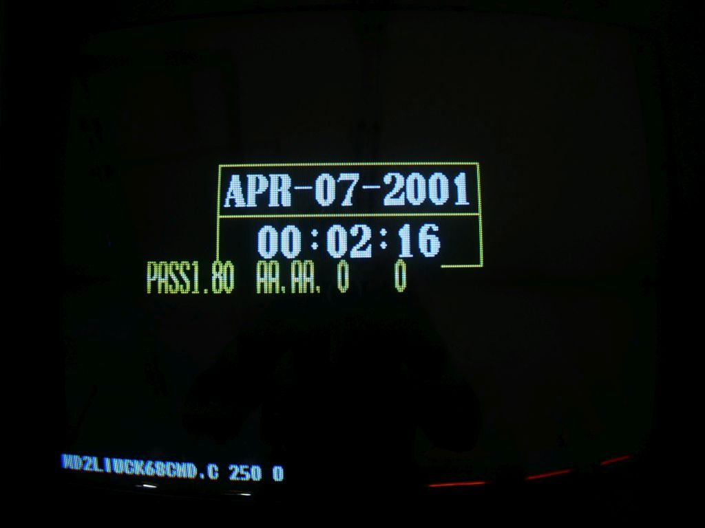

Here are a couple of region hacks I'd love to have tested.
One is for Demon Front.
I just tried this with my Korean Demon Front cart. It gets stuck on the calendar screen. After a while it posts some text (PASS1.80 and WDLIUCK).
EDIT: I'm an idiot. It works fine.
I just tried this with my Korean Demon Front cart. It gets stuck on the calendar screen. After a while it posts some text (PASS1.80 and WDLIUCK),
Are you able to pm me a dump of your original program ROM? I'd be happy to try and patch it for you. It may be different or reference different locations/data in the asic.
Sure, I'll send it to you later today.
