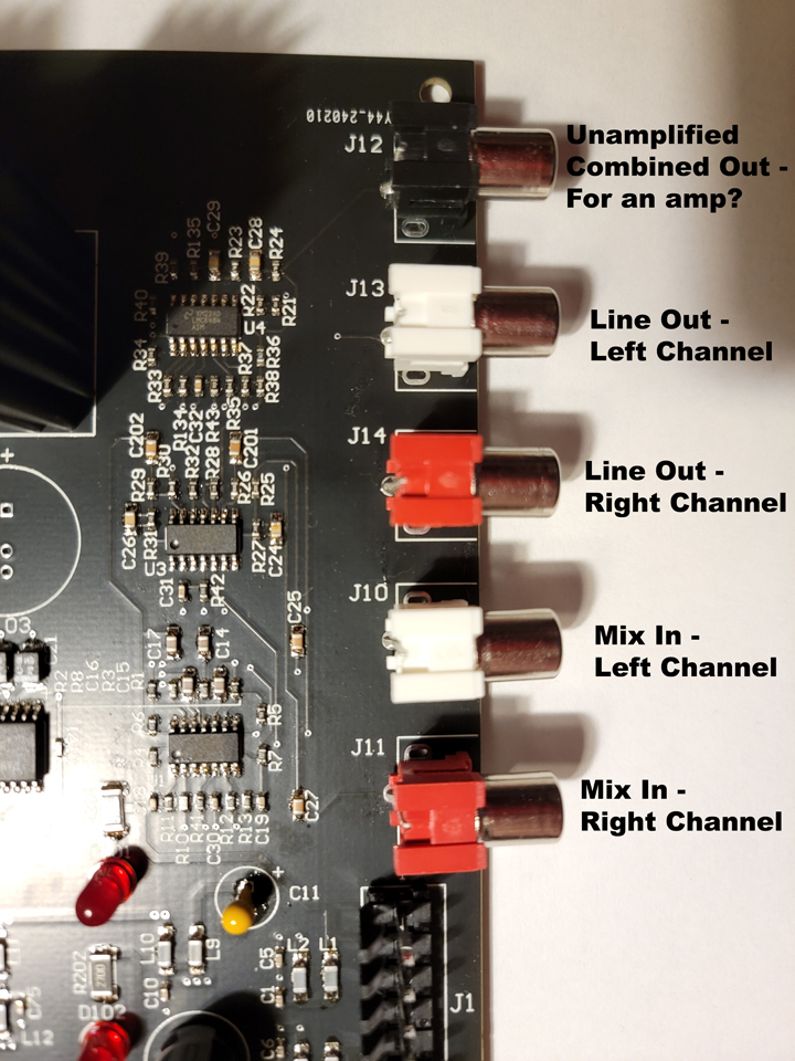

Pin-out of RCA Jacks

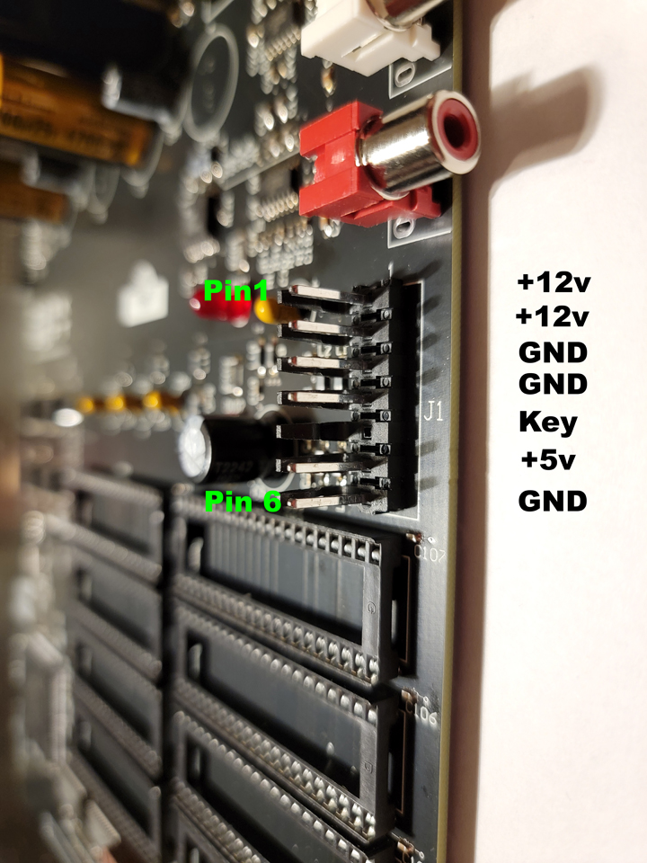

Power Pin-out for J1

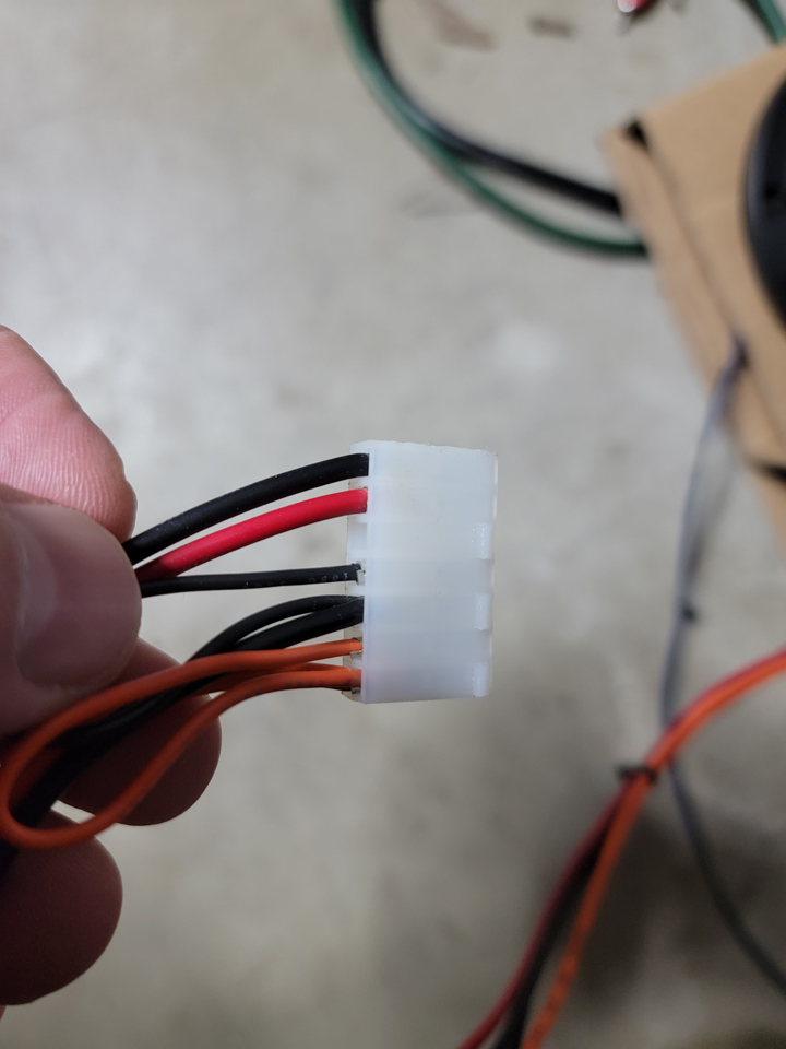

The factory power connector had pins looped rather than individual wires for each pin:

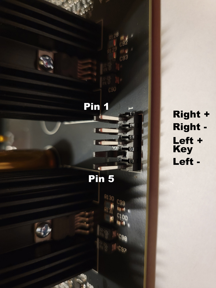

Speaker Pinout

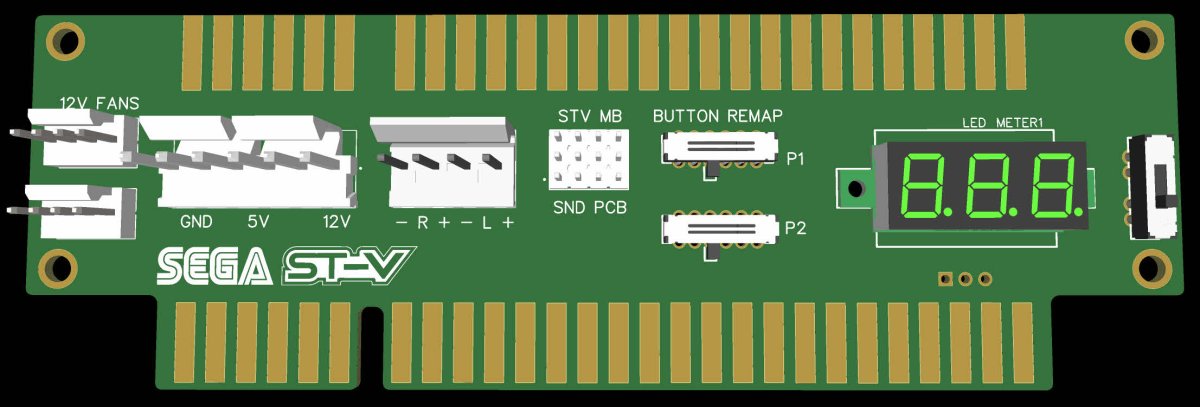

Ok, slight update, but Im getting close to ordering what should be the final version of this. I hate feature creep :D
Still have to tweak the layout a bit, double-check spacing, and probably rename a couple of things but here we go:
  • We have 12v fan headers
  • power and speaker-level audio connectors that go to the Batman sound PCB
  • 3x4 2.54mm pin headers, these are used to switch jamma audio from the STV MB or the Batman sound PCB, unfortunately, I could not find a 4PDT switch to fit the specs needed (size, contact rating, etc.)
  • We have the button remap slider switches
  • Finally added an LED voltmeter (this is optional)
This will be a 4-layer PCB with 2oz copper and gold enig - it will probably be black color. I have spaced the jamma edge according to Hirose's dimensions.
Let me know what you guys think. Any changes or suggestions?

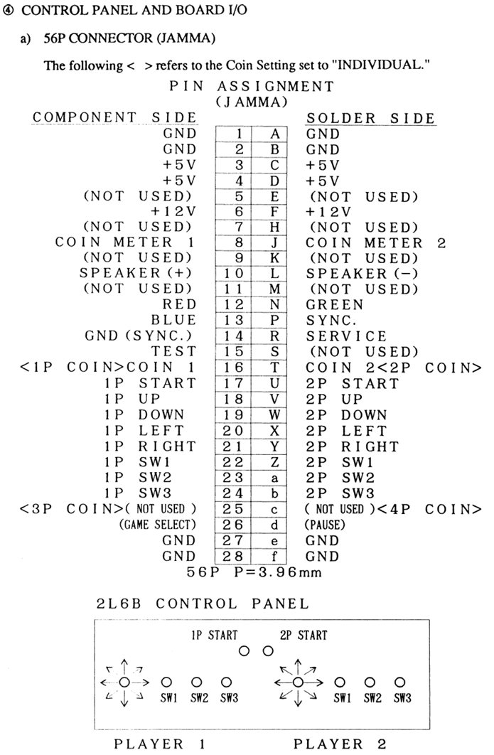

On Batman Forever JAMMA button 1 is not used and the 3 buttons that the game DOES use are mapped to JAMMA buttons 2, 3, and 4, so you essentially have to shift them all over by 1 on the JAMMA edge.
It's documented on pages 23 and 24 of the manual: https://www.arcade-museum.com/manuals-videogames/B/BatmanForever.man.pdf
