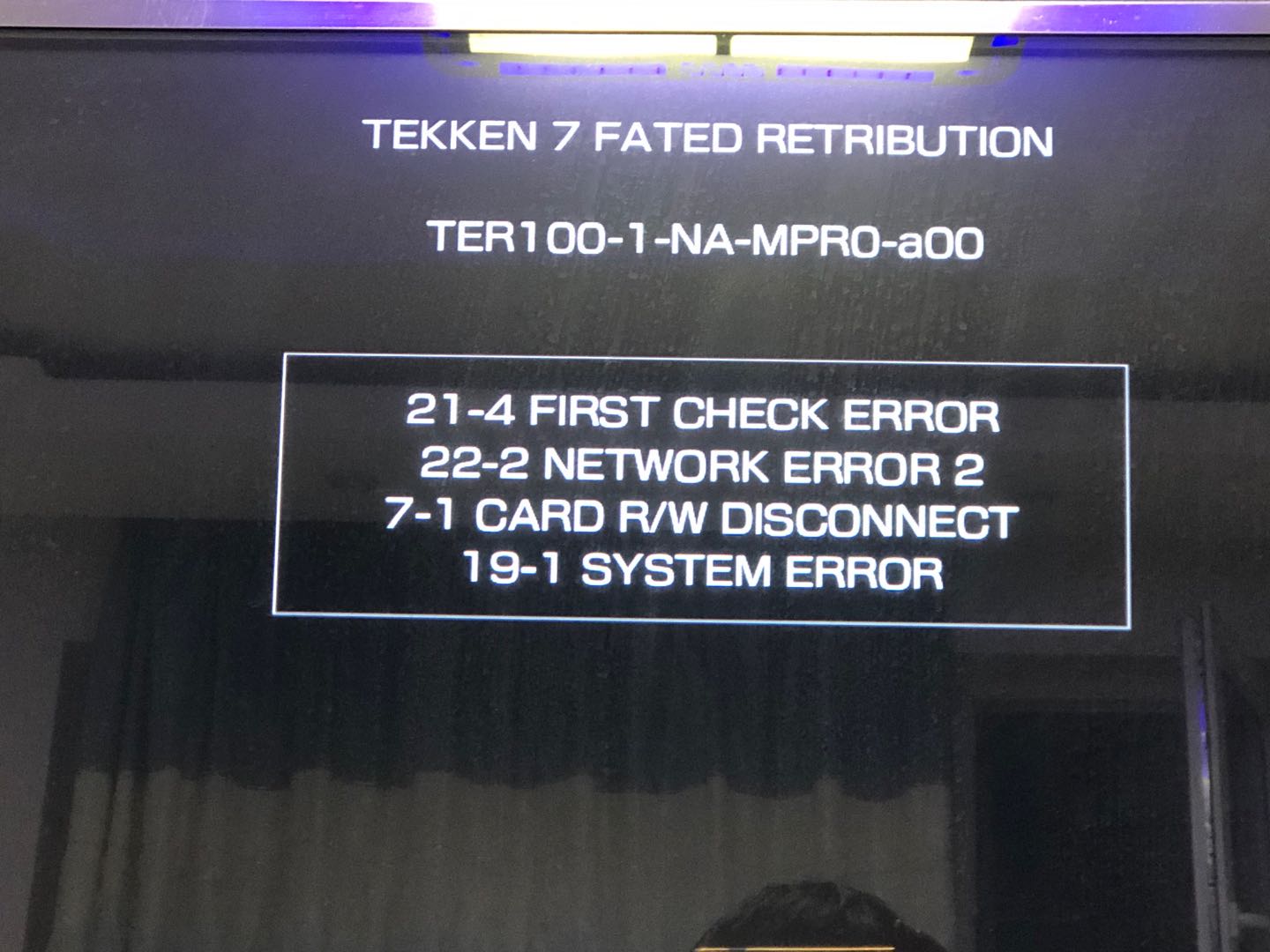

This is the error I get! The last picture, I used an app to translate. Not sure what I can do to make this usb update my unit to Round 2! If anyone knows how to make this work, that info would be very appreciated.
In my experience, this USB should be memory type. When using BitLocker, I should take out the IMG of USB storage data and update it to the system after starting the system so as to load new content~

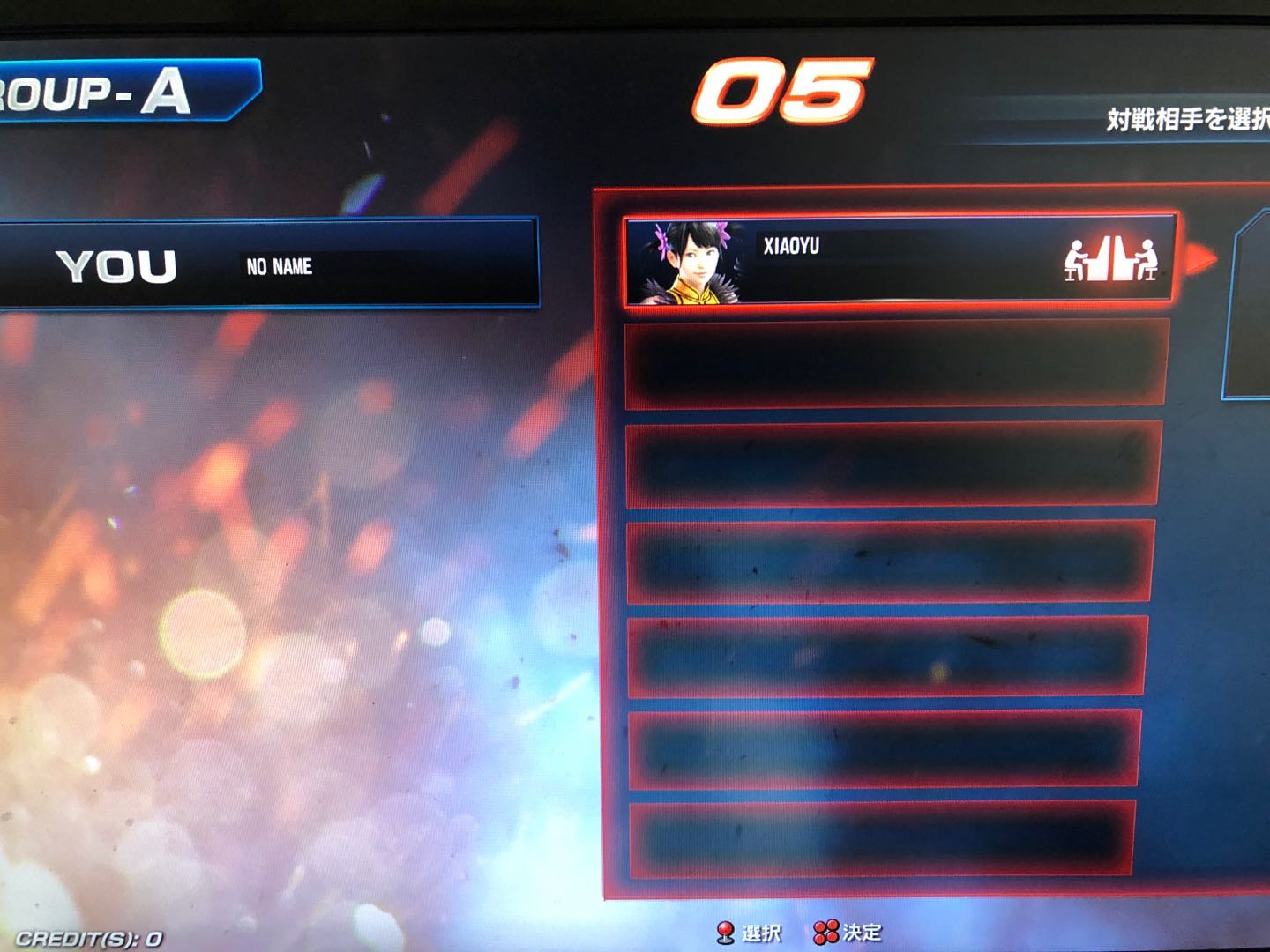

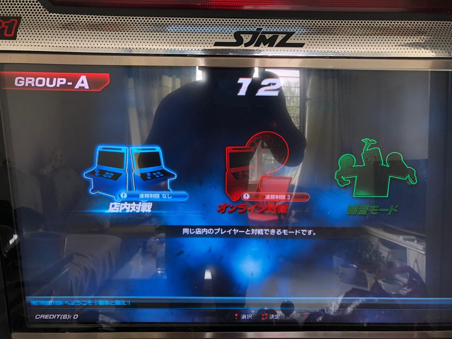

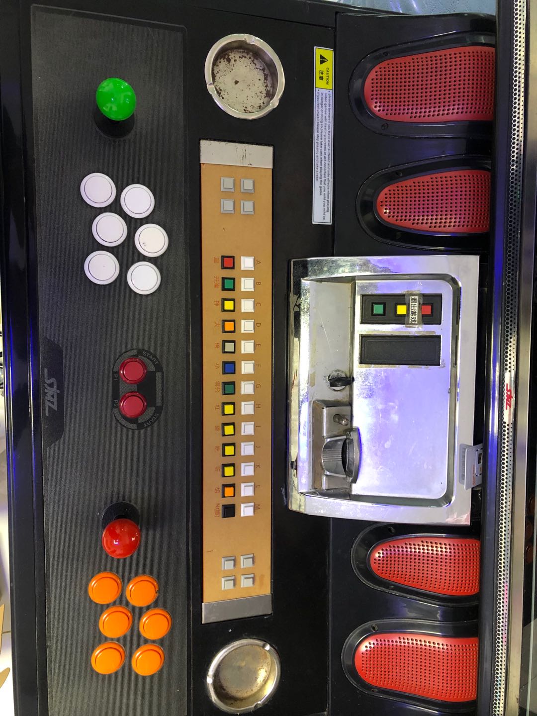

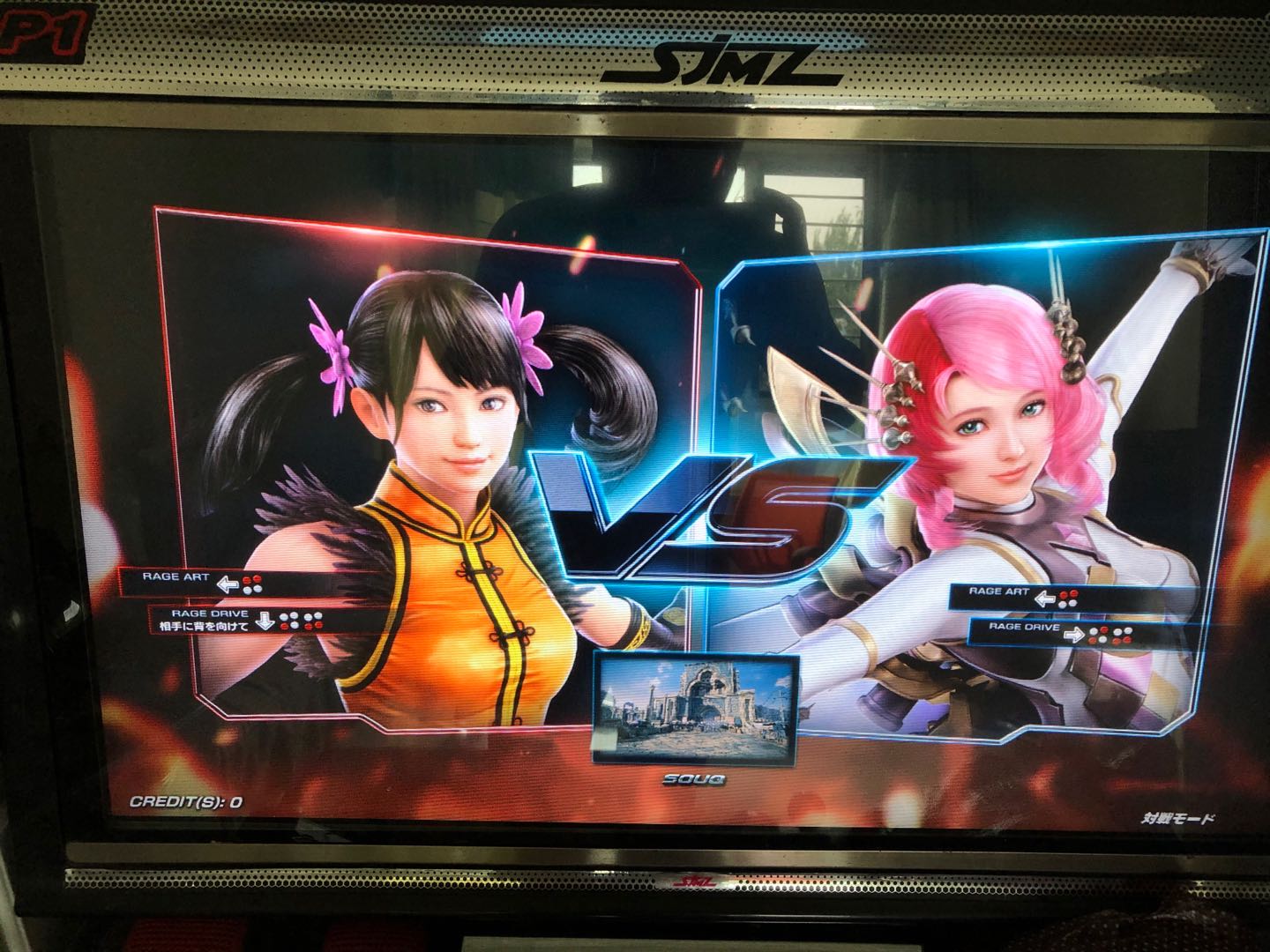

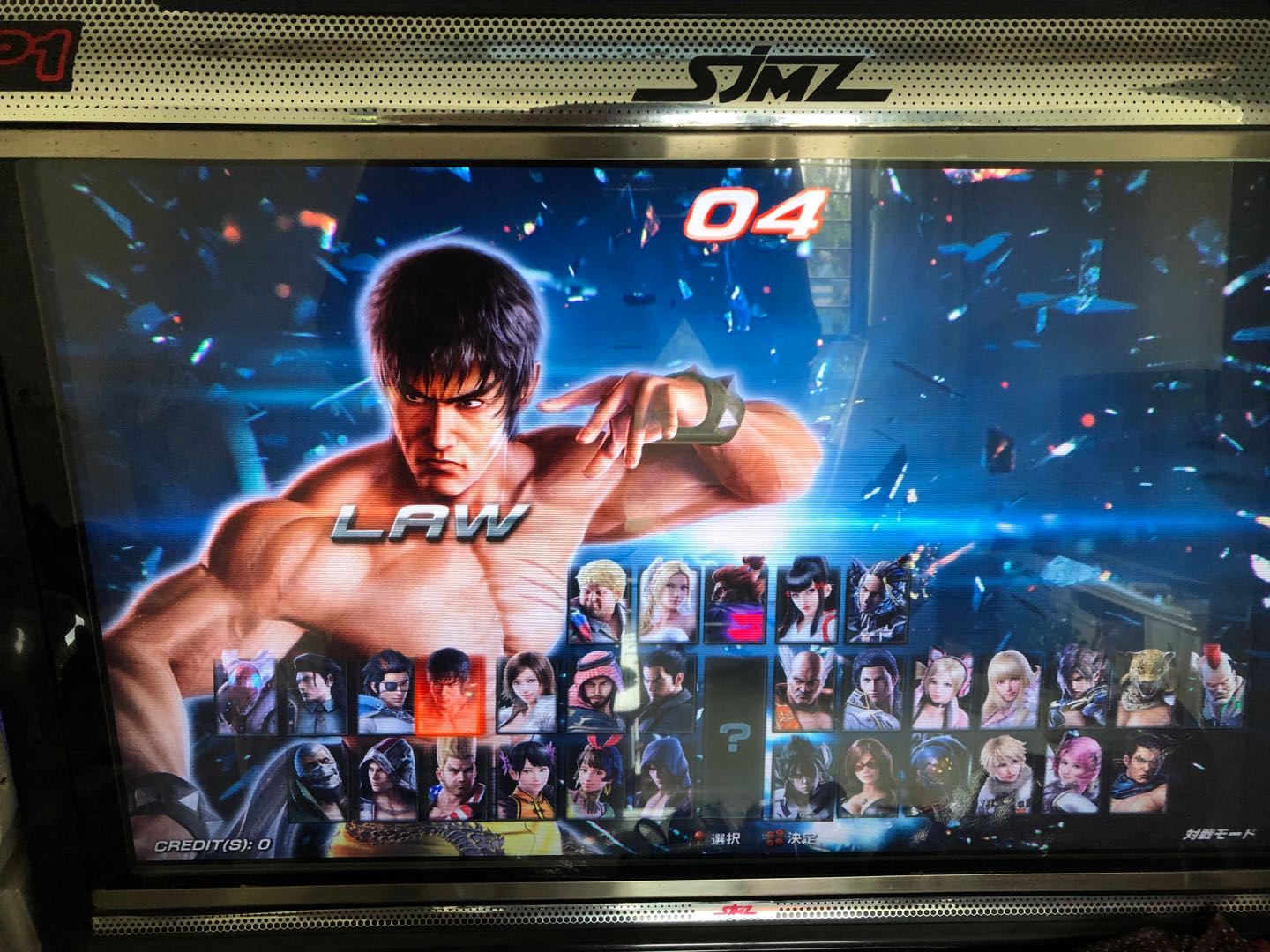

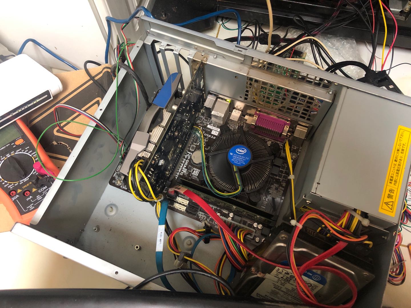

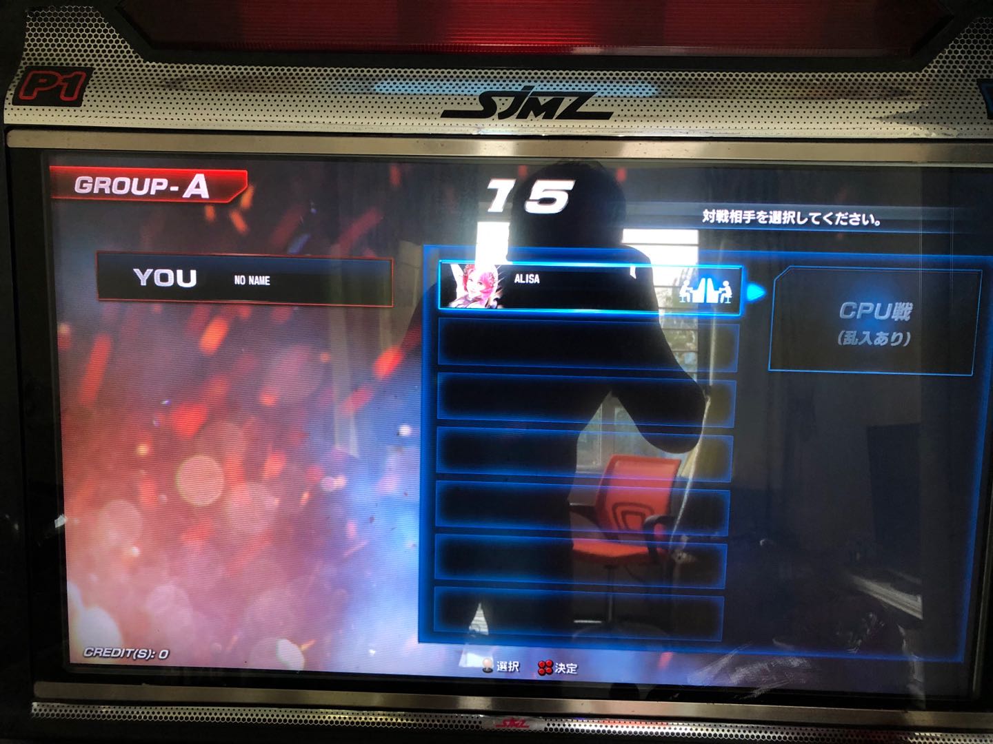

This is my frame machine.Of course, this is an ordinary PC machine! I have studied for a long time from the beginning to the present. I started to encounter mistakes until I skipped them and finally successfully entered the game. Now there is a small problem. Even after online, as long as the blue group beats the red group, it will drop the line. I have a win7 and a win10, and I don't know if this is the reason why the blue group defeated the red group and dropped the line! Red group again into the game can not see the blue group! Blue group into the game can see the red group, but also online, red group won no problem, blue group won on the line!

For this to work on PC's - it is possible.
First make sure everything is the same!! Pc windows version has to be same, so both windows have to be 7 or 10. Then make sure both pcs have the same tekken image, it's better to have them connected on it's own router than your home network!! I use linksys routers with the settings in the pictures and I can get 4 pc or real tekken 7 Hardware ES3 machines working. Also when your group loses most the time it will drop because there is no rematch option but you should still be in the lobby and not kicked out after the match.
cy6y , that is really nice! are you using a regular PC and able to boot and play the game with no emulator ? Please , do you have any guide or documentation of how to do this? Thanks. I was using in my video Teknoparrot emulator but this is amazing.

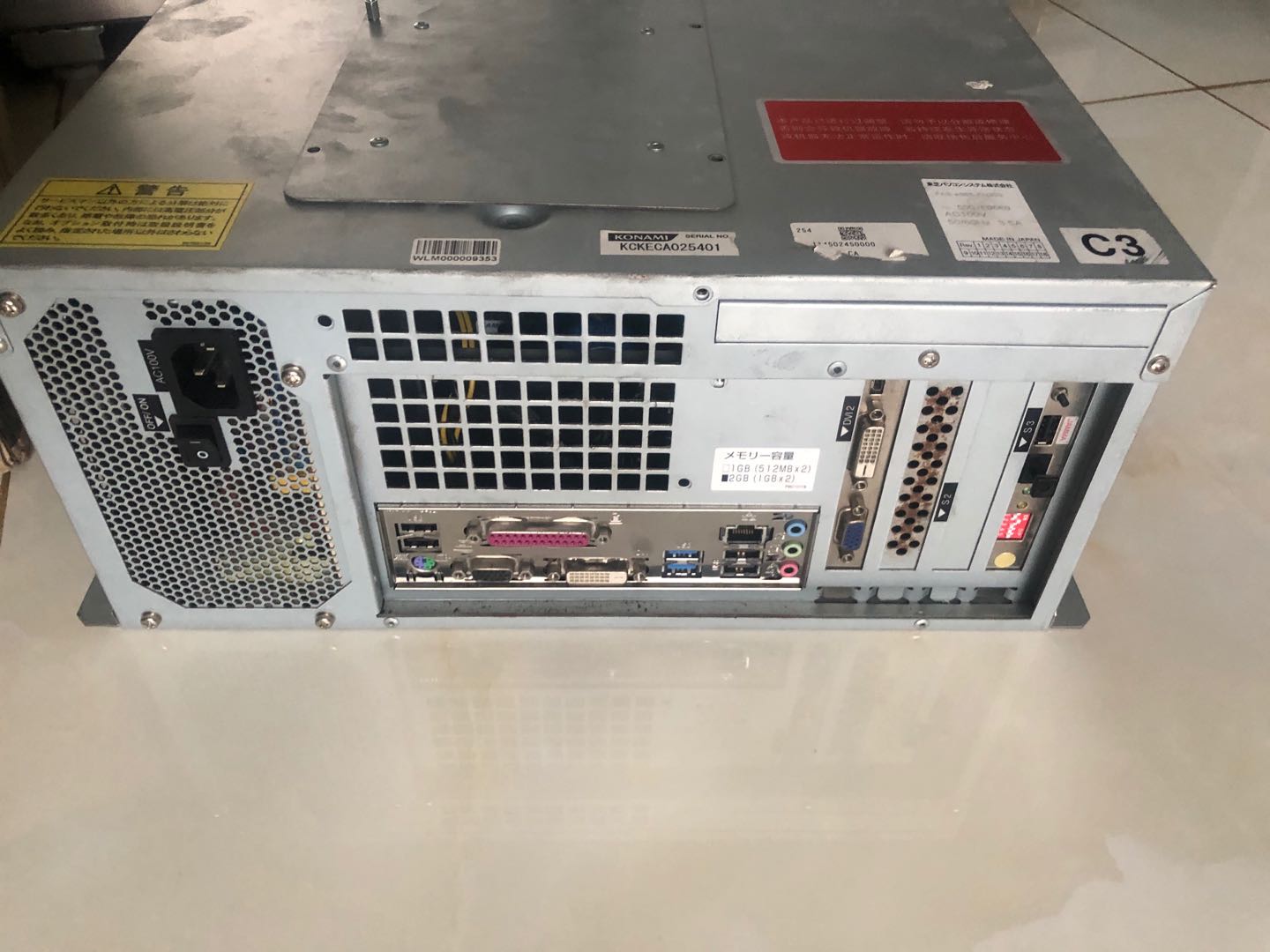

Yes, I can start the game without a simulator, but many games can't work. The IO board is different. I use the IO of TTX to connect with the motherboard to play the game. Some predecessors have pointed me out. I don't want to discuss some "hack" problems, which will bring bad things. There is no manual. Please check the TTX manual and jumper part!

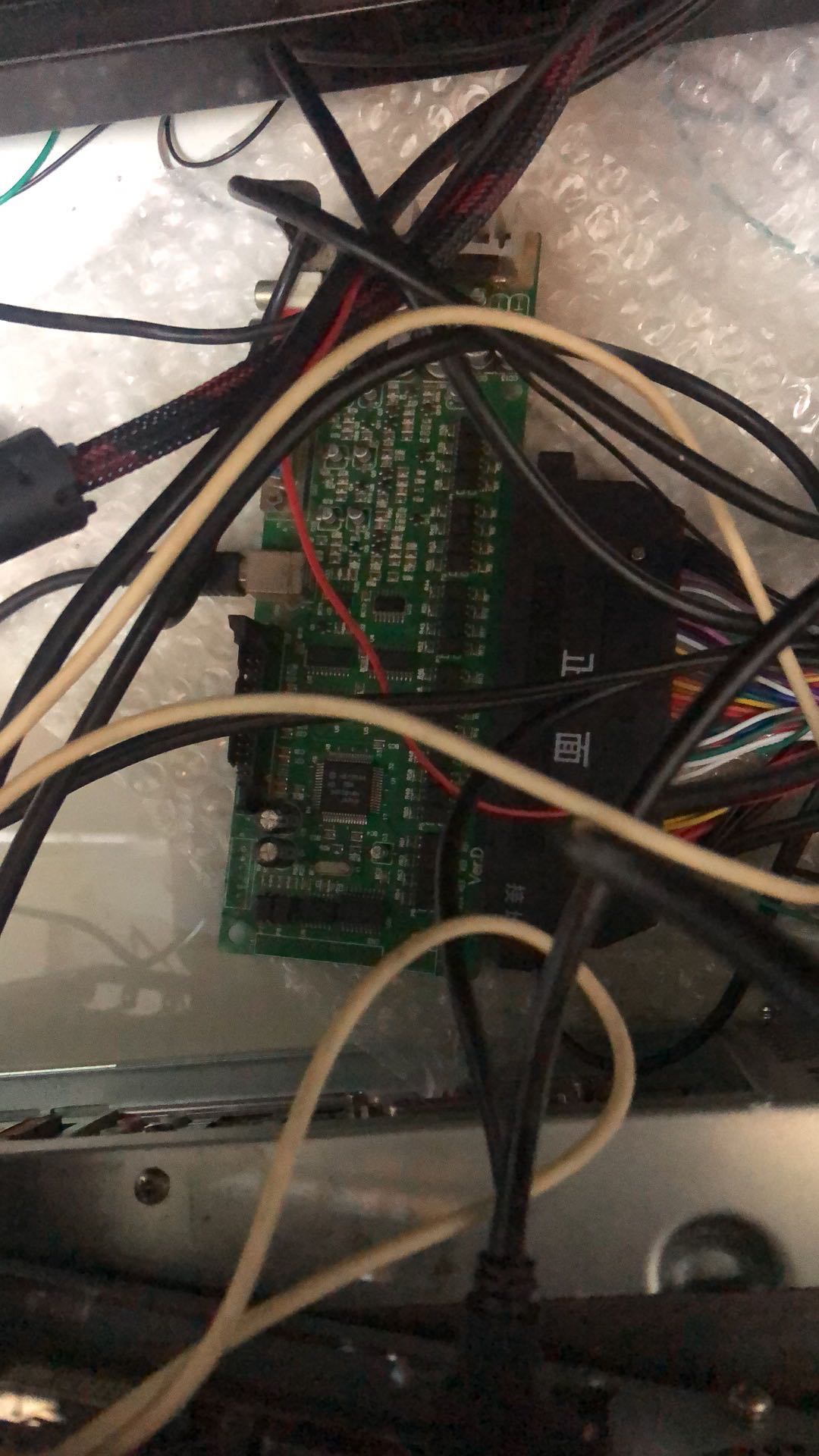

Can i ask what is the compatible i/o board for the tekken 7 fated retribution for es3?

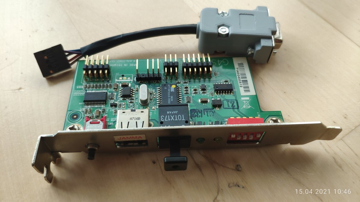

I use also a regular PC with taito fast io board and a adapter to connect com1 to the taito board. so you can put this pc in every sega universal cab with type1/3 io. if somebody needs, i have one more taito board left.
