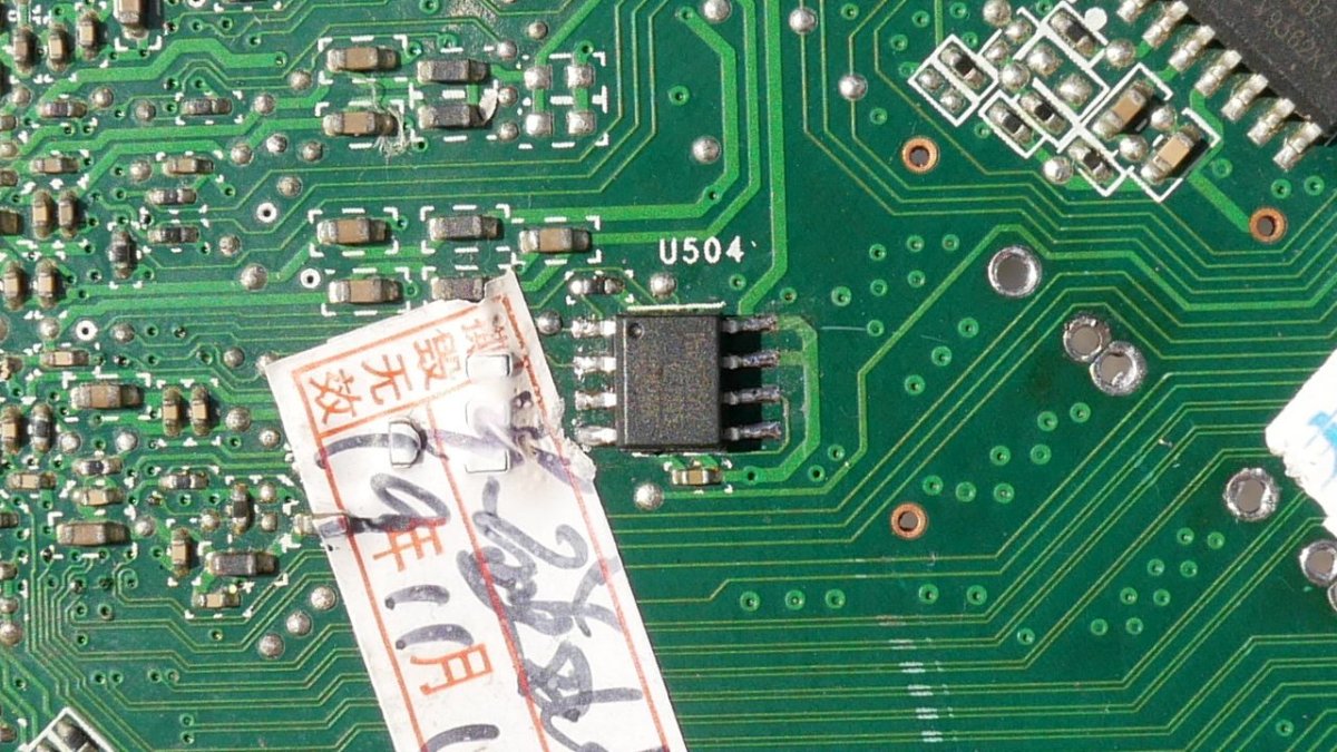

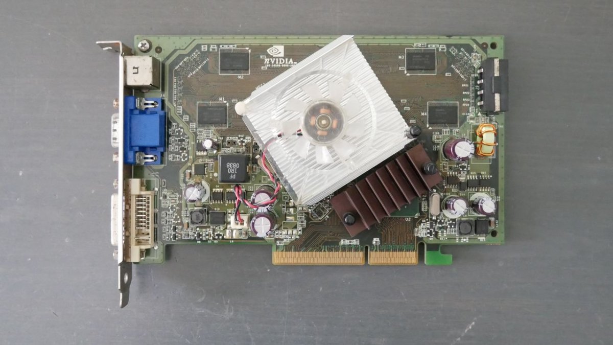

GeForce 7600GS
Bios is stored on U504. Original chip is a PMC PM25LD512.

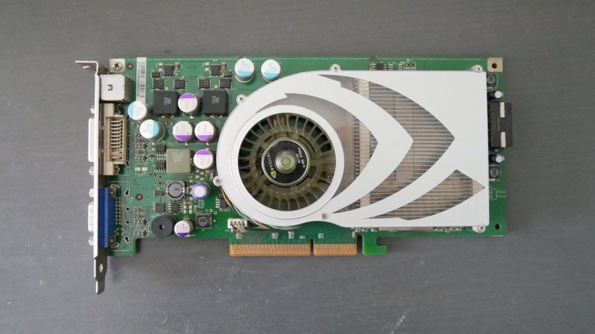

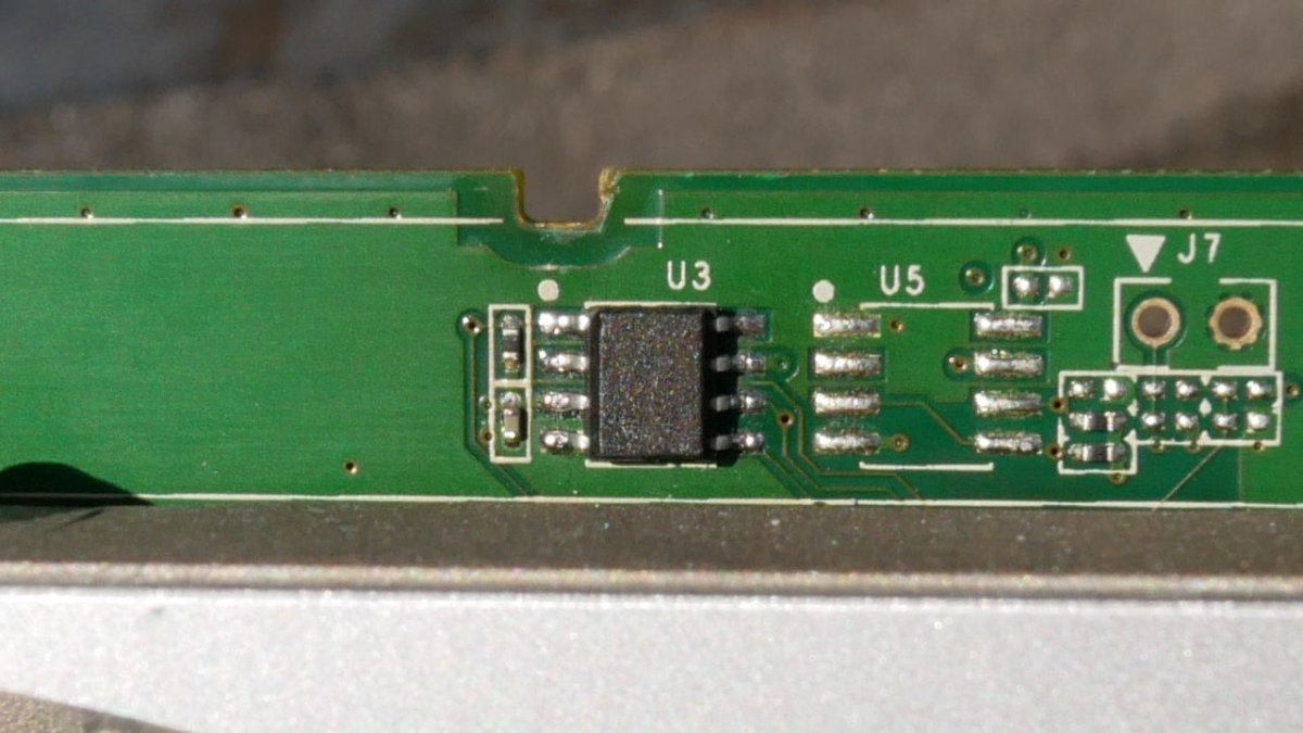

GeForce 7800GS
Bios is stored on U3. Original chip is an Atmel AT25F512AN.
