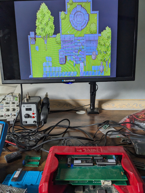

Using this init in the bios is good enough (at least in an emulator) to get every game except Oriental Legend working/launching fine.
