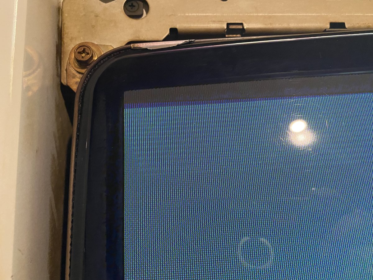

Took my Sega Blast City for service to PNL as it had some brightness and convergence issues. John from PNL ran some tests and noticed the monitor was losing focus and said the flyback and chassis needed to be repaired. He spent the whole day on this. Took it back home only to find out there is now this weird scanlines and black spacing on the top, which fixes itself after a few minutes. This is on 31khz. There’s still convergence issues. Not sure how this happened. Disappointed that I’ll need to haul this monitor back in as I paid over $200 with more issues than solutions.
Anyone know how this could have happened and what I can tell John specifically what to focus on? Thanks in advance.

Looks like retrace lines. Change all the capacitors in the vertical section on the chassis. This usually fixes the problem, but there could be other issues generated after you had it “fixed”.
Some info regarding white/grey retrace lines:
White/gray retrace lines​
Where all colors are involved - the lines are essentially white or gray (or with a slight tint due to slight unequal settings of the color adjustments), look for something common like an incorrectly adjusted screen (G2) or master brightness/background/bias control or a problem in one of these circuits, a defective power supply or a problem in the blanking circuitry:
  • Screen (G2) or master brightness/background/bias control - mark setting and then see if a slight adjustment removes the retrace lines. See the chapter: "Monitor Adjustments". Of course, if this happened suddenly, the problem is not due to a misadjusted control though a dirty pot is possible - turn it back and forth - this might clean it and restore normal operation.
  • Power supply or connection to CRT neck board - insufficient voltage will result in the CRT never totally blanking. Check (usually scan derived) power supply components (from flyback).
  • General power supply - check B+ for correct value and ripple. A main power supply fault might result in these symptoms (and usually many others).
  • Blanking circuit - this may be a part of the video/chroma chip or separate. Check waveforms to determine if the blanking pulses are making it to the video output.
https://www.repairfaq.org/sam/monfaq.htm#monwgrl
Caps for the vertical foldover.

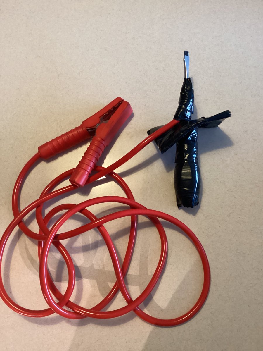

Sounds like you need to take the plunge like the rest of us and learn to discharge a tube (fairly easy and safe as long as you follow the simple steps)
You can build your own discharge tool with a BIG flat head screw driver, thick gauge wire, alligator clips and lots of insulated electrical tape. Literally all you need.
We can make a video for you on discharging if you'd like. Would make it easier for you to mail him your chassis for like $5 or less through pirate ship than lugging a heavy ass tube and losing money taking time off work. Trust me. I used to be petrified handling monitors and did the same once but it's easy just gotta be careful every time and you'll be fine.
It's OK to be afraid as that's what keeps you safe. You'll be very apprehensive for a while but it goes away.
Plus it's a disservice to yourself not learning if you're gonna get into this hobby. It's the equivalent to being a car guy and not knowing how to turn a wrench it just has to happen
I'll be more than happy to walk you through it and can posts videos.
Not all discharges are violent or loud, and removing a chassis once the anode cap is off and discharged is relatively safe. You just want to be careful not to touch caps immediately after discharge but those "shocks" won't kill you, they just smart lol 😆

We tested it and I did see the test signals, but this was after the unit was powered on for a while so I didn’t catch the retrace lines until AFTER I got home. Also, the test signals were a bit blown out and didn’t catch the corners. It was a bit of both exhaustion as Covina/West Covina is such a depressing city to kill time at, and waiting for rush hour traffic to die. Dropped it off at 10:30 am and picked it up at 6:30 pm.

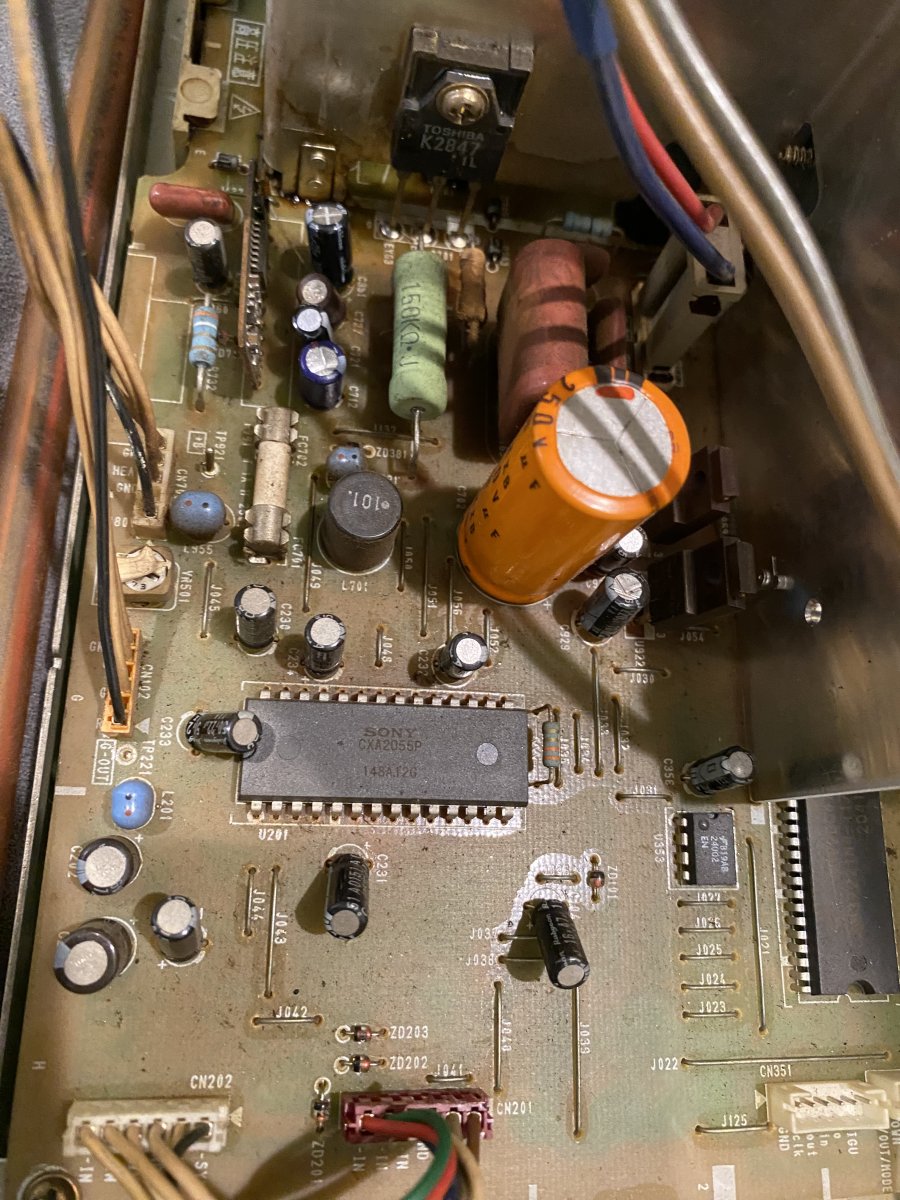

Here are images of the chassis. Hope these help.

Yea, I thought that looked like a 2933. The obvious orange cap is still orange, so that tells you not all caps were done. Still, that's a good chassis.
