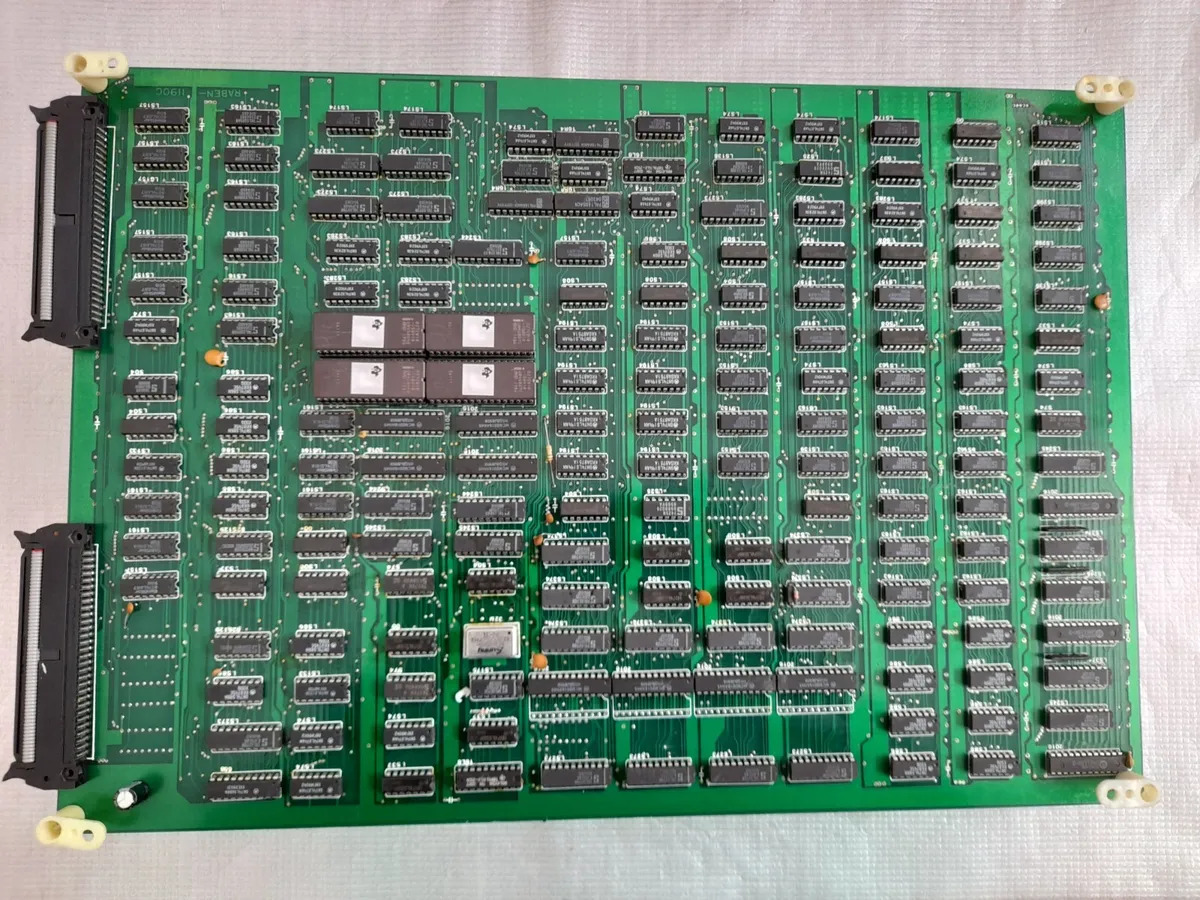

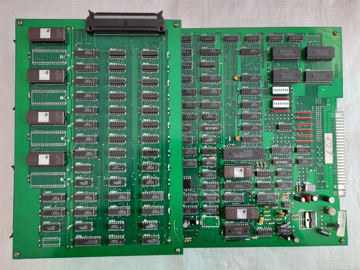

Hello I am new here and hope I selected the right place for my question:
What about the bootleg PCBs of IREM games how do they fit into the picture?
If I understood it right they played a major role in understanding the IREM boards especially the custom chips.
I just bought one of Hammerin' Harry got it for 70€ (+30€ international shipping) not exactly cheap but not bad I think for a supposedly running board.
I attached the pictures from eBay (did not receive it jet).
This board is M84 based to my understanding is that right?
I had a look to the mame ROMs of my board hharryb and hharryu (M84) the main CPU ROMs 2x 128k seem to be different so I tried to exchange this two ROMs in the ZIP file with the ones from the M84 version and run mame from command line to get past the CRC check. And surprisingly the game started (only played 1-2 min). Would that mean the bootleg runs with the original ROM set?
This is my first Arcade PCB so I just started with that. And I am sorry if I asked questions that are already answered multiple times please give me a pointer where.
I have seen pictures of a board that looks like mine but modded to run R-Type II that is actually what I want to do with this board mod it to run R-Type II ROMs.
I have seen there is a project in progress by @Hammy M84 Conversions.
How high is the chance that this conversion roms will run as well? And if not what would be need to make them work.
I am aware the layout is completely different but starting form schematics I should be able to create a PCB layout that fits to the different ROM socket location.
I found the schematics of the M72 but not for M84 or my bootleg board, does anyone have them and is willing to share?
Thank you very much.
Please ignore my bad spelling and bad grammar I am from Germany and tried to write this without the help of translation tools.

Bootlegs are a completely different beast all-together. I'd say they don't fit into the picture because they're in a completely different picture. Some bootlegs are near exact copies of the original, others have substantial changes, and more are somewhere in-between. Also this varies from bootleg to bootleg. Some original hardware might have 5 or 10 different bootleg boards that vary from near identical copies to being nearly completely different hardware.
it's entirely possible, but you're on the right path to understanding how to make a conversion work.
I'd recommend once you have the board in hand to dump the ROMs and see if they do indeed match the bootlegs set in MAME (your board could be a completely different bootleg board) From there you can also look at the MAME driver and try to understand the hardware differences between the original and the bootleg, and try to understand what is different about the ROM data and why they modified the ROMs (see if you can identify differences in the bytes, and then flag those regions in MAME to see when that section of code is run)
Hammy is certainly the best person to answer this question :)

There is no guide, not all bootlegs are the same. when you get the board, please dump the program roms, and also fit the missing rom sockets on the top board.
Also verify the board is FULLY working before we start. (test the flipscreen dip switch!!!....)
When you are setup let me know!
I will write a guide, and anyone who has donated like you did can get a copy :)

I will dump the EPROMs and replace them with Flash or EEPROM so it is easy for testing.
This PCB is my first Arcade board.
I prefer the bootleg over the original because it does not have custom chips and some of the week points like the breaking resistor arrays.
I was hoping it is close enough to the IREM to run the original unmodified Hammerin' Harry M84 ROMs.
I tested that on mame and it seems to be fine.
I am fascinated how this PCBs are able to produce this kind of graphics and sounds with some 74 series TTL chips and a 8MHz 8086 CPU (V30) while PCs of that time 1987-1990 just changed from EGA to VGA. And the graphics are more colorful than the Amiga graphics.
For me it is far more interesting to learn how a conversion is done than to play the game.
It is good to know you have many arcade boards and if I need something specific I will ask you first.
I do have some equipment (TL866 II, 2 channel USB scope and 16 channel USB logic analyzer, soldering equipment and Multimeter) so I am able to do some repairs and I can read schematics. But what I am missing are working reference boards for testing suspect chips and I also don't have a chiptester.
Sadly, this bootleg has errors but it's about 95% ok.

I just compiled what I found.
I can not create schematics before I get that board. Adjusting the memory map should be fairly easy I guess it is using a PAL or GAL that needs to be exchanged/reprogrammed.
For my bootleg as far as I have seen two EPROM sockets are to short so the stuck out 4 pins need to be connected if I did not miss something one on each side, one address line and 5V.
Proper schematics would be very helpful to compare things.
Not in m84's case, but it is for the others ;)
Yes, you will also need to fit full size sockets
Anyway address decoding is not rocket science if you understand how it works you can make things fit quite easy. And if M84 does not use a GAL what is holding me back to add one to generate the chip selects. Changing DRAM size is problematic but SRAM or EPROM is usually not that bad. A custom ROM (top) board as used for some of the multi game mods can make things a lot easier. I am not scared of unsoldering a couple of chips and put sockets in, in wich you can either plug some replacement circuit with custom PCB or the original chips.
To get back to the comparison the M8x boards should be able to run any M72 game when the requirement of the MCU is removed. But the M72 Boards are missing features that M8x use. Is that so far correct?
