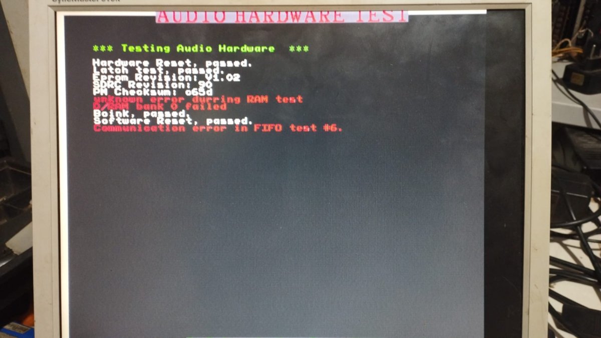

Time to send it in for repair.This PCB is very complex and delicate, I have a feeling it will get worse if I replace memories at random.
I got the board schematic.
But if anyone has more information about the error codes, I would appreciate it if you shared it.
that sounds more like the CPU isn't running. check to see that your U95 sound rom is good, cause the CPU can't run without code. ie. if the label fell off the rom then that's definitely cause for concern with some bits getting flipped.
It's gotten better but it's still not good.
the sound works until you press start.
I have no idea who it is, D/RAM Bank 0, I have memories of a scrap PCB to replace if I find out who it is.
