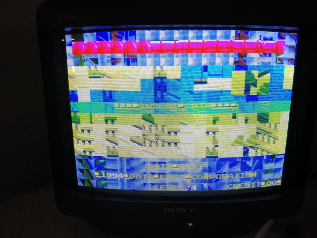

@tom5151 you have seen these problems only on KOF98? no other games?
I've got the green screen with wjammers just 1 time. But it was after a "non reboot" story, so I think the game was not correctly flashed.
As said I've tried 5 or 6 games and it looks like kof98 is for the right moment is the only game I can not play.
I've tried cyber lip for 2 hours ans it was perfect :thumbsup:
