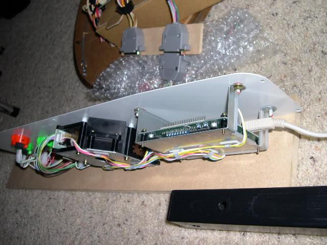

I haven't had a chance to try either of those yet but Outtrigger requires a rotary encoder board for the trackball (it uses 1 track ball and 1 trigger stick like virtual on). you will either need a stand alone track ball I/O or you can chain a type 2 I/O in rotary encoder mode off of a type1/2/3 primary I/O board. (I believe Dynamic Golf is similar).

Would be interested to see how to wire up a trackball to the I/O. Or even the rev 2 method you mentioned.
Normally you need a 837-13938 "JVS Trackball I/O" this has a JVS port like a normal I/O board but it does nothing other than interface with trackballs so you need to chain it off of a Type 1 or other I/O. Normally these are bolted directly under the panel in a candy cab setup (picture of a Golf panel below).
I believe as long as you have one of these you can use Happ or any other typical track ball. The Sega Type 2 I/O can be made to look like one of these by flipping one of the dip switches, but the game only accept it if it's on I/O node 2 (which is kind of dumb since it has all of the other I/O requirements)
Normally you need a 837-13938 "JVS Trackball I/O" this has a JVS port like a normal I/O board but it does nothing other than interface with trackballs so you need to chain it off of a Type 1 or other I/O. Normally these are bolted directly under the panel in a candy cab setup (picture of a Golf panel below).I believe as long as you have one of these you can use Happ or any other typical track ball. The Sega Type 2 I/O can be made to look like one of these by flipping one of the dip switches, but the game only accept it if it's on I/O node 2 (which is kind of dumb since it has all of the other I/O requirements)
I think I have one of those PCBs on a golf panel. Anyone need it?
