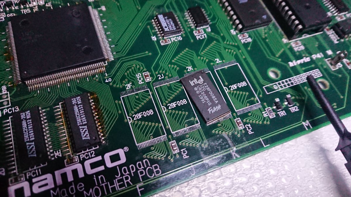

i recently aquired a tekken 2 pcb with a sticker saying its a "TES2 - VER D" i tried to check the Program ROMs (2L, 2J, 2K, 2F)
i dumped 2L and used romident website and nothing was found about it !
now i am confused, i don't know if the rom i found is corrupt or if its undumped rom
the board says its a TES2 VER.D and i found no such version !?
any help will be appreciated

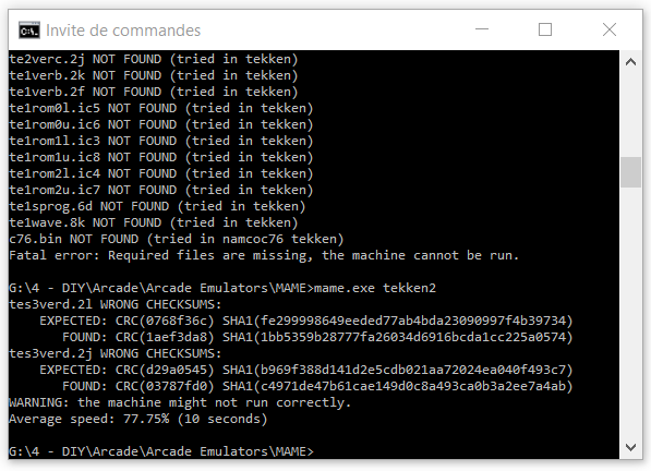

using the command prompt as PlatynumX suggested i could launch tekken2 with 2L, 2J undumped program roms
i dumped 2F, 2K and they are actually the same as tes3.verD.
so 2L,2J are undumped Tes2,VerD and 2F, 2K are (tes3.verD) on the board i have.

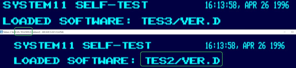

If you are running this in MAME what is the version shown in the setup screen ?
I can get these submitted to MAME if you share a picture of your setup screen from the main game and share the 4 ROMs.
here are the checksums when i run mame from command line (pic 1)
the setup screen (pic 2) shows same as you tes2.verD
below are the two roms 2J, 2L that are different as i dumped them
2F i cannot check it in romident (give it a try) which for some reasons gives a server error 500 (!!!) BUT it works fine on mame
2K is identified as TES3.VER.D

the funny part is that i bought this pcb for 5$ as it was trashed
cpu pins were missing, all cpu board caps were torn apart nothing come up when fired up
i started probing around i got an XGECU programmer to try and read the flash ics as i suspected a missing bios in 2J, 2L
i was almost ready to clear those two flash chips when i realized that i couldnt find tes2.verD on mame !
so i posted suspecting undumped roms
and here we go another set of roms saved from oblivion

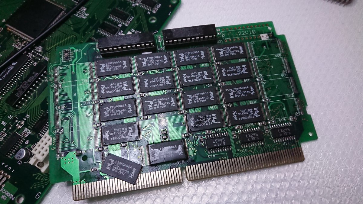

btw i saw that you are into ST-V i found this cartridge (the pcb only)
when i dumped one of the flashes i says Sega ST-V die hard see the pics, is this a multi-cartridge or what exactly ?!
Yeah I am a big fan of ST-V :D
That looks like a standard bootleg cartridge. Very fun game though.
