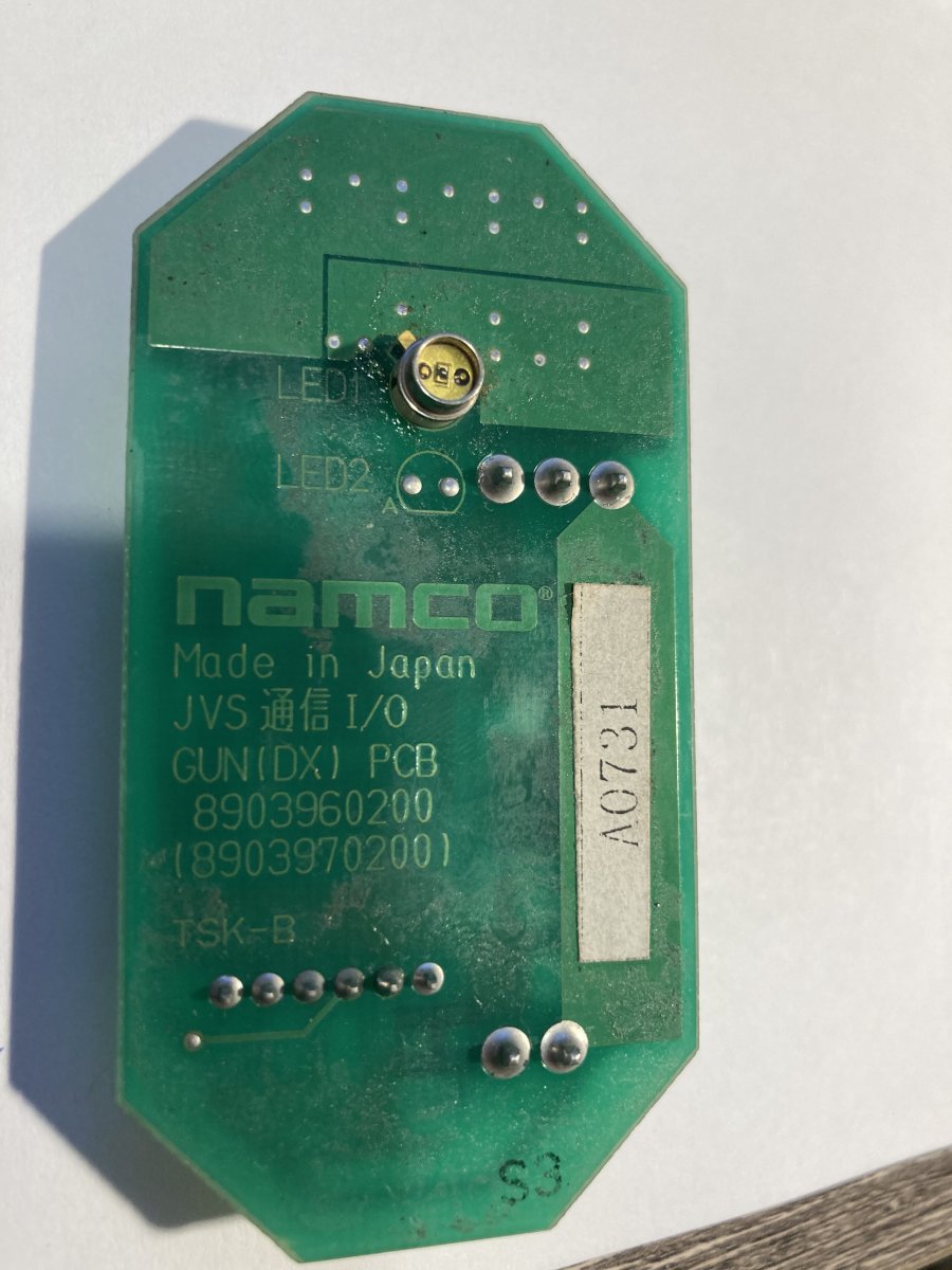

in case I need a new ir emitter what is a good replecement for the original gun pcb?
This is how the PCB looks like (I don't have a spare for sale)
But I have schematics somewhere, if you want it.
Can be reproduced pretty easily, except I don't known where to get that bi-metal temperature protection switch SW1
Or if you mean RAYS pcb, it is harder to get, but it pops up on eBay time to time

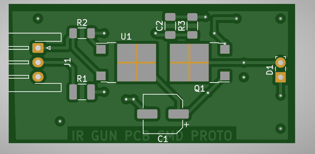

Hi everyone, just a bit of an update to this long old project of mine. Well, I have decided to go ahead and open source my reversed engineered IR gun pcb pcb for all of you to replace/repair your cabs or play with the original hardware you may already have. I will upload my KAD pcb designs when I find them and I hope I still do but it does have some issues. It’s functional but isn’t perfect. It doesn’t fit in a gun case properly as I didn’t have the exact measurements and some parts can be replaced with better alternatives, especially the IR LED emitter. If you guys are more pcb design proficient, you can absolutely improve on my design. Like I said, hopefully I still have the files and I’ll upload them here soon. I call this project finished for now :)
One thing I forgot to mention, I’ll also try to recompile my parts list as well, it’s been quite a while so I don’t really remember what I used lol and I also hope to see @lukemorse1 make some Vampire Night gameplay on his channel ;)
Here are the Gerber files for the IR pcb. the mockup of how it looks is on the bottom. hope you guys can improve upon it. this is my first pcb I have designed, so it looks extremely rough lol.
  • Gerbers.rar
