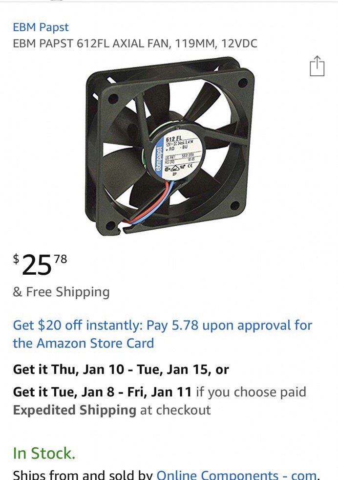

Is this a reasonable price for that fan?, seems like $25 is alot for a fan?
@yuro @Aurich
Question does it come with the connections already or soldering is required?
I honestly don't remember, I put it in a few years ago, but I know it was easy and painless whatever I did.
If I remember correctly, the new fan had 3 pins/wires, but the connector still fit the original male pins on the A board with no problem, and no modification. It's plug and play. You'll see when you get it.

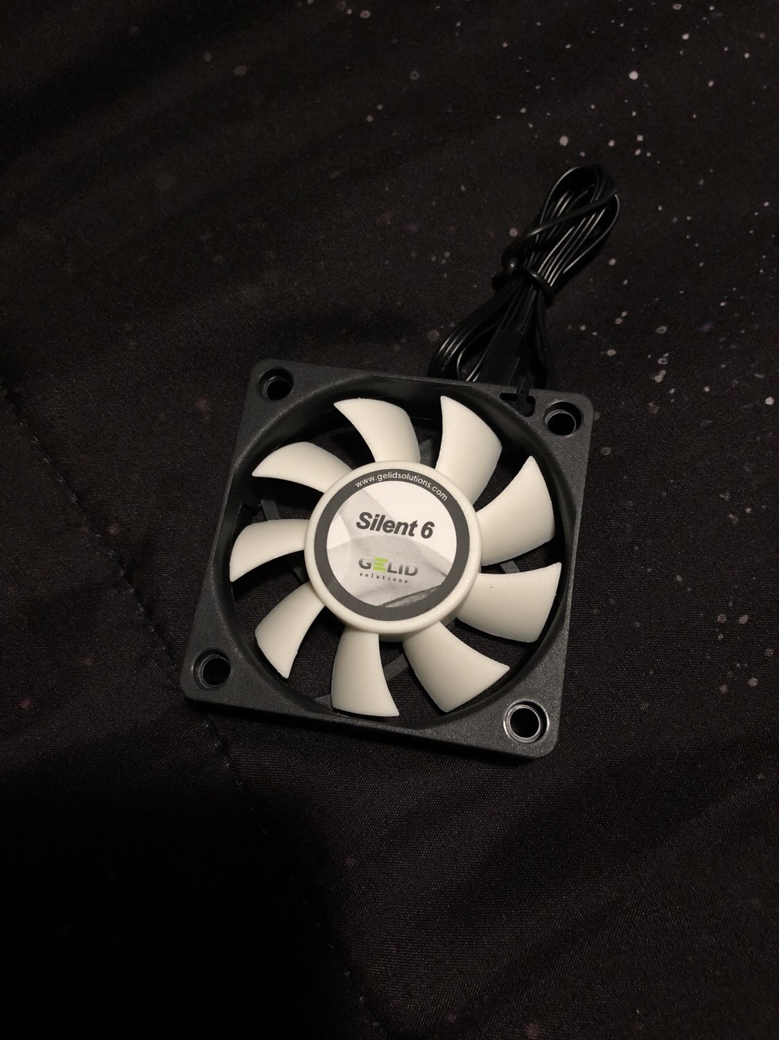

Finally!!
