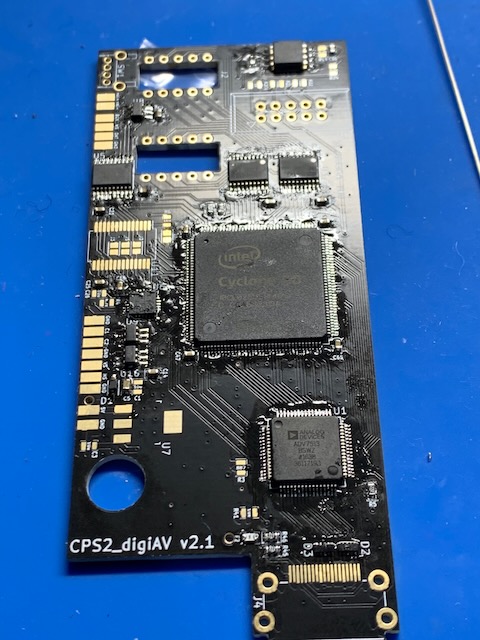

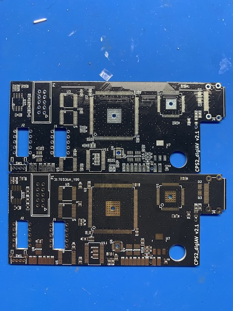

Slightly related pic of a bare CPS2 digiAV board for attention

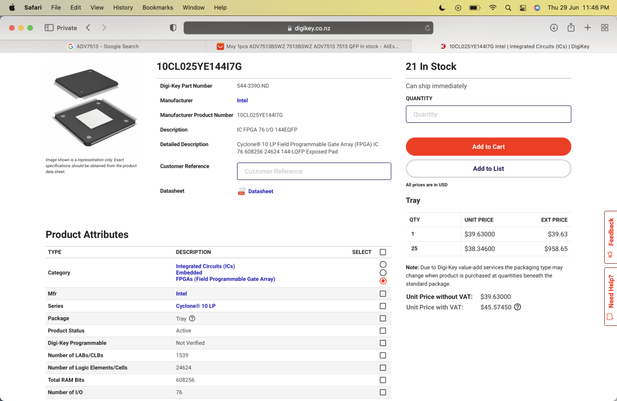

Smoke 'em if you got 'em lads. There are 5 less now than there were 2 minutes ago :)
This part (10CL025YE144I7G) is the over-spec and more expensive version of the BOM part (10CL025YE144C8N) - apparently rated for higher temp range and industrial applications but probably just the same chip sold at a higher price :)
Anyhoo, if you want one, now would be the time.

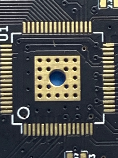

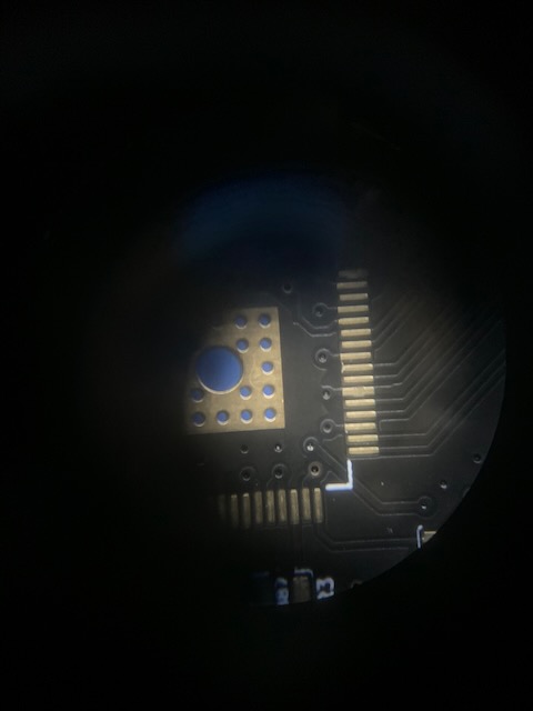

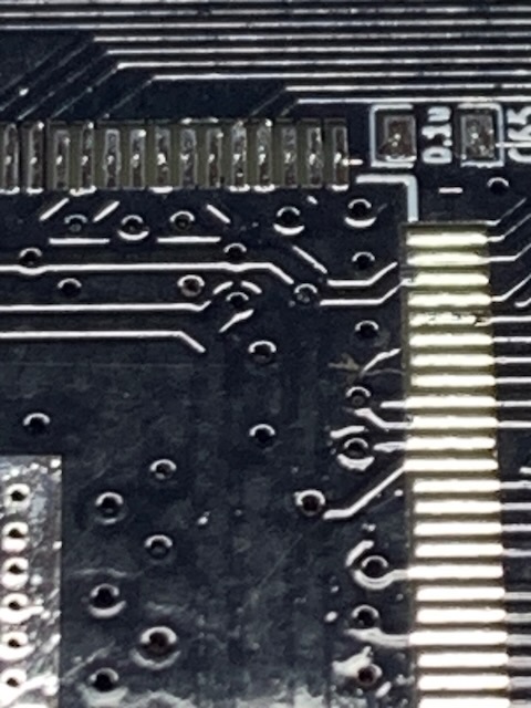

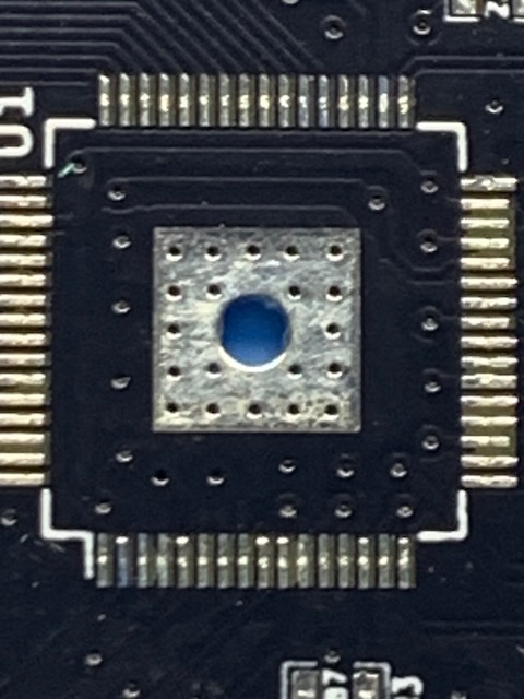

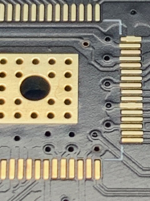

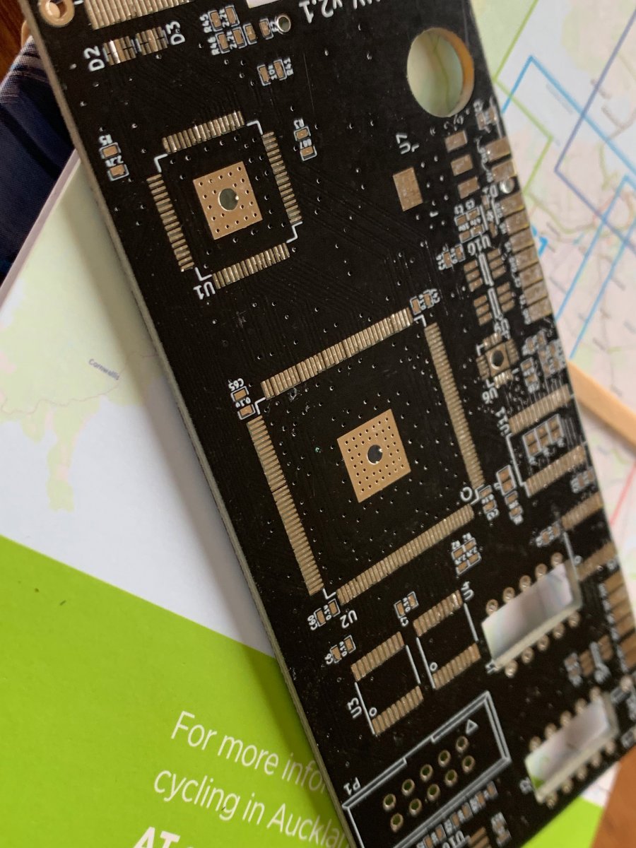

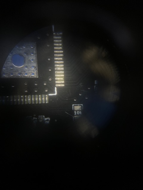

ENIG vs HASL, is it worth paying 500% more for?
Normally I would say no, HASL is perfectly lovely, easy to solder and makes a really nice joint even with average tools and technique.
But for this specific use case the answer is yes. The difference in surface finish of ENIG is absolutely superb by comparison.
ENIG is like a visitor from another dimension - The mask transforms in to the pads and back into the mask seamlessly, the tolerances are invisible even under a microscope, the pads are centred in the mask because the pads ARE the mask, its one single perfect surface made of different materials. The components glide across the surface.
HASL the pads are like little islands, the mask is clearly painted on afterwards and for teeny .5mm pitch pins it looks like a dogs breakfast under the microscope. The pads aren't centred in the mask, the surface level is all over the show, and the mask is missing in some areas, applied inconsistently in others. HASL boards have clearly been "made". It feels like I need to balance the component on the pad, sometimes they fall off the side into the gap between the pad and the mask
So in situations like this - soldering irreplaceable components with bajillions of tiny legs - Yes ENIG is good value.

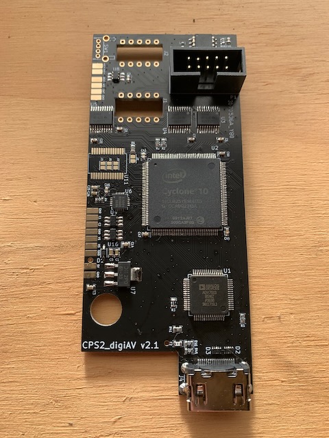

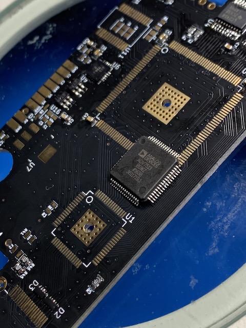

This was about 3 hours work to nearly finish the front side. I thought the clock generator was hard. Then I discovered the clamping diodes. Looks messy from all the flux, but it's actually pretty OK.
My buddy and I are gonna take the FPGAs from our older DC digitals. We replaced those with the new version HW2.

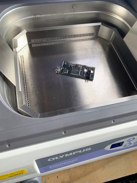

Finished!
Quick dip in the ultrasonic cleaner, minty clean and ready to install.

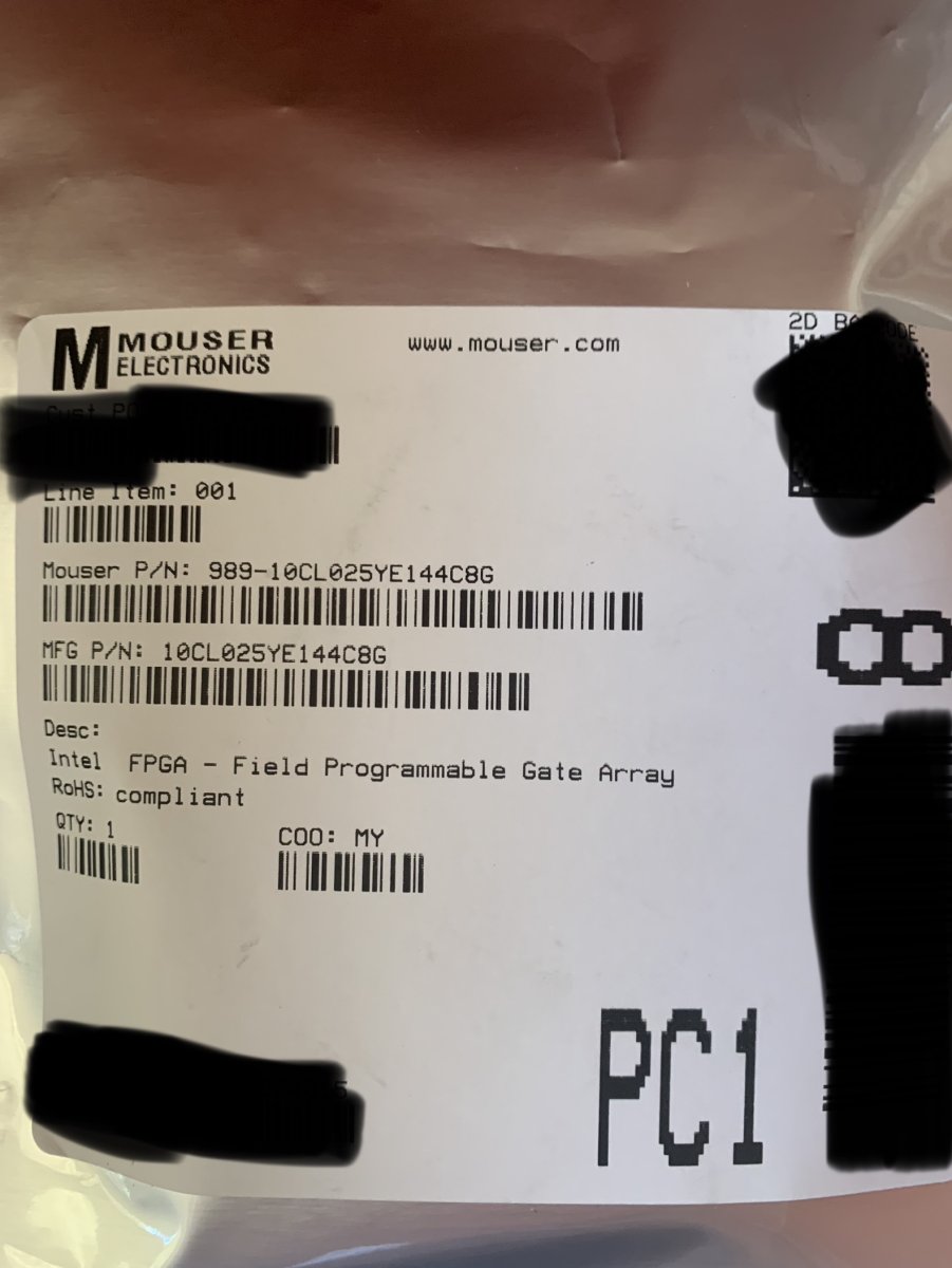

Here it is, the much-coveted cyclone 10 FPGA hot off the interwebs at mouser.
