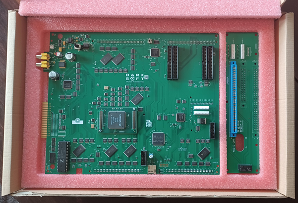

Finally you are starting to receive your CPS1/CPS1.5 Multi. It's been amost 2 years of development, basically because we never could see the end of it, we always wanted to add something more, make it even better, and it was being extended and extended. Now is finally out and we hope it meets your expectations.
In this thread and specially in this 1st post, we will post firmware updates, if needed or improve the documentation or help people troubleshoot their multi if they have any troubles.
We can finally provide you with some basic instructions. You can get them from below.

I got my multi set up.
games flash fine but no video or audio output. Just black screen.
I followed the manual.
A board is 89626A-4.
I am using 92641C-1 C board. I replaced the PAL with the one provided.
I have the switch on top of the multi set to ON.
I have the reset and qsound wires hooked up correctly.
I have tried 2 different C boards. They were both on conversion boards and the conversion has been reversed.
Traces were cut so I soldered a jumper wire from pins 45 and 46 to pin 40.
I thought I was buying an unmolested C board but it actually still had the traces cut, but no bridge wire.
Any suggestions?
Maybe that is two separate thoughts, but the way that reads is that you replaced the pal on the C board. The pal actually goes in the A board. Just making sure
Otherwise the C pins should go to ground, I don’t think 40 is ground is it? I used a negative from where the battery was
I replaced the wrong PAL. I did replace the one in the C board.
I replaced the correct PAL and everything is great. Thank you very much!!!!!!!!!
I'd put more exclamation points, but I don't think anyone would appreciate 5 or so pages of just exclamation points.
I'll never get those 3 hours of my life back, but at least it's resolved. And somebody had to get the ball rolling in here.
I corrected my initial post to reflect what I actually did.
I regards to ground - Pin 40 is ground, so is 41. So is whatever pin is diagonally across from them. Pin 47 might be ground too. But Idk.
I am also using the negative battery spot now too. It's nice and beefy. I like it.
Thanks again.
