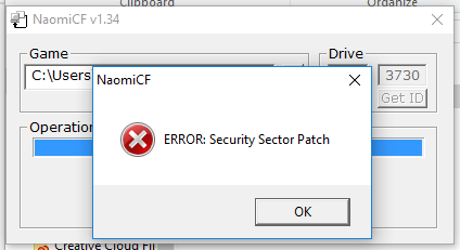

Hi all,
Trying to create some CF cards but keep getting this error "ERROR: Security Sector Patch"
I am using an IDE machine to get the code and a USB CF reader to copy the files.
I have successfully made cards before but I seem to be stuck with these new cards =(
These are the 512 CF cards I bought: http://www.ebay.com/itm/LOT-TOPRAM-...hash=item4d34b726bf:m:mratDUt302OL4_LNvR4CH0g
Am I just out of luck with these cards? I have tried 5 of them all with the same issue.
Any help is greatly appreciated!
Never head of those card working. Cisco cards and other name brand cards are more reliable. Although, one user reported issues with Cisco cards. Transcend cards are black listed too.
See if you can repeat the process with your known working cards. And if it does work, then you know it is the card and will have to start from scratch. If your known good card also don't work, you might have a shot to troubleshoot further. We can also add these to the blacklist once you confirm the outcome. Sorry bud. Let us know how it goes.

Got the cards to write without the error on a Windows XP machine with the USB CF reader "was trying to use a Windows 10 machine before". Unfortunately I get an error while trying to launch "Error 26 Option Board Malfunctioning" =(
Sucks! I have used these cards before and have about 15 games on them, I guess something must have changed in the manufacturing process?

I used my IDE CF card reader and NaomiCF to get the security code (surprised th CF to SD adapter had this) the code was "2020"
But, my IDE CF card reader didnt want to flash using naomiCF. "Error: security sector patch" So i used my usb CF reader to flash with instead since i had the security code. Many CF cards suffer from this as well, but usually this is the workaround :)
