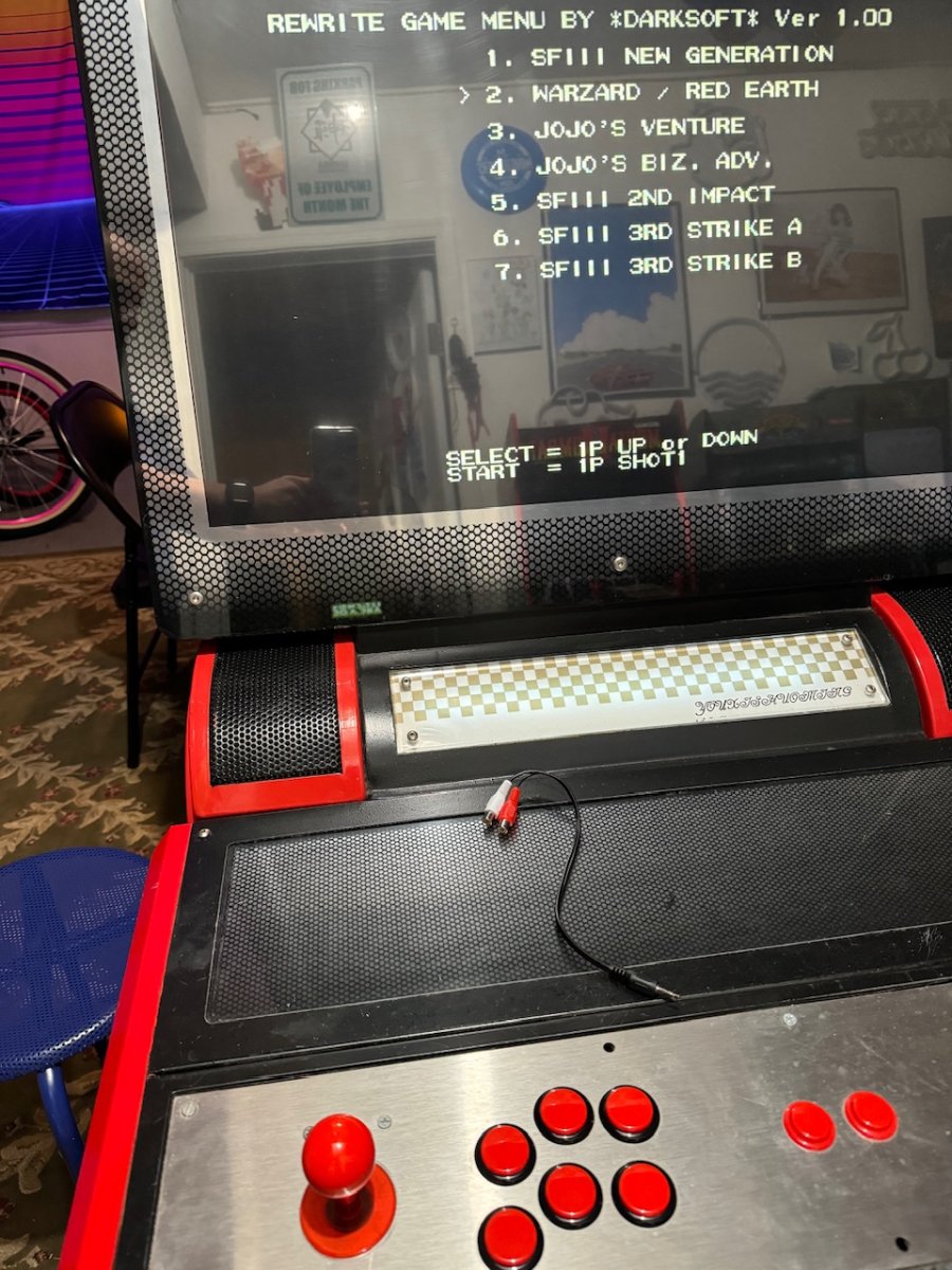

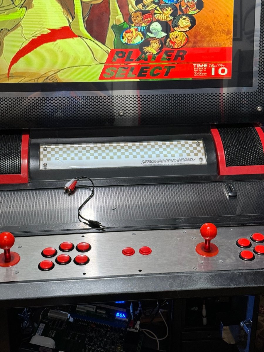

Hey friends hoping to find some assistance for help with the Zulu SCSi. I am trying to ditch using the cd-rom drive with my cps3 multi setup from years ago and performed the following steps:
  • Formatted SD card fat32
  • Downloaded uniCD-CPS3_for_standard_SH2 from cps3 help section
  • Tried to use balena etcher and Rufus I get a warning message that it’s not a bootable partition before I proceed so switched to using win32
  • Used win32 to write the iso to SD successfully
  • Connect the Zulu to cps3 boots but says invalid cd rom drive
Thank you for any help

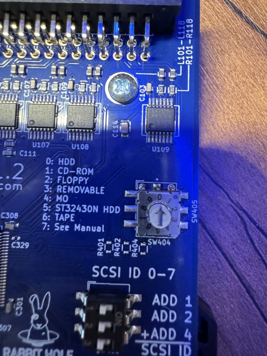

The ZuluSCSI v1.2 has a knob to switch it to CD-rom without using a utility I believe here is a pic
Keep it set on CD.

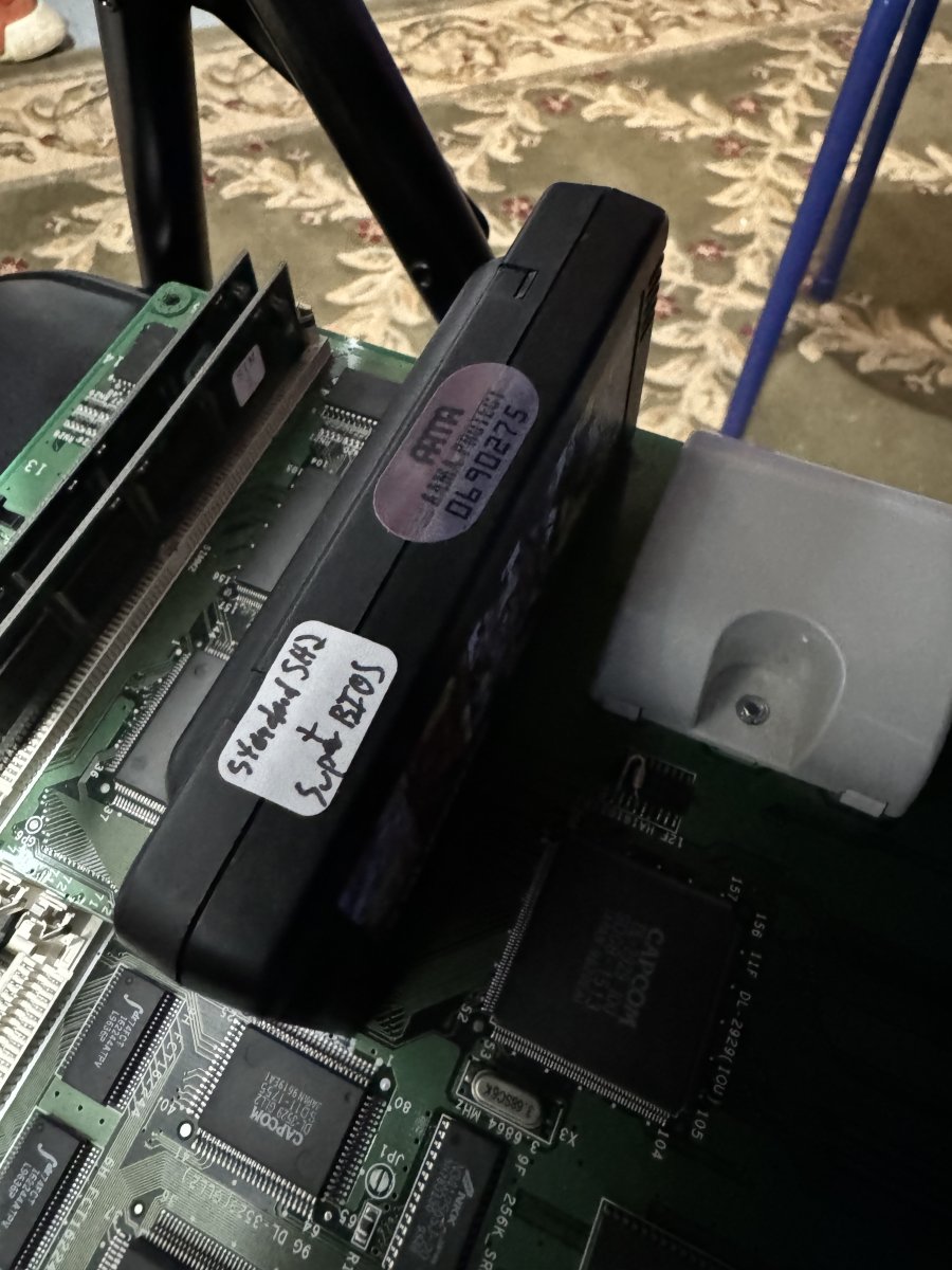

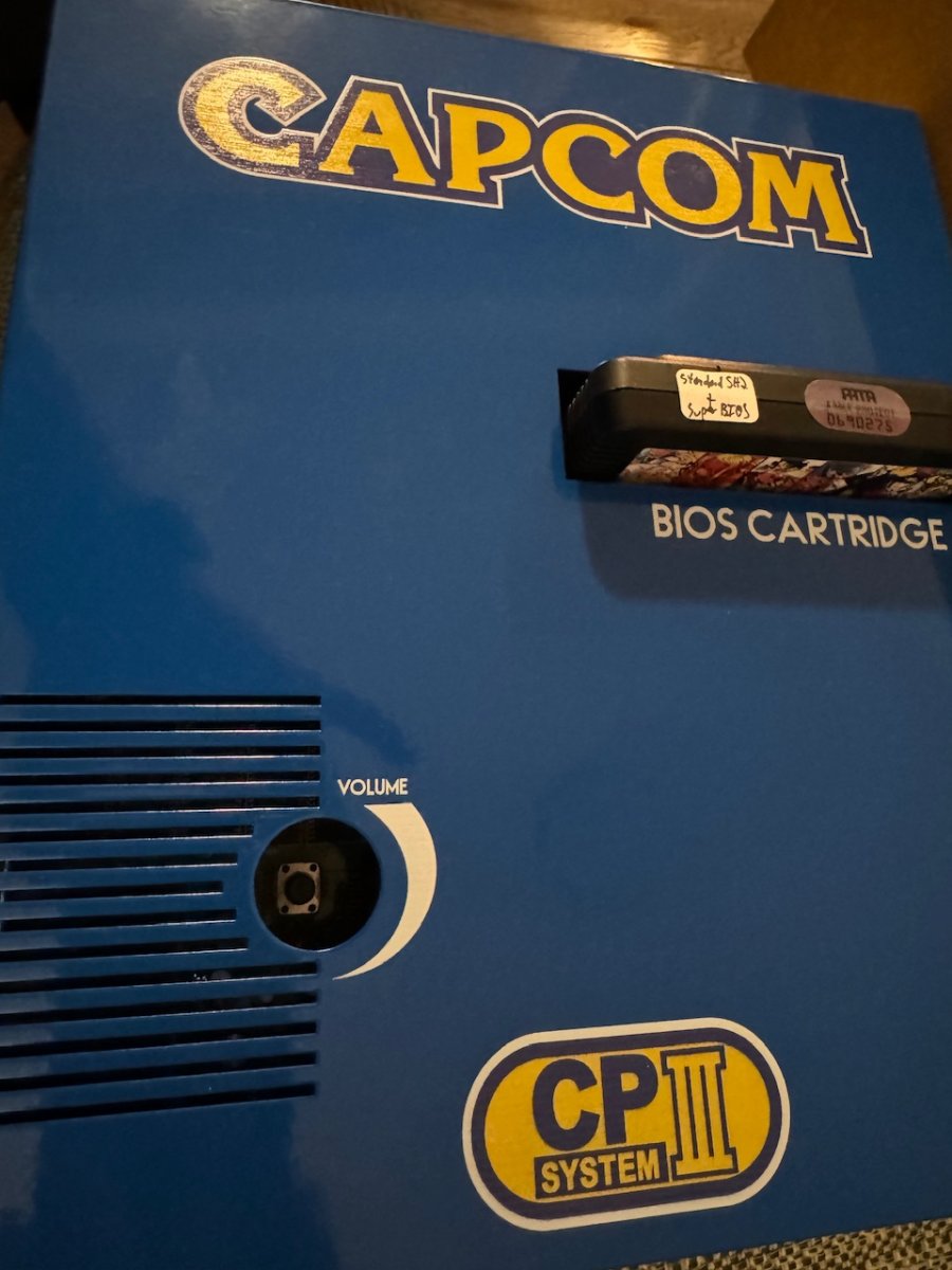

Interesting so how do I know which exact iso to be certain? I know my setup is Super Bios Standard SH2 so I used the uniCD-CPS3_for_standard_SH2 listed in Darksofts file section
That's the correct iso.
Format your card to FAT32, drop the iso to the root of the card and try again. If it still doesn't work, try renaming the iso to "CD10_2048-CPS3SH2.iso" and see if that works.

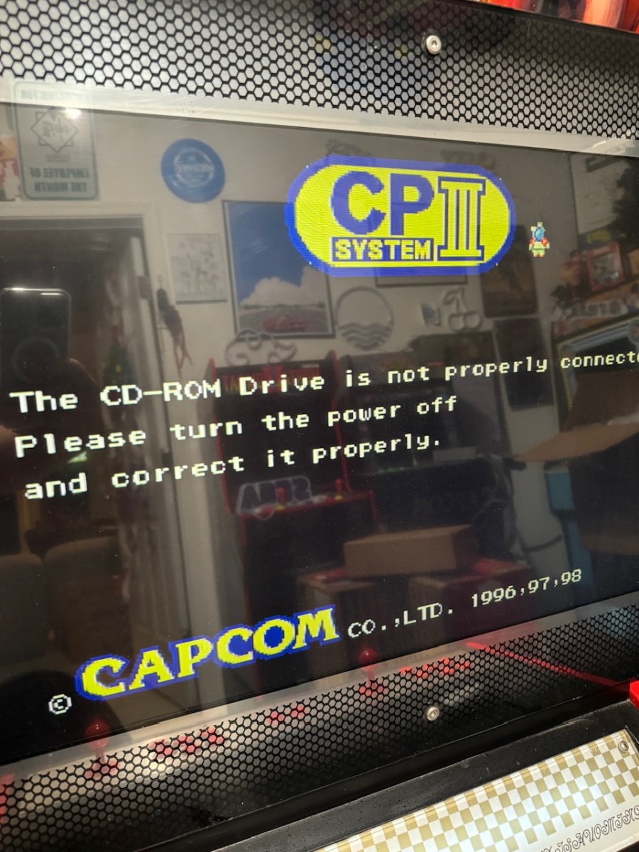

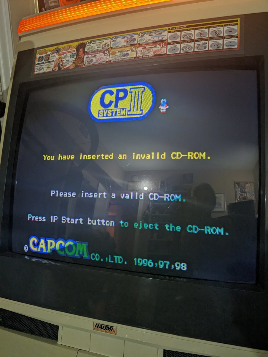

ok did exactly this and renamed it dropped in the root now I’m getting the CD-rom drive is not properly connected?
Try these settings, rename the ISO file to CD1.iso and give it a go.
If it doesn't work, try switching dip #2 ON on the 4 dip switch on the left and try again.
make sure that the SD card was FAT32 or exFAT formated and that you copied the iso file over, not tried to BURN the image to the SD card.

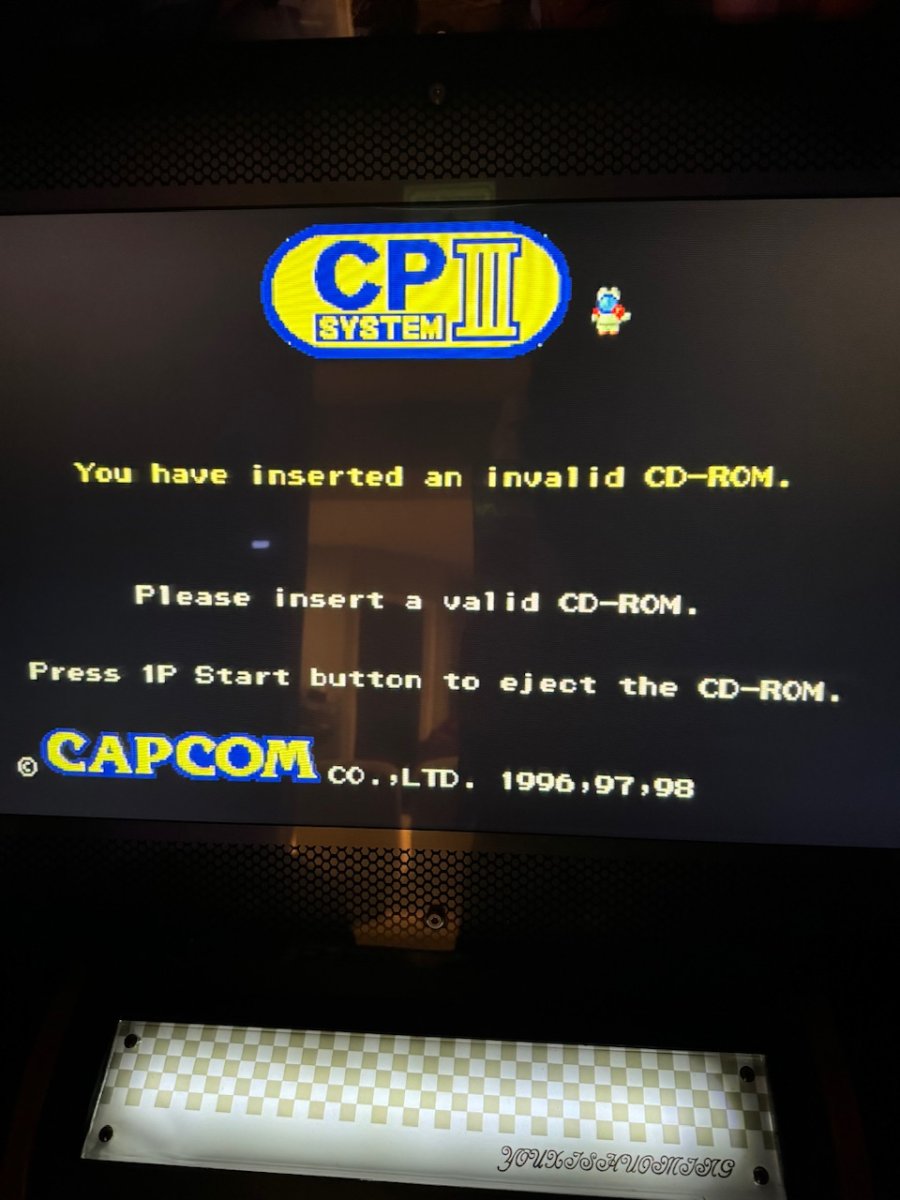

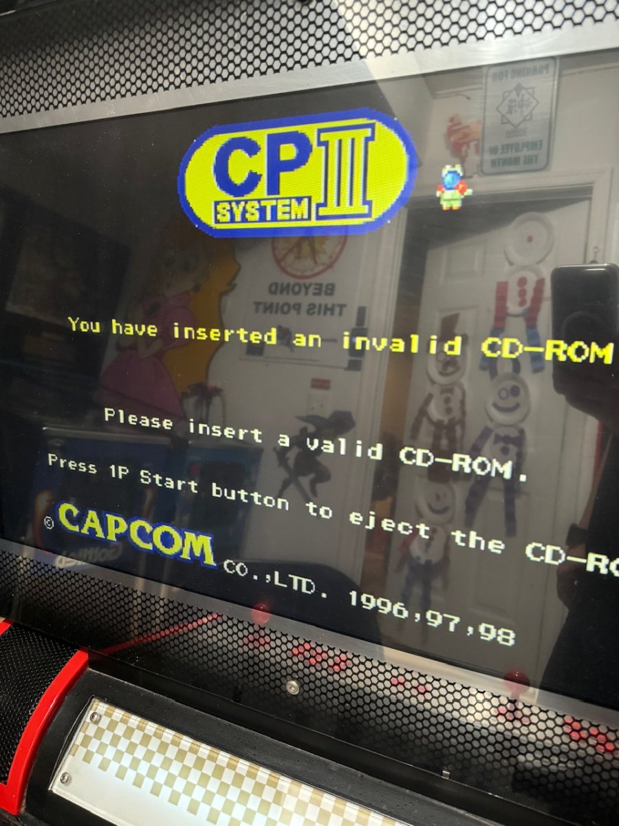

Ok getting closer I think I really appreciate the dip settings you sent now it says I have inserted and invalid CD-ROM…maybe my naming convention needs to be what Em suggested originally not sure what to try next thanks
About the image, I have to disagree with @nem, but off the top of my head, I think that you have to write the image to the microSD, as if you were cloning it.
Thankfully (well, at least arguably thankfully) that method is as gone as the orginal SCSI2SD. Both ZuluSCSI and BlueSCSI devices use FAT32/EXFAT cards, and the file names of the disk images determine attributes like SCSI ID.
Hello thanks for the added context would you happen to know for my specific config which is Super Bios Standard SH2 setup should be called? Please and thank you
Have you updated the firmware for the ZuluSCSI card? Attached is the updated firmware file for your card. Unzip it and copy the bin file to your sd card. Power up the ZuluSCSI and let it do its thing. It will delete the bin file on its own.
Try changing the name of the iso to "CD10_2048-CPS3SH2.iso" as Nem suggested and/or try CD1.iso as well and lets see what happens. Good luck.

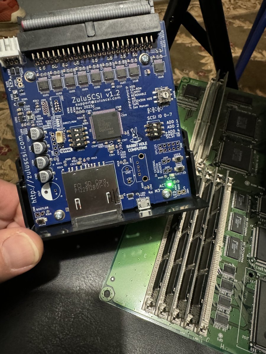

My GOODNESS that did it thank you sooooooo much I used CD1.iso, updated firmware, and made sure the dips were set to what you mapped out plus dip 2 on the left side was switched to on. Thank you thank you thannkkkk you…also thanks to everyone else for bumping my thread

Hi y'all, sorry to boost an old thread but I need some help...!
I've followed every step here and cannot get past the invalid CD-ROM screen..
I bought a Zulu from Rabbit Hole this week.
Formatted to Fat 32.
Used the most recent and the old firmware that Derick2k linked above.
Tried both the custom and standard iso with both the standard file name and the CD1 file name.
Dip switches are the same as Derick2k's (i've tried switching #2 on the left side as well).
I'm just simply dragging the iso onto the SD card (i've tried a regular SD card that Rabbit Hole sent and a microSD -> SD adapter)
I really don't know what i'm missing.
I'm doing this for a friend, I'm unsure if he has the standard or custom bios (he doesn't have a cd driveof his own, but we've used other people's drives successfully in the past (and I don't have the bits to open the security cart, but the cart is a Jojo's Venture cart)), but i've tried both with no success.
Whenever I power the setup on, the Zulu does blink it's like a few times before turning solid, if that's any indication of anything? But i'm assuming that's a normal power cycle.
I feel like i'm grasping at straws but idk what else to try!
