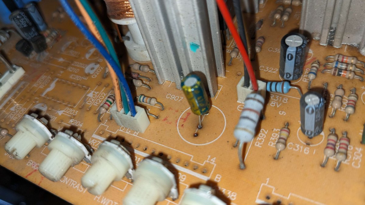

First things first, with the help of some folks in the monitor support thread, I got the picture fixed on the chassis with a judicious replacement of a capacitor controlling the horizontal width.

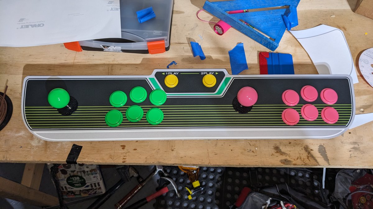

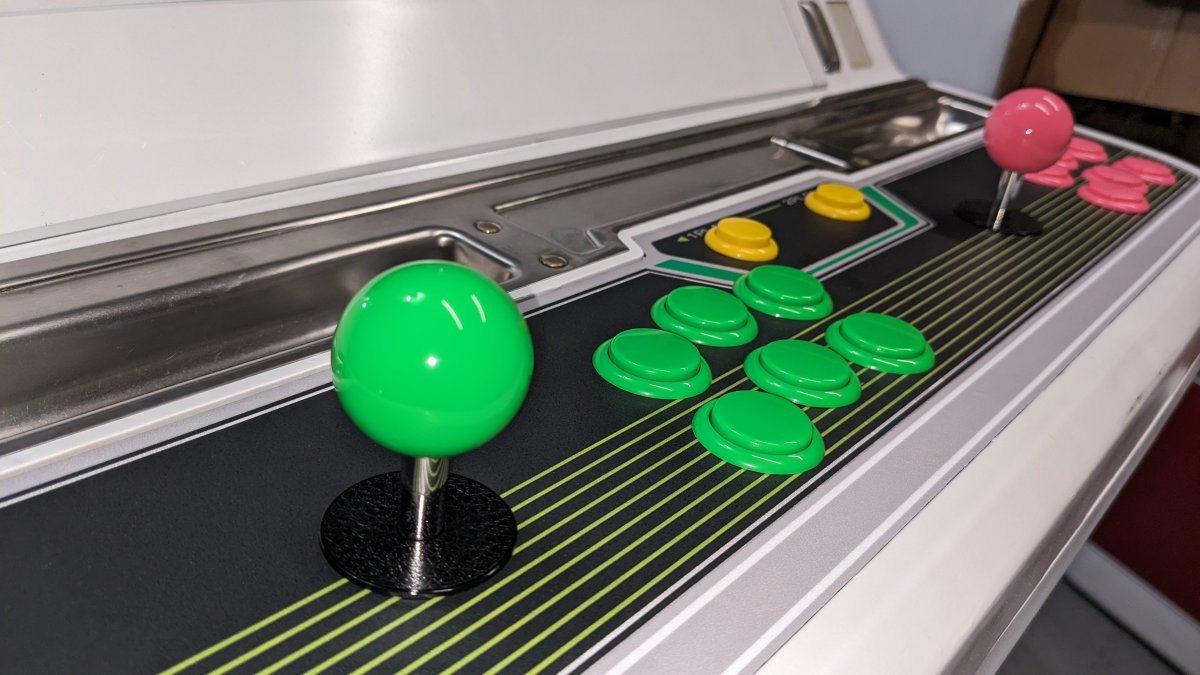

Control Panel - I ordered a replacement CPO from https://arcadeartrepro.com/product/weche-ok-baby-cpo/ and I can say that I am happy with the delivered product. I will say be prepared to wait awhile, it took about 2 weeks before my order processed. However, shipping was great and it even came with a little card thing to smooth the CPO. I believe this is a small shop and customer support was great when I reached out.
After a nervewracking 15 minutes I had the overlay on, with a pretty good alignment.

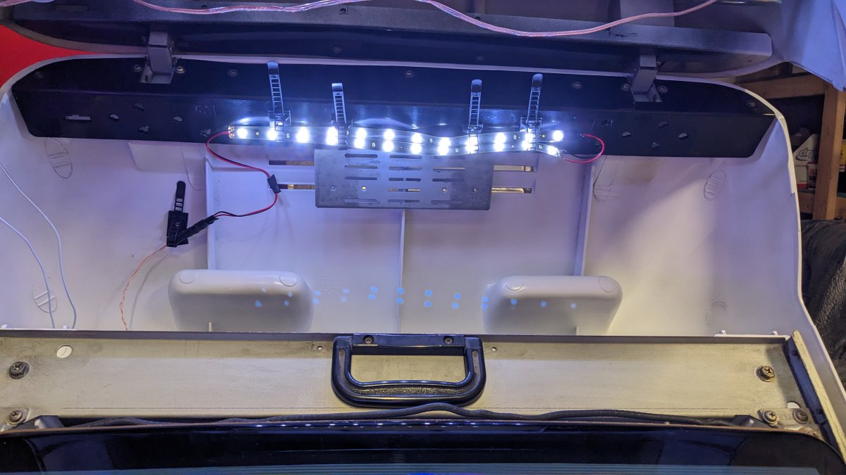

I added a Noctua fan to the cab for some air flow and replaced the marquee light with a couple of led strips from amazon. They run on 12v so I was able to use power from the jamma loom I bought to hook it all in.

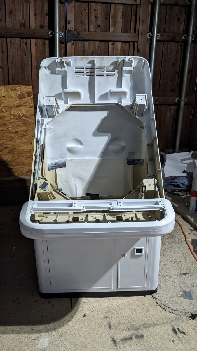

At this point I was/am still terrified of breaking anymore of the plastic on this machine so I took an approach of limited risk. I partially dissassembled the unit and only sanded the worst spots to get off gunk or smooth down gouges that I felt I could do safely.
(sanding revealing the hidden inner beauty of this cab)

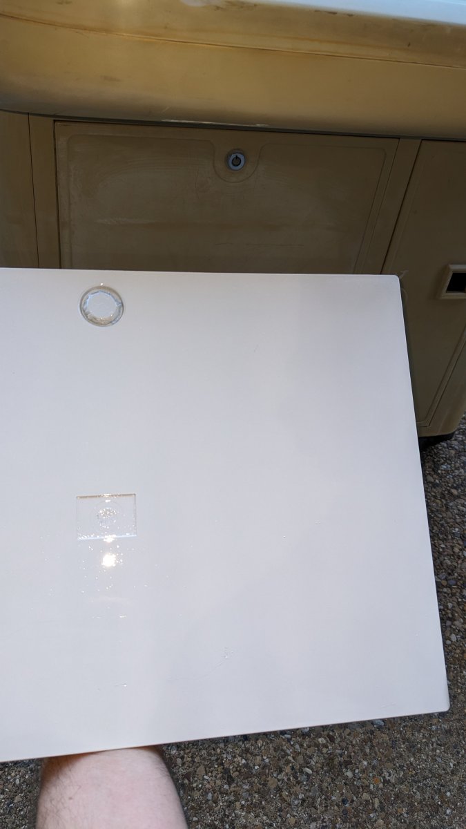

I mentioned before that I had found videos claiming this spray paint did not require sanding. I did a test on the front panel to see how it looked.
Satisfied with this I removed the top/front of the cab, the side rubbers? and then taped up the rest before painting.
Tape removed:
