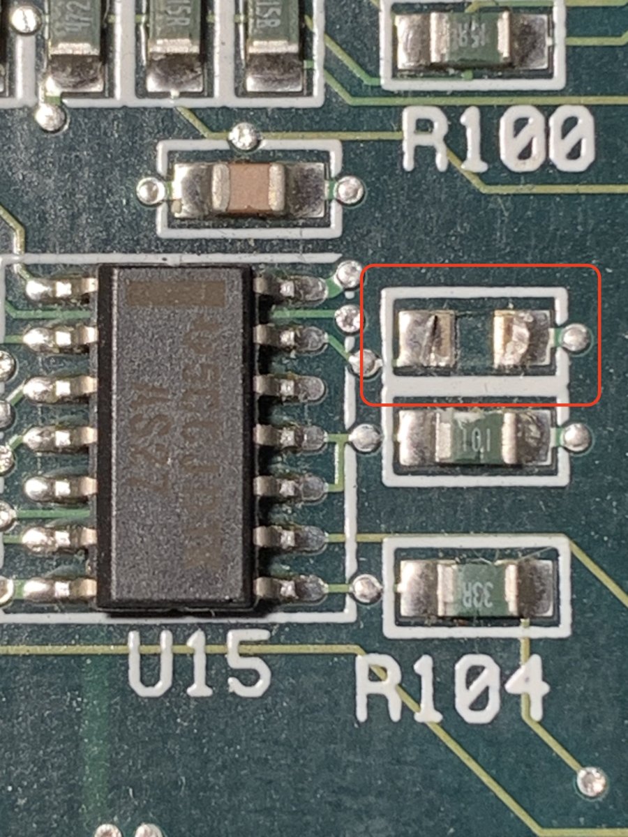

I recently bought a non working wargods board, after probing around the board i was able to determine the custom ICs are working but the processor (TMS320C31) is not executing the first instruction.
I traced the issue back to the RDY# line not being triggered.
While searching which component is responsible to trigger the RDY# line of the CPU, i found around U15 that one resistor have been ripped off the board.
Can someone with a working board take a picture of this resistor or tell me the value written on it ?
Maybe @kinooshi823 or @ekorz ?
Thanks
