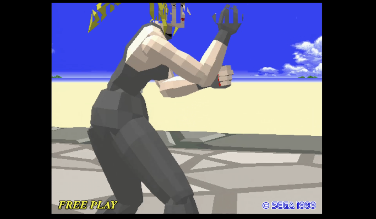

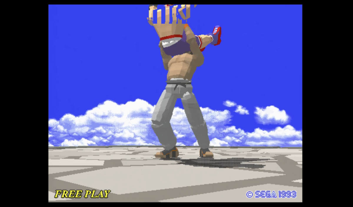

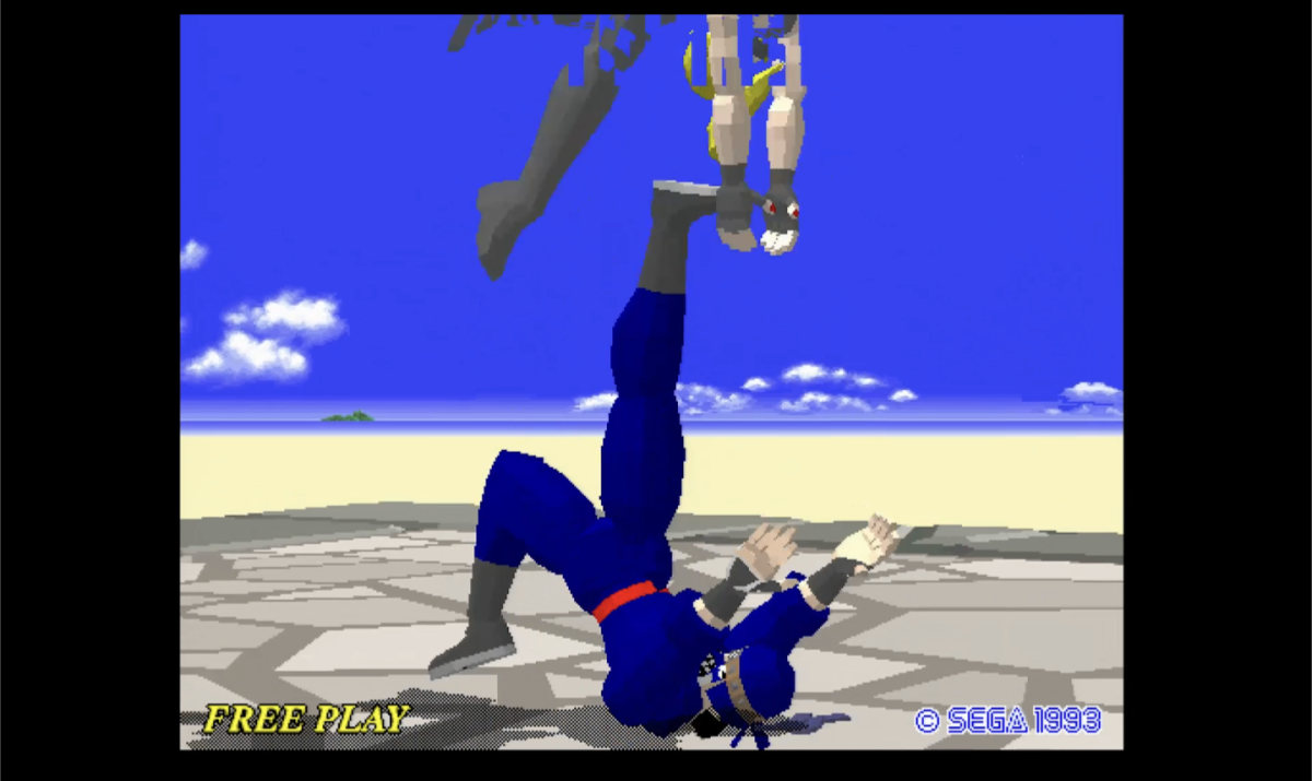

Hi folks,
I have a sega model 1 Virtua Fighter PCB that's developed a fault recently. I've attached pics to demonstrate. As you can see it only affects the top portion of the screen, and only when polygons appear there. My memory test and TGP tests come back fine, and the board is working perfectly apart from this. I've tried using contact cleaner and reseating all the boards etc, even switching out the power supply for a high end Mean well unit, but it's still there unfortunately. Does anything obvious stand out to anyone?
Any help would be much appreciated.
Cheers,
Sam (Retro Muel)

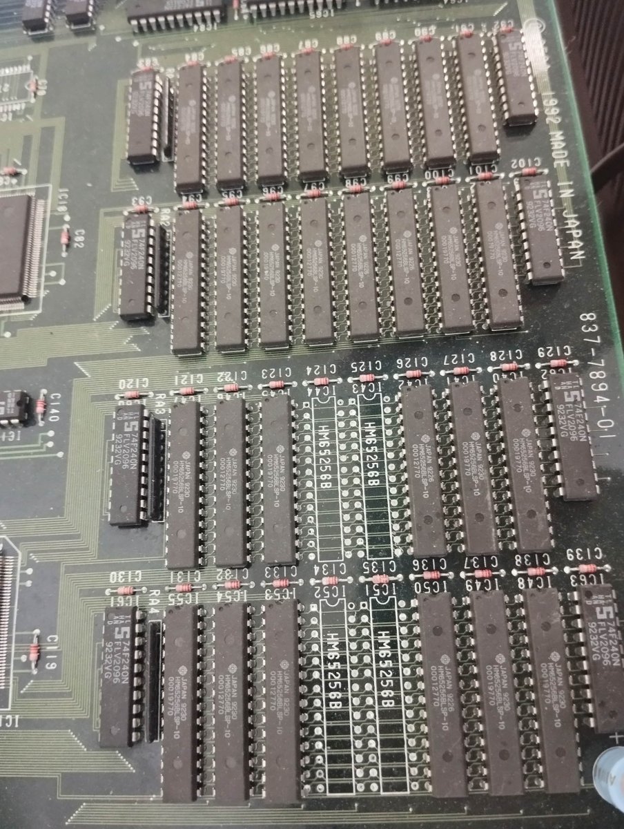

Model 1 video board has a huge amount of 'HM65256' memory for frame buffer. When one or several of these memories die, the above symptoms occur.
Or, one of the 74F240Ns controlling HM65256 may be broken.
