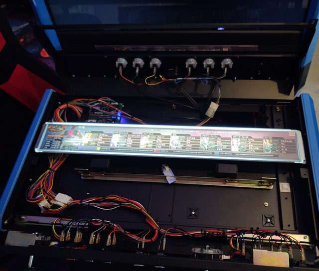

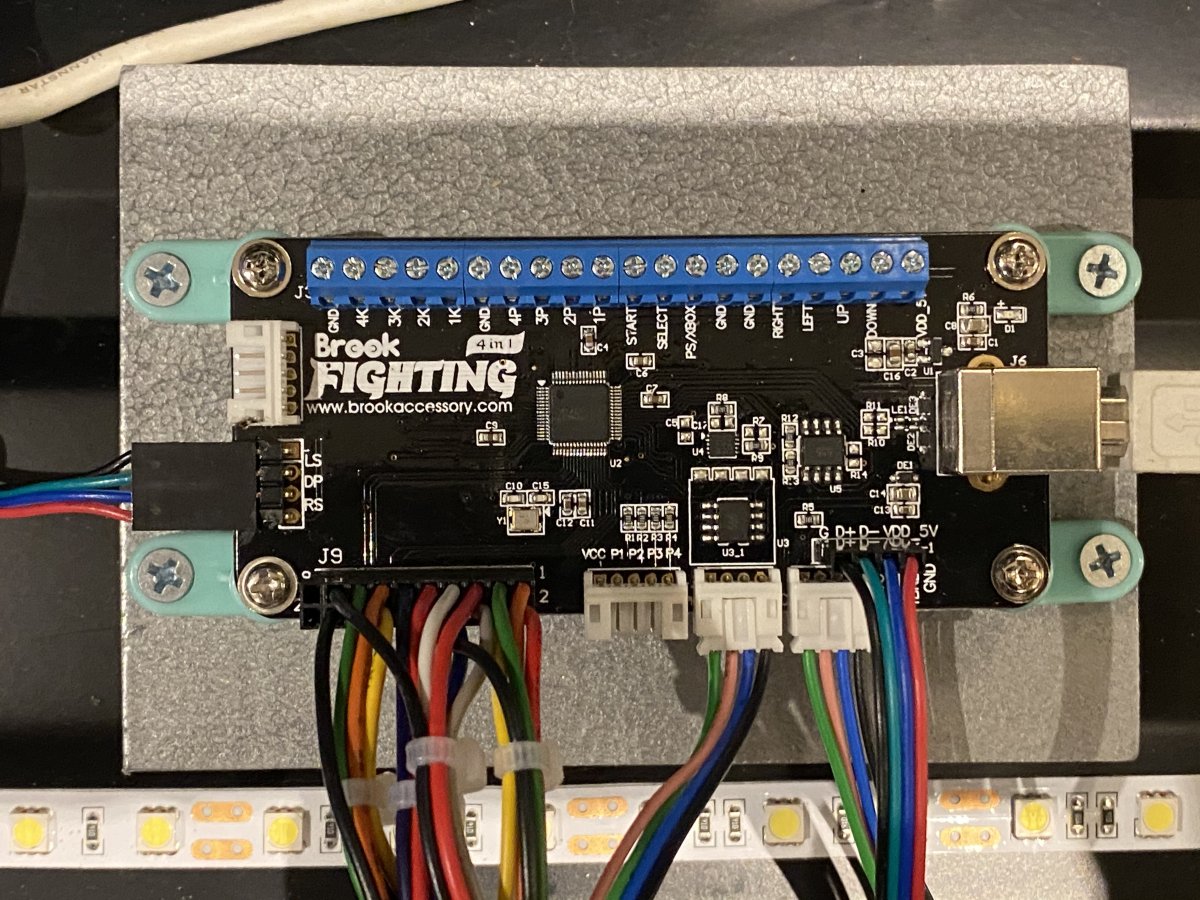

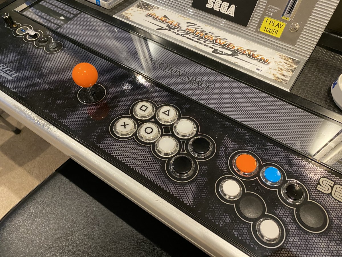

Hi, is there a way to connect L3 or R3 to an external button like we can do with home and select ?
On my Lindbergh I modified a Noir clone panel to support all the functions of a Brook board which was really built for fight sticks to mirror modern game controller functions. People use aux button panels on the Vewlix. The L3 & R3 are the white 24mm buttons bottom right in the pic. You can buy the harness you need (when in stock) from Focus Attack and probably other places. In the second pic you can see it attached middle bottom.
https://focusattack.com/4-pin-l3-r3-touchpad-button-harness-for-brook-universal-fighting-board/

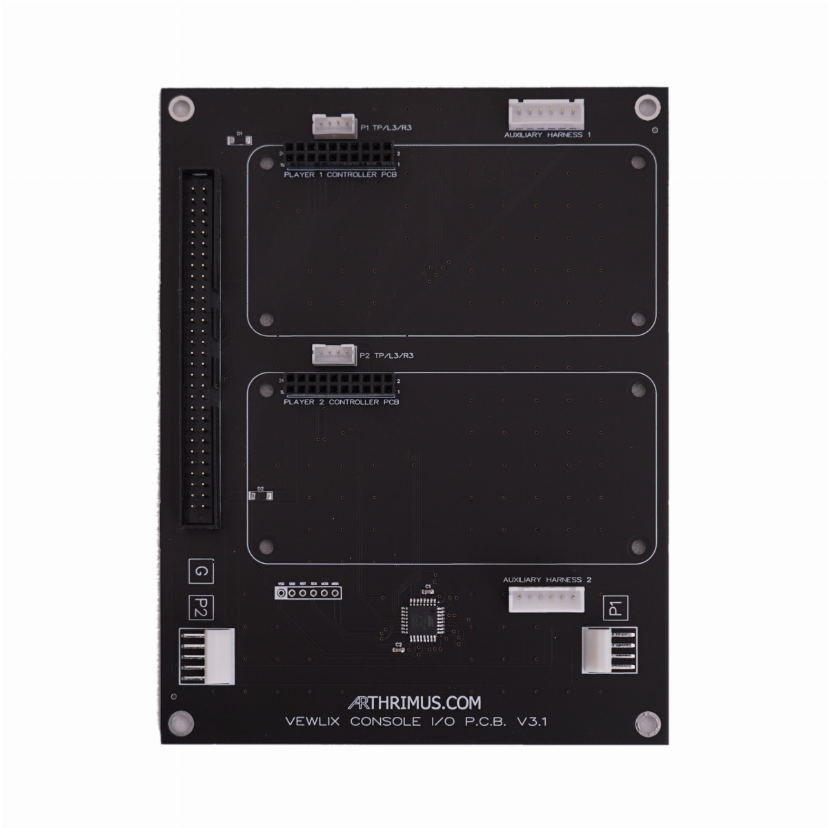

So I wanted to let everyone know that the Console I/O V3.1 is now in stock on my website. This is a newly updated version that adds a second 6 pin harness connector that allows you to connect P1 and P2 B7-B8 buttons directly to your I/O board. The PCB color has also now been changed to matte black. All other features are the same as the Console I/O V3.0.

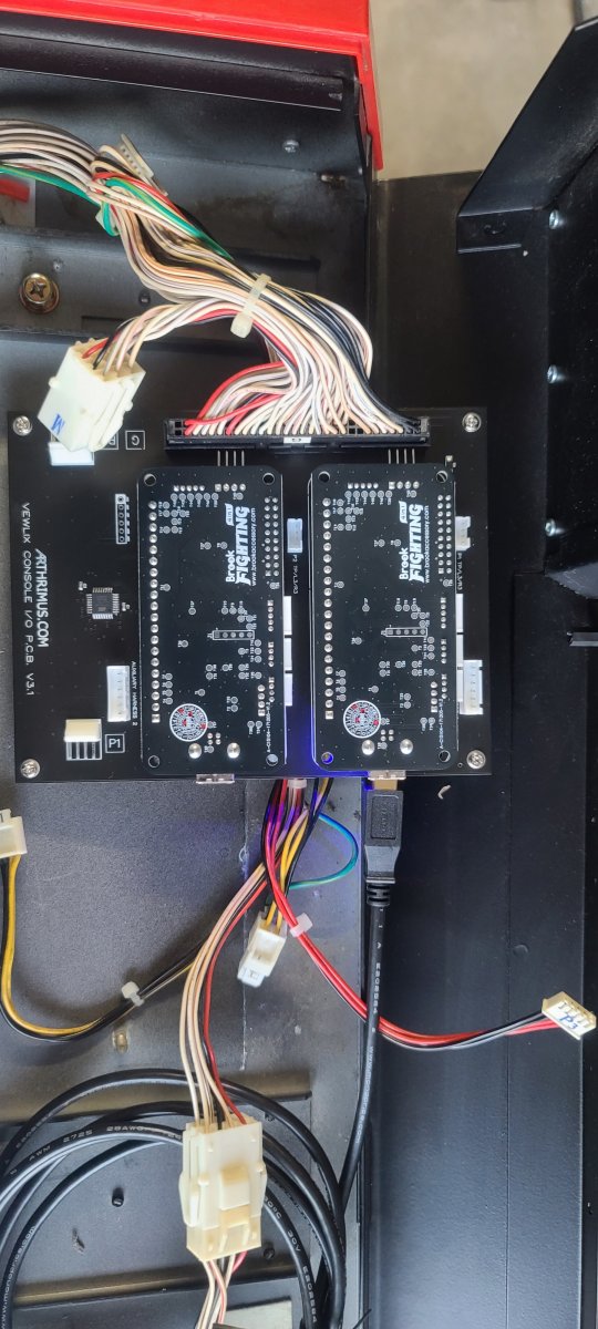

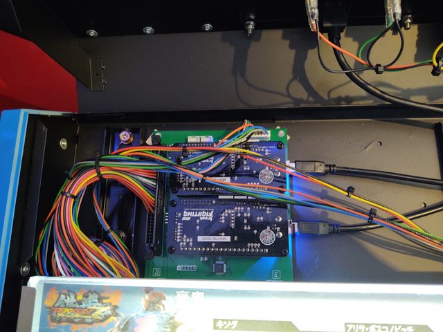

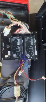

Not sure if these will help you..
where did you get the harness for the aux panel? the one for the 6 buttons on your top panel
also, Idk If it was the same for you, by the pictures it doesn't look like it. I had to use a one of those neutric adapters that came with the brook.
if I didn't use it, I could only control stick and only two buttons worked.
but if I used brook>1foot cable to neutric >neutric to 1 foot USB
hope that makes sense
@Arthrimus I have a couple of questions.
1. Are all 8 buttons passed on to the G harness from the Vewlix Console IO? Lemony is going to make me a custom G harness with the added P1 button 7+8 and P2 button 7+8.
2. Do you have the pinouts for auxiliary harness 1 and 2 on the Vewlix Console IO?
Thank you.
All 8 buttons are routed to the G harness according to the pinout on the Arcade Otaku wiki. The pinouts for both auxiliary harness connectors are printed on the silkscreen on the back of the Console I/O.
