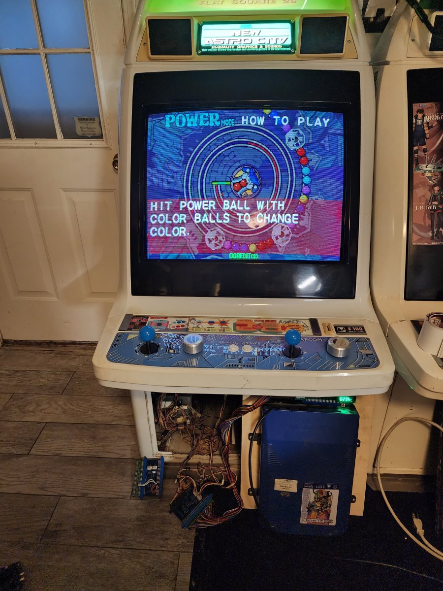

i tried just now. like i said before... while capcoms io may work in a similar way to brizzo's, it does NOT do it in the exact same way. so far i have concluded that with paddle mode ON, the spinners will NOT work. this is consistent with just about EVERY game i have tested with the brizzo board that has its own dedicated io, or paddle or spinner option in the test menu. however it WILL work with 8 way joystick mode but very badly. 2 WAY option works fine enough.
the way the capcom spinner IO works is it takes input from the spinner and uses that for movement. it has its own code written into the game for controls and take factors like speed of rotation and all kinds of other stuff into consideration. the Brizzo board doesnt do that. The way the Brizzo board works is it takes input from the spinner and transfers that input into directional input, ie: right, left, down , up or pins 18-21 on jamma. the brizzo adapter is only checking if the spinner is moving left, right, or not at all.
when you set up the paddle mode in the menu and run puzz loop 2 with you spinners plugged into a Brizzo adapter, you will get as far as the start of the game, then your character will barely wiggle back and forth correspondingly with your spinner movement. this is because of what i said previously, and that spinner io does more than just read if the spinner is rotating left or right.
so definitively, i can say with the utmost degree of certainty that while the paddle mode on puzz loop 2 is engaged, the game will NOT be playable with the Brizzo adapter. paddle mode can not be engaged for spinners to function with brizzo adapter. Brizzo board WILL work if mode is set to 2 way.

I can confirm that Puzz Loop 2 receives no obvious paddle input with the Brizzo adapter when set to paddle. I assume the game/Capcom adapter is using pins other than joystick left and right, but I can't confirm since it's a little hard to trace from the pictures I've seen. It might be possible that the Brizzo adapter is generating signals that the game would like, and they're just not going to the right place.
Using the 2 way joystick setting with the Brizzo adapter and the Hursit spinners seems fine to me. I can't say I'm the #1 Puzz Loop 2 fan either though.

Well, shit, that's a defenitive answer. Thank you for taking the time to test that out. 👍🏻
im not 100% on the workings of the capcom io, but thats my educated guess based upon my experience with the way forgotten worlds works natively and other games work with the brizzo adapter. its feels different and when any game is set to a paddle or spinner mode, the input just causes the player character to wiggle back and forth a couple pixels. i am curious to know EXACTLY what is going on, but i think its safe to say at the very least the spinner io's are looking for more data than just "is the spinner spinning left, right, or not at all"
