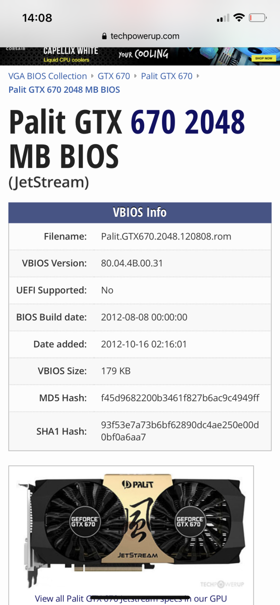

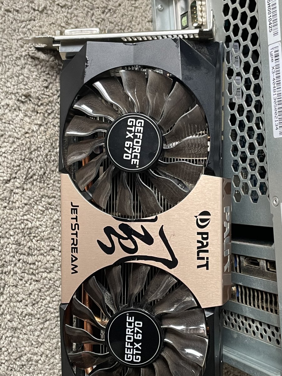

Just to add to the community I’ve replaced my mai gtx 660 in my ttx3 with a palit gtx670. Had to flash bios and now works fine sfv at 60fps no issue.

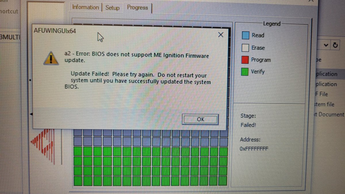

Hi,
I have a TTX3 404 originally with a B13 bios that I flashed in B23.
I have tried an I7-2600K and an I7-2700K and neither of them work.
The PC starts for 1 second and reboots.
I flashed in B13 and the same they don't work.
During the flash I have this error, but the bios is in B13
If I uncheck Ignition in setup, I no longer have this error.
And in B16 it doesn't work either.
Maybe the motherboard doesn't support unlocked 'K' variants. This is why I moved away from the original board. Its cheap and nasty not to mention ancient.

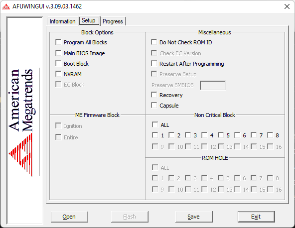

How did you take the backup of your original bios?
From here make sure only "Main BIOS Image" is checked and click Save. The resulting .bin file is what I wrote back using the same method of only having Main BIOS block checked. When I did the first upgrade to the uefi bios I also only had "Main BIOS Image" checked.
This ensured nvram contents were not modified however it appears that the system does some sort of cmos reset on each bios switch because default values always loaded up and modifications were lost. Both times after a successful bios flash the unit did two power cycles before posting. It makes me wonder if the nvram contents that are lost forever/render x3 as paperweights is only the loss of the master hd password and nothing more.
Edit: for those of you messing around with upgrading your own machine please do not take my steps as a 100% method to upgrade your unit if you're having troubles. This worked for me however I also have a full lab to which I can remove the flash chip and reprogram it manually if necessary. When messing with BIOS flashing you always run a high risk of turning something into a brick. Do not do something if you are not familiar with what you are about to proceed with and understand what you have selected.

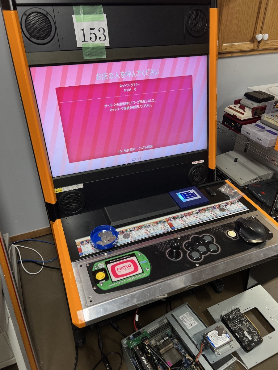

Makes me wonder if I can resurrect this third x3 monstrosity I was building but put on time out because it kept coming up with a black screen post. Do you happen to know if a dongle has to exist for post to complete? This last machine I got was just the mobo pcb + fast io board with the dongle stripped.
"all the parts are fine"
they were not fine... a ram swap brought it to life lol. BEHOLD: PERFECTION!
I've had a dead RE1 chassis sitting around for ages and figured it'd be better put to use as something else :)
