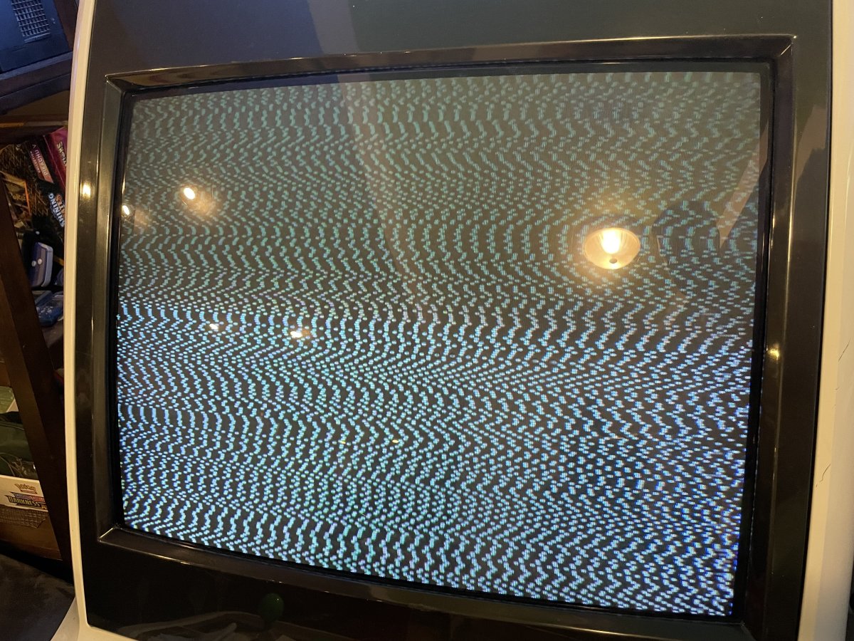

I power up the pcb and get this screen while that chip is burning like hell. It’s the security chip/ mask rom yeah? I read it on one of your repairs 💪

The GXC-04 is a TMS320C010 DSP co-processor in disguise with internal MASK ROM, it's used as protection.
Anyway, I just checked, Zero Wing PCB does not carry the 'GXC-04', maybe your are confusing it with the 'FDA' chip.Please, check better your board.
This was sold to me as a zero wing, I should have checked the roms right away since now I can do that ; it comes up as demons world 😅
Yes, this was my assumption since Demon's World do use the 'GXC-04' MCU.
