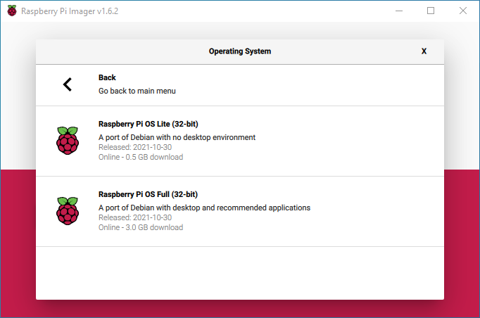

Head over to raspberrypi.com/software/ and download their Raspberry Pi Imager software.
For OS, I chose 'Raspberry Pi OS (other)', and then 'Raspberry Pi OS Lite (32-bit):

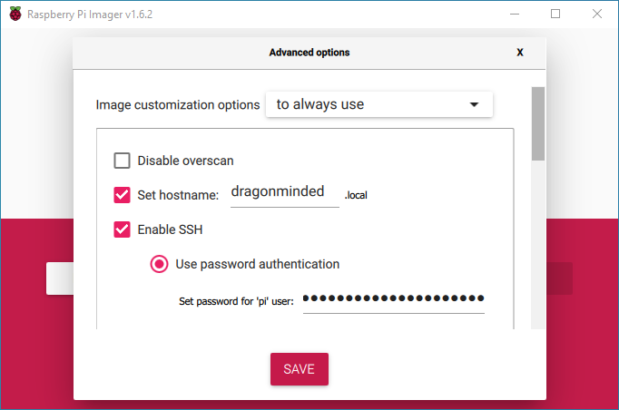

Before you hit 'Write', first press Ctrl-Shift-X to enter the advanced Menu:
Here you should set the hostname, enable SSH, add a password for your Pi, configure your WiFi & locale info etc. Click 'Save'.
You can now hit 'Write' and burn your SD card.

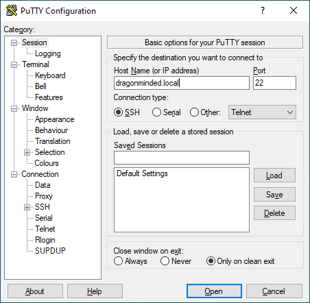

I use 'Terminus' on my iPhone, or PuTTY from Windows. Mac and Linux should work from the command line.

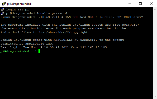

Assuming mDNS is working, you should be able to connect to your Pi with the <hostname>.local you set earlier:
And connected:
If mDNS is not working for you, you can either check any network admin tools you have access to in order to find the IP address of your Pi.
Another solution is to plug the Pi into a HDMI capable screen (TV, computer monitor, anything) and when it boots up it will print "My IP address is x.x.x.x" close to the bottom of the screen (thanks DragonMinded).
You can use that IP to connect with PuTTY.

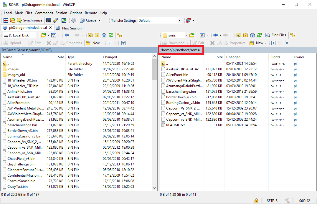

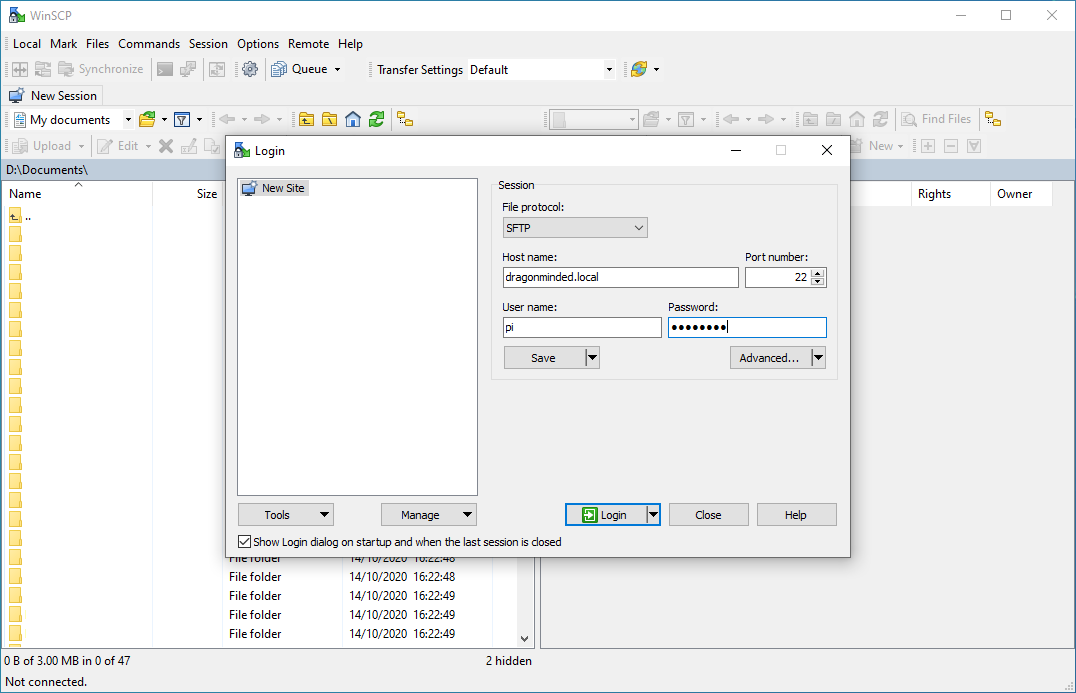

I make use of WinSCP for file transfer:
Navigate to 'netboot' and then 'roms'.
Select your roms to transfer and the click 'Upload'.

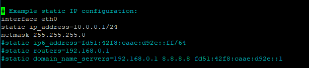

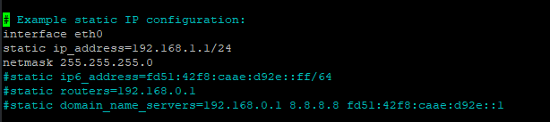

Scroll down to interface eth0 and edit as follows (remove comment hashes (#) at the start of each line).
(Here we are setting the IP address of the Raspberry Pi).
For 192.168.1.X:
For 10.0.0.X:
Press Shift+X to exit and Y to save changes.

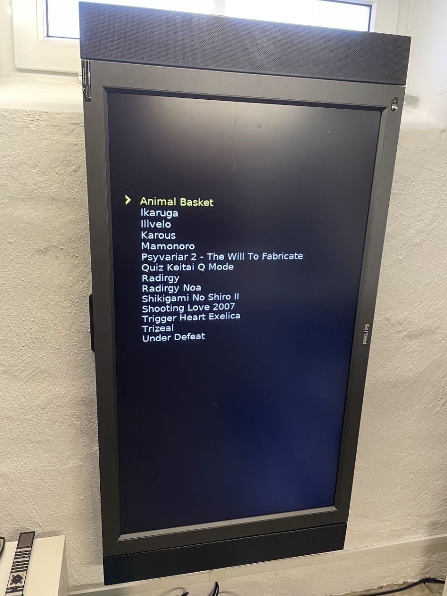

Switch everything on! Naomi should boot to Checking Network screen, and if everything is working, the new OSD menu should auto boot!
DragonMinded Test Menu
Hitting the Test button while viewing the menu with open an options screen.
Here you can set the menu to read game titles from file name or from file header.
Reboot to apply.

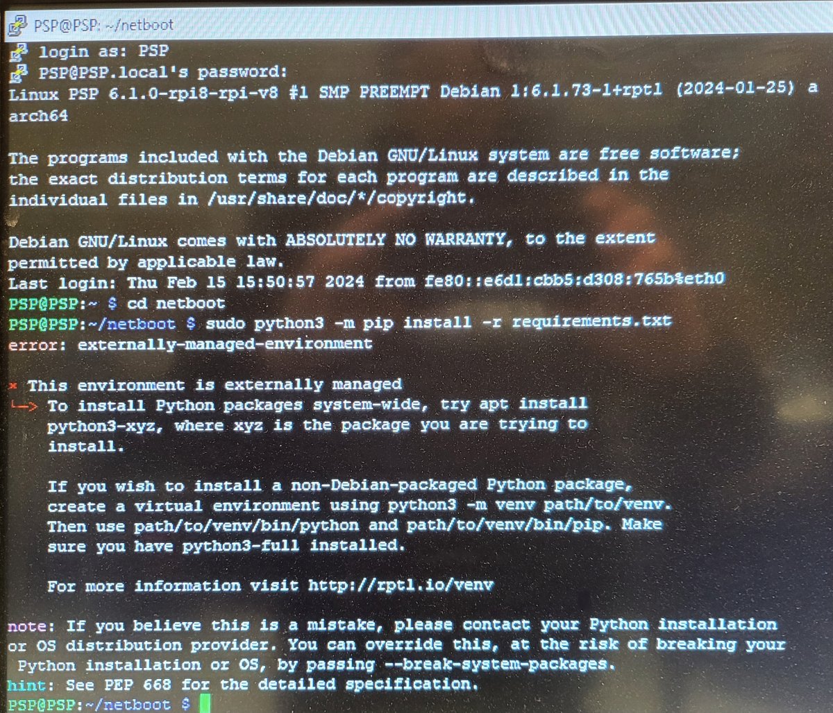

Hello everyone! sorry to resurrect a old thread but im hoping you guys can help me resolve an issue with this step in the process of getting my PI 4 set up.
sudo python3 -m pip install -r requirements.txt
when i use this line in the putty it gives me an error as if these files dont exist anymore. any insight would be super helpful. thanks in advance.
Here is the error message I am getting, following the instructions to get the Pi 4 working for this application everything has gone well so far till reaching this point.
It probably makes more sense to use the all in one WiPi image https://www.arcade-projects.com/threads/naomi-pi-wipi-netbooter-compatible-with-pi-3-4.14019/
The error you're running into is because python is ass and the community cant ever decide how to manage and version control packages. What you're doing is attempting to install the packages in requirements.txt system wide via pip. You should be using a virtual environment, but I don't know if everything you want to do was designed to run in a venv.
If you don't want to use the WiPi image, you can probably proceed fine with --break-system-packages since this is pretty isolated already being on a standalone Pi. The alternative would be to create a venv and install the packages locally.
