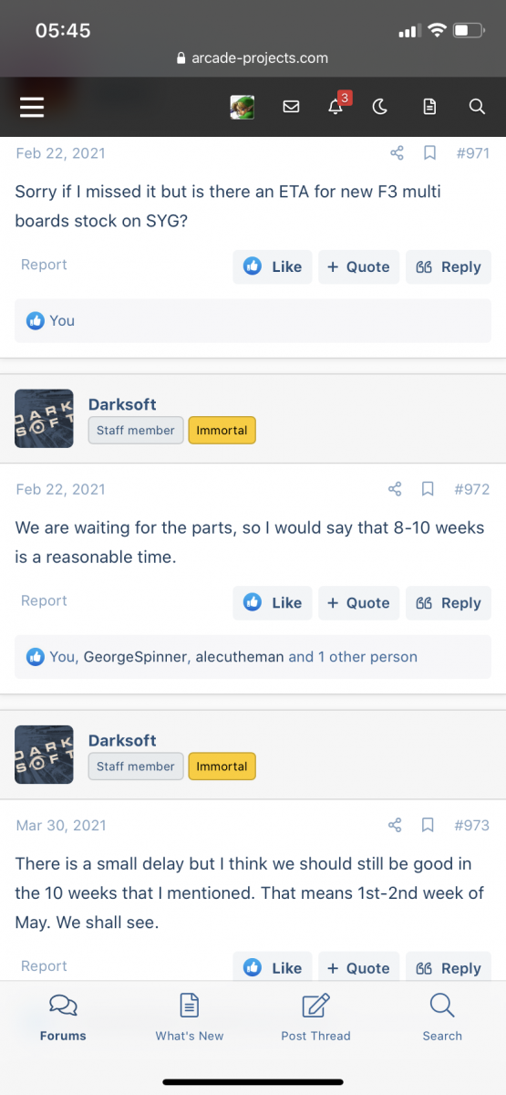

@rogersta & @Arthrimus ... guys , on previous page Darksoft made some announcements about F3 stock
There is a small delay but I think we should still be good in the 10 weeks that I mentioned. That means 1st-2nd week of May. We shall see.
