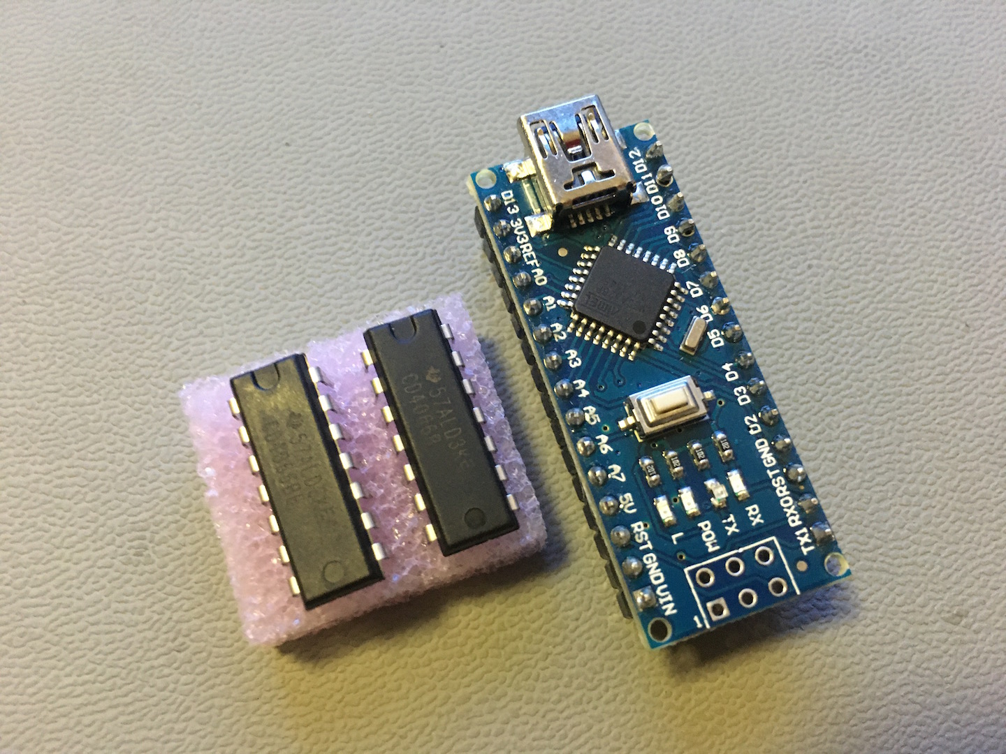

Hey @stt1 and @miisalo, happy to report I have the selector working! These were the parts changed:
I bought the two 4066 chips from my local electronics store for a couple of bucks and replaced them with no luck. Then I ordered an Arduino Nano clone from eBay, programmed it, and all is working as intended. Total cost was $10 AUD ($7 USD).
Note: I didn't want to risk the old 4066 chips in case they were the culprit in blowing the original Nano.
Awesome work on the selector by the way, actually makes the multi a lot more functional and fun. I highly recommend it to anyone with this multi.

Pretty simple to fix: the display module is in sockets, just raise it up from the board. Those 4066 chips are socketed too, you'll find them when the display module has been removed. Just be sure that you'll put the 4066s correct way to the sockets - if you need a picture, I can take one next week. Then install the display back. And finally replace the arduino, it's in sockets too.
Last phase: get the new arduino programmed.
Important - before you connect the PC via USB to arduino for uploading the software, remove all connections between the multicart/ST-V board and selector.
I am unsure I did this when I programmed it. Is it dangerous? The ST-V wasn’t powered on though.
Should not matter with the signal (flat cable) or the reset. But power wire is important. When you connect the USB, it powers up the whole selector and there is also +5V on the power line, which goes to ST-V board as well if the wire is connected... The end result may be something unwanted as the ST-V board tries to boot as well.
Another way around is taking the arduino off from the socket when programming it.
Argh. I forgot and was too eager to try so just quickly programmed the arduino.
But it seems the ST-V motherboard is fine. I pulled the 5v from the pins beside where the selector is mounted. Hope I didn’t do any damage :/
I was wondering actually why the screen was so high / low in contrast when I was programming though!

And one thing to everyone. Always take out the arduino from the board when programming just to be sure. And remember to put it back to right position (socket is 32 pin and arduino 30) or at least remove connections to the multicart, especially the power. If power is connected to the board or multicard, usb is basically powering the whole st-v board through arduino, there is only one diode between VUSB and +5V. This can lead to very unexpected results. Voltage drops, voltage can even spike, flash writes might fail etc.
Good to hear. As we debugged, the there was dead arduino pin(s) so you anyway needed the arduino, but it was wise to also replace 4066s as they could have been culprits by draining too much power from IO pin.
