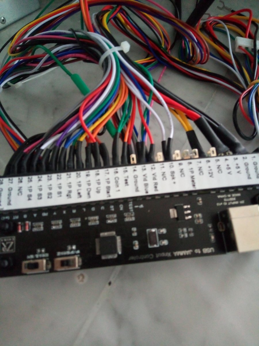

Does Anyone know if it is possible to use Jamma connection with X4 , i try a Jamma to USB adapter but when starting my X4 Image on JVS mode it won't reboot .
