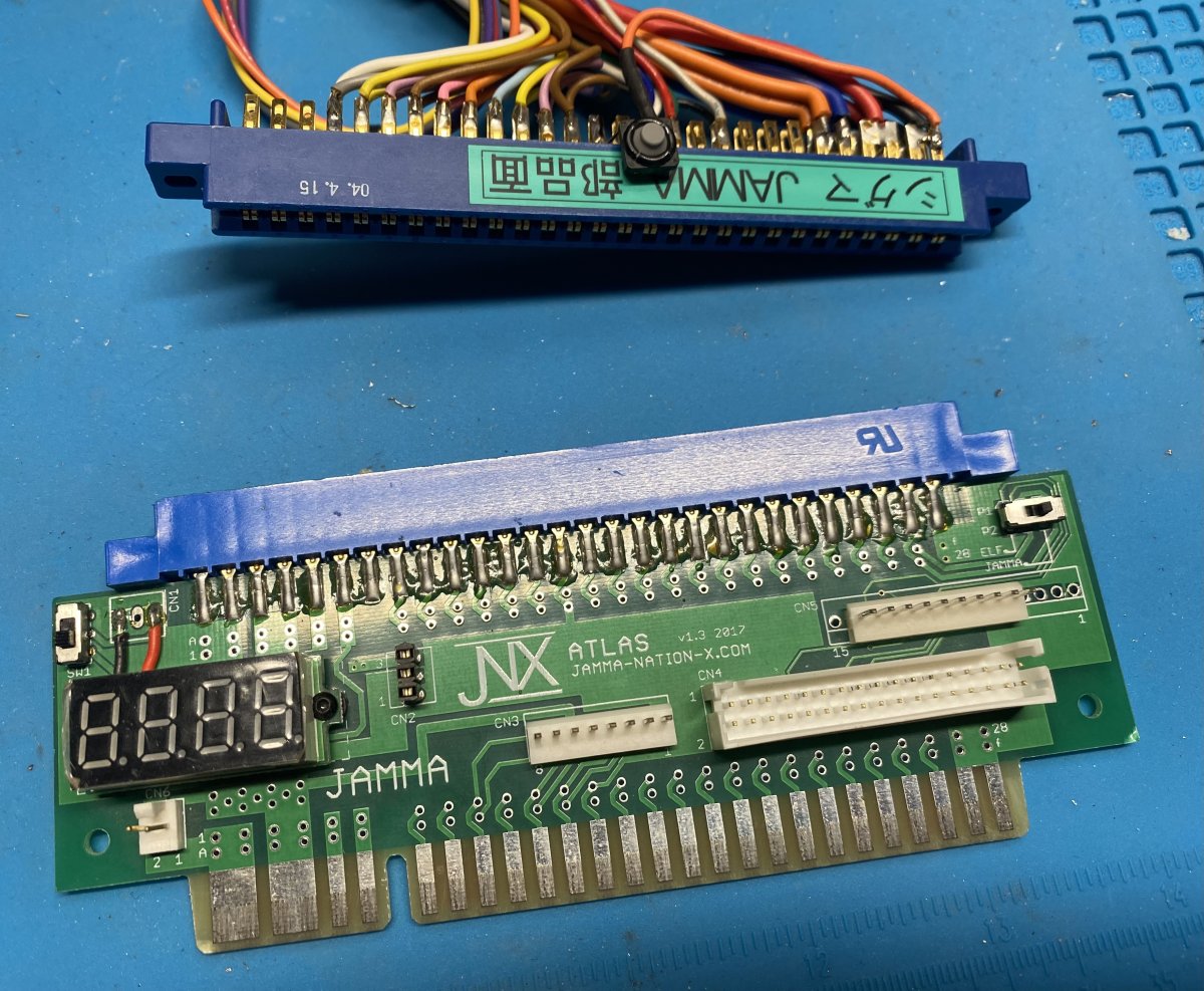

Here is a pick of one of the JNX adapters I have.
Also a pic of the tactile switch I attached to the harness for “Test”

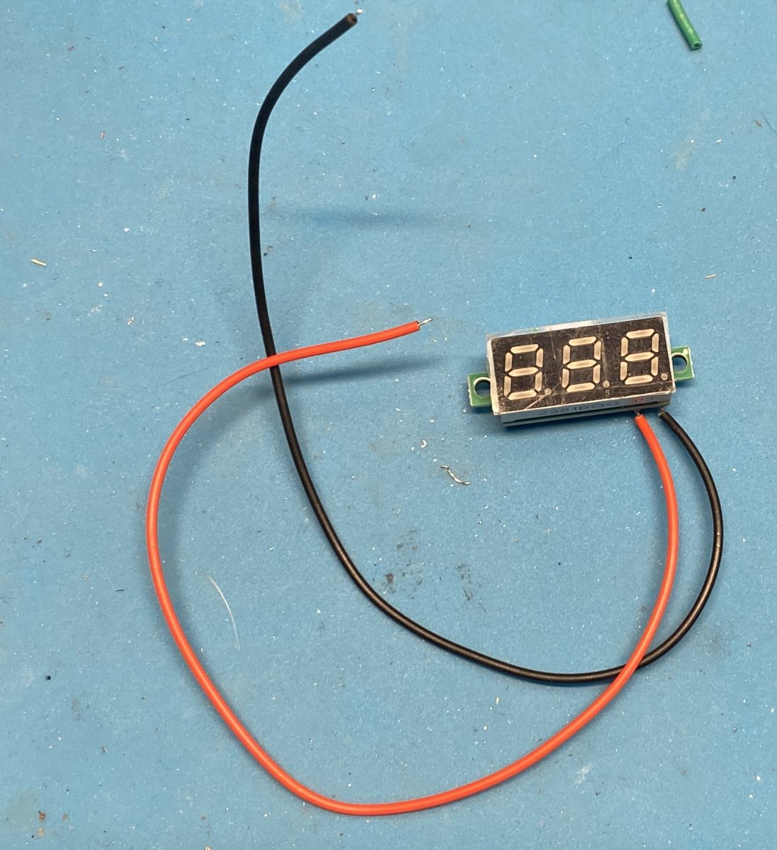

You can also find voltmeters on Amazon and attach to your harness as well…
But you can’t be any geek off the street, you have to be handy with the steel (iron)…
Easiest would be to get an JNX adapter…
Regardless of where you buy a voltmeter or where it’s installed on your harness, keep in mind that these cheap voltmeters are not replacements for a digital multimeter. Often, they’re not calibrated well and definitely not calibrated to where you want the reading. As you’ve seen, the voltage can vary depending on the length and quality of the harness you’re using. Fortunately, you can calibrate even the cheapest voltmeter so that you’re taking a reading from the PCB side of the JAMMA connection.
My advice for when you get an in-line voltmeter is to power everything on and using your multimeter adjust voltage so that you’re getting 5.0V on the PCB side of the JAMMA connection. Then just calibrate the voltmeter so that it reads 5.0V—there’s a tiny adjustment screw on the back of the voltmeter.
