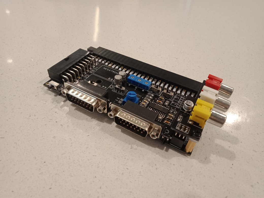

Sentinel Supergun - Prototype
I haven't installed the Negatron or voltmeter as yet, but you can get the idea.
Not indicative of the final version but pretty close.
Spot on @PascalP

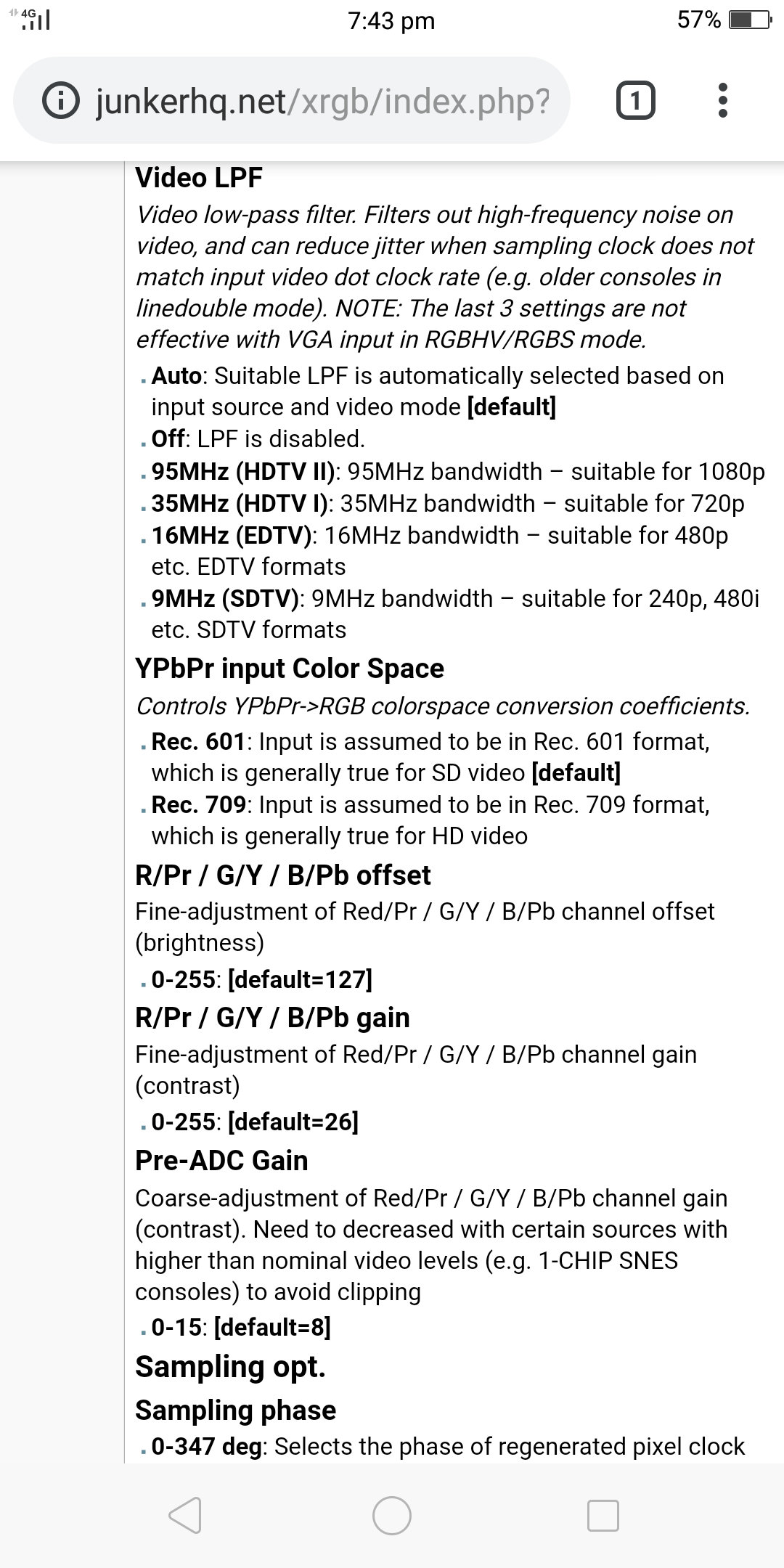

Issue with the OSSC and VGA SCART is that the LPF is always enabled and can't be disabled. Meaning if the supergun is applying an LPF, on top of the LPF the OSSC is applying, the image quality degrades.
Won't be an issue with the Sentinel as I'm utilising the THS7374 and have incorporated a switch to enable or disable the LPF as you desire.
Scart you mean I guess ;)
No, to my knowledge one can freely enable or disable the LPF on an OSSC via the scart input. It's the VGA input that forces the LPF to on and can't be disabled via a menu setting such as can be done via the scart input.
That's my understanding anyhow.
ok, cool, I always assumed there was no LPF on the VGA at all, so you then can set it to AUTO/OFF/95 for VGA when I'm reading it correct?
It appears so.
Just confusing for me as I don't yet own one and smiley did a great write up where I swear he said the LPF was on by default for VGA, and unable to be disabled.
