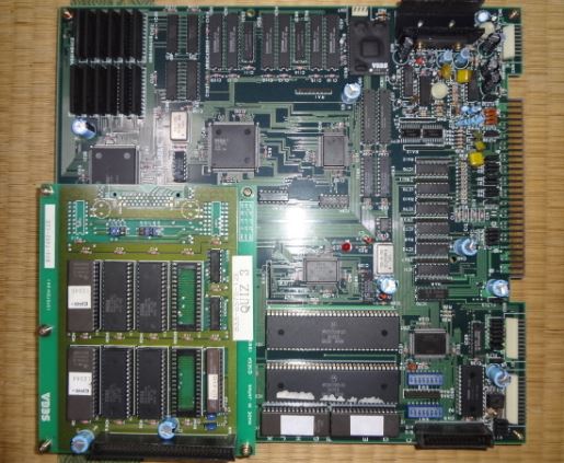

To install the small board on the motherboard first pull IC1 and IC2, then install the board like this (better pics to come):
The bigger board plugs in the romboard like this, again all ROMs have to be pulled first.

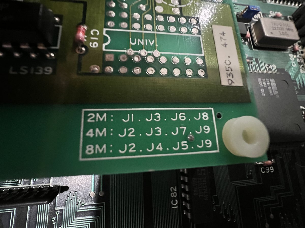

Jumpers have to be set like this:
- J2/J3/J7/J9 = closed
- J1/J4/J5/J6/J8 = open
- J10/J11 = 1-2
If you instead requested a custom romboard with your kit just plug it on the CN2 connector of the motherboard where original romboards plug. There are no jumpers on the custom romboard (everything is already hardwired properly).
xmCBtnN
Boards interconnection is simple, left pin with left pin, middle pin with middle pin and... right pin with right pin. You can't damage anything if you do it wrong but games won't boot.

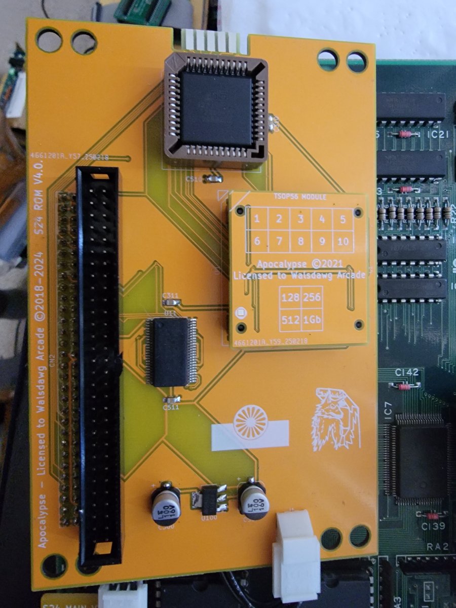

A custom romboard can now be ordered with the kit for those not having an original romboard or as an upgrade.

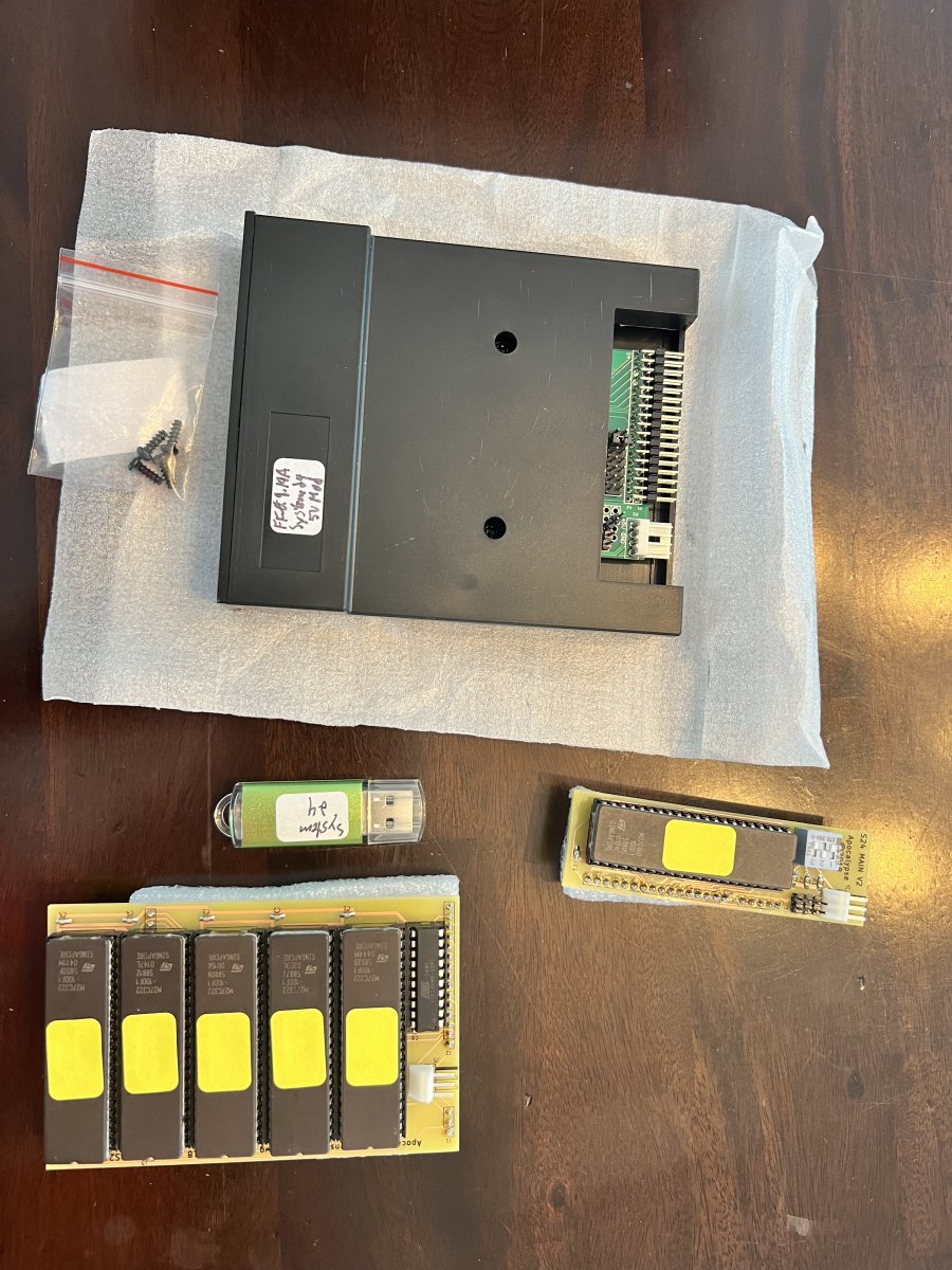

@Mitsurugi-w can you post pictures from the 2nd S24 kit? I finally found my motherboard and now am trying to figure out how to do this. I have the Quiz game, so no floppy drive on that working motherboard, and I also have a Gain ground with a floppy drive, but have no idea if the motherboard works as the drive is missing the disk.
Finally, I have a scattered S24 kit (2nd rev), so I need pictures of what was included initially and how to install. Thanks!

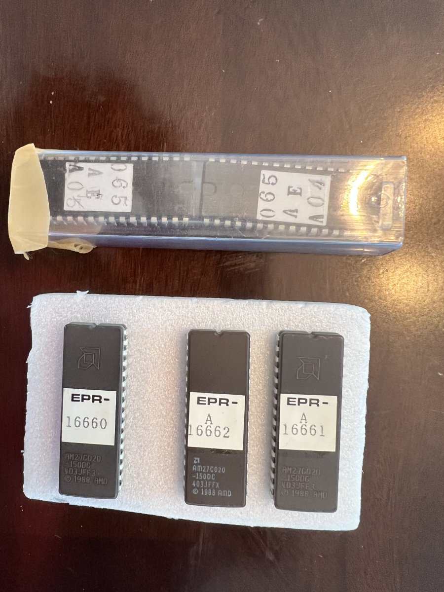

Here are two pictures of all the stuff in the boxes I had. I think I have a full Rev 2 kit, and some extra EPROMs from something... probably not related.
EDIT: Looks like I'm missing the jumper cables, if you update the pictures on the first post it will help with installation and for me to figure out where/what these look like.
The kit you have there installs the same way as the kit in the pictures above. It is a production v1 kit. You are missing the cable tho.
Not sure about the eproms though. Next time I assemble the new kits I will add some pics.

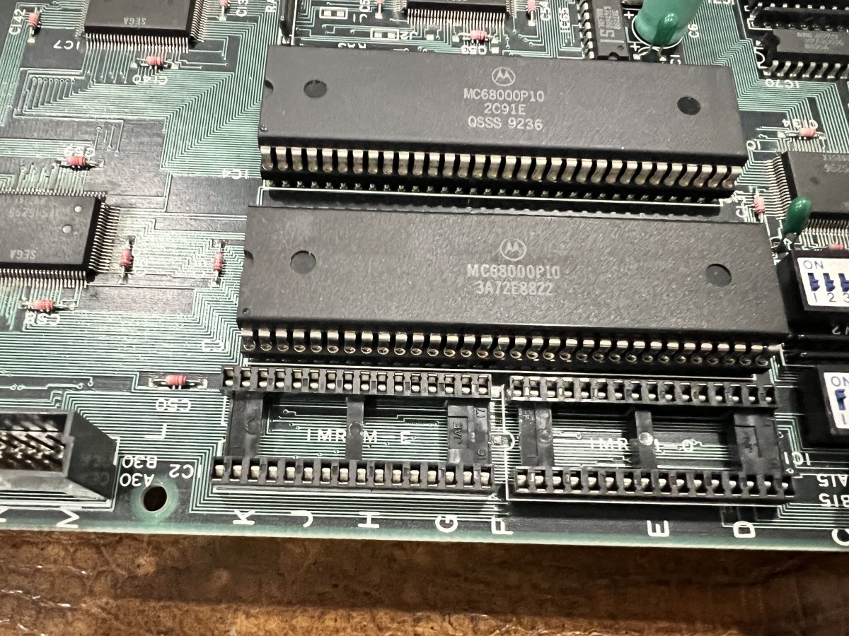

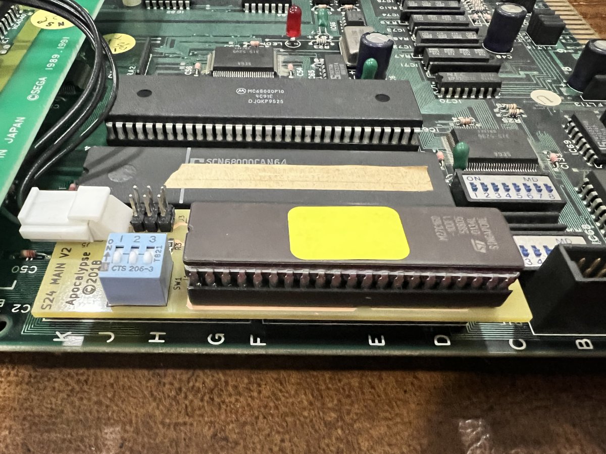

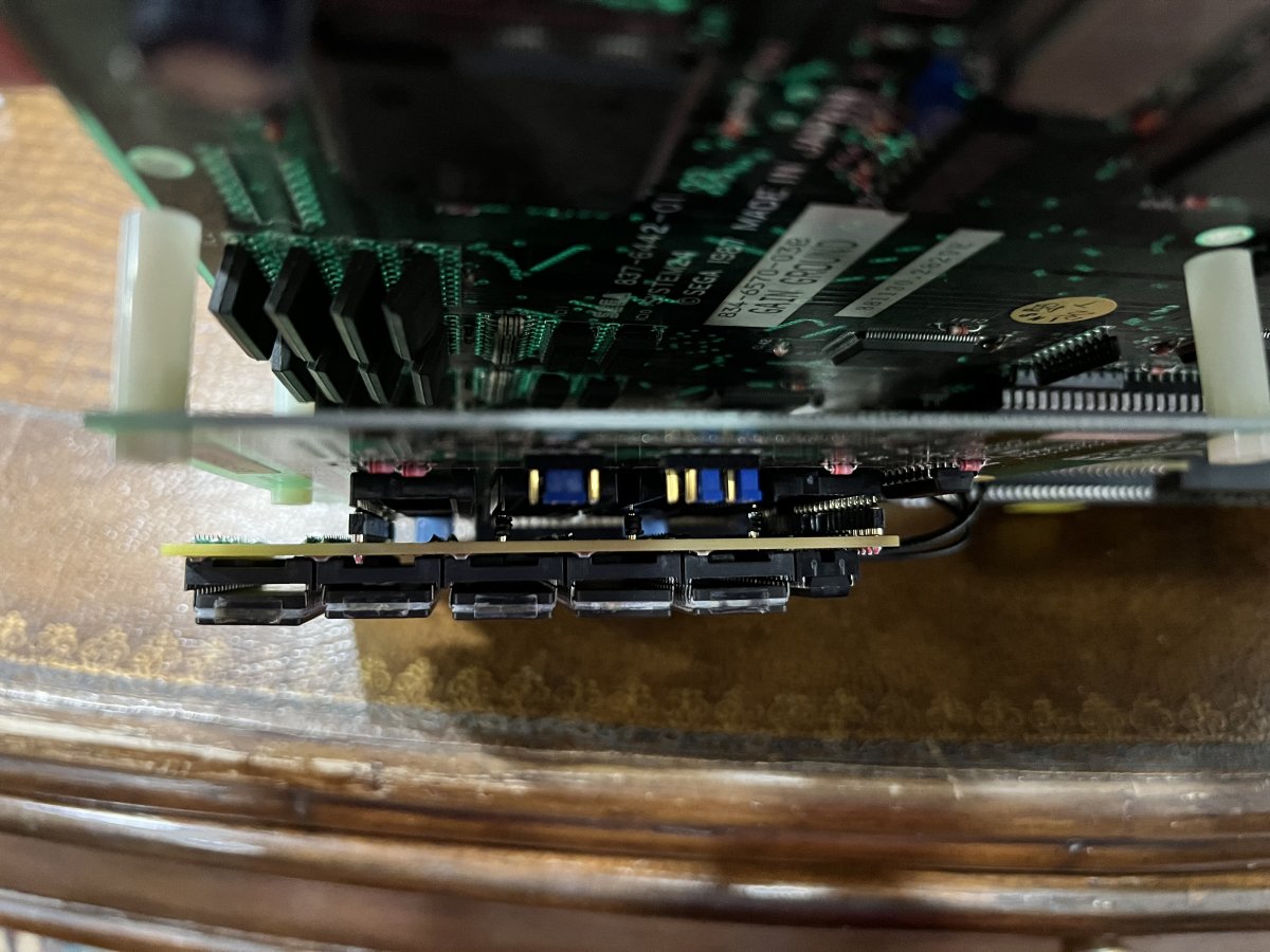

OK First up System24 PCB (remember it is NOT JAMMA, you need a converter and a System16 one will work). Notice the ROM board on the bottom left. You need this to play all those shit Quiz games with moon language. I took a semester of Japanese and I still have no idea what these games say.

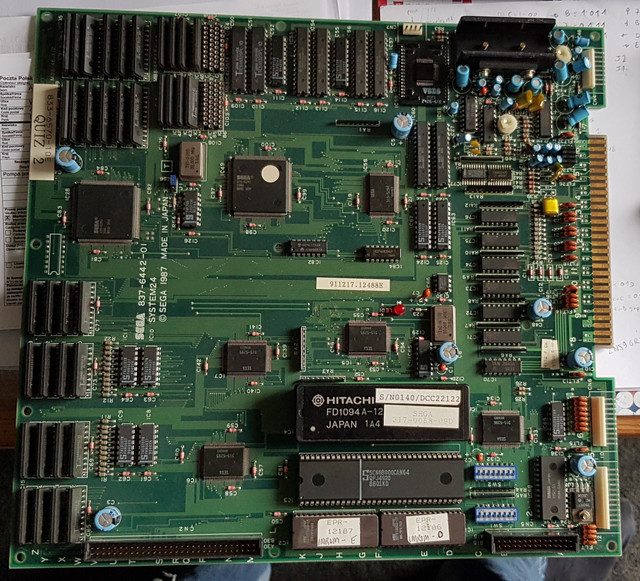

Let's start here. First make sure you have TWO 68000 CPUs, 10mhz plugged in. I got some really nice looking ones from eBay for $8 shipped (for the pair). Took 6 weeks from China to get here, but man, they really looked clean. Next, see my two yellow labeled ROMs? IC1 and IC2. Grab some pliers and yank them out. Fuck the pins, you're tossing them in the trash anyway!
Here you go, all pulled out and tossed away!

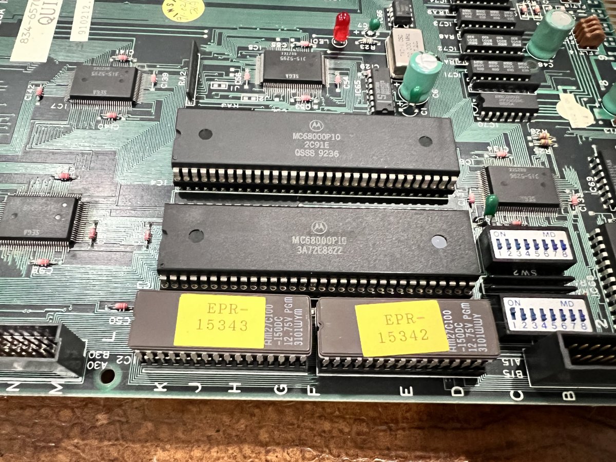

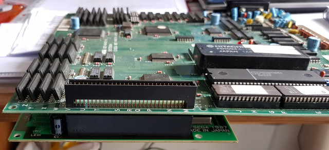

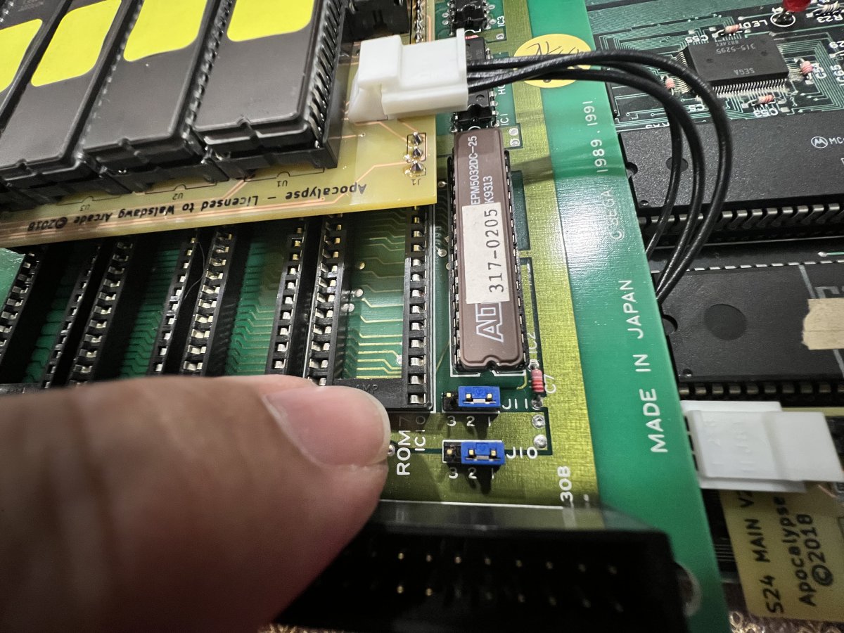

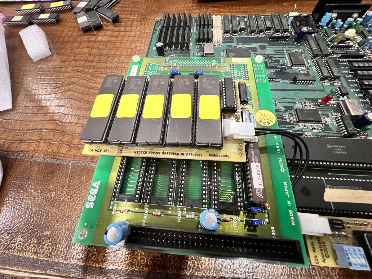

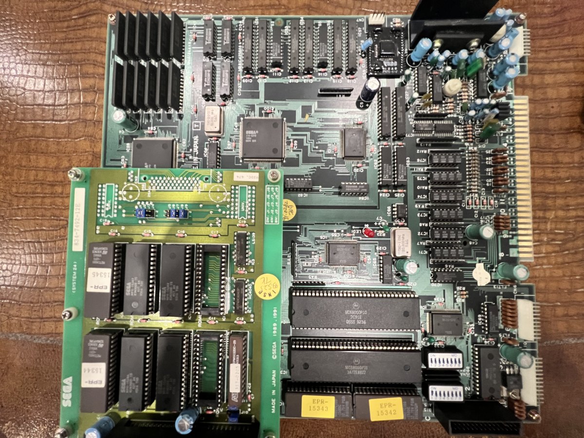

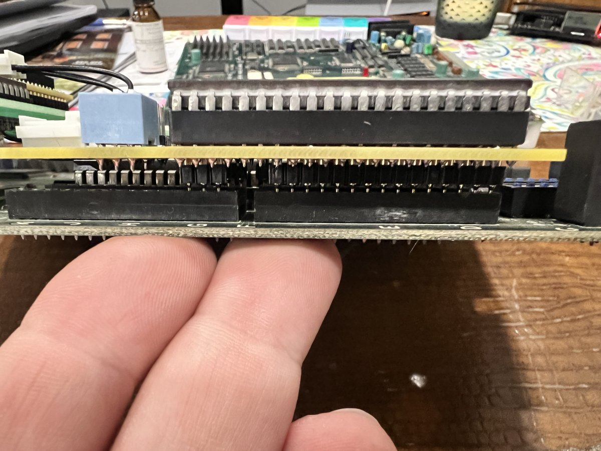

Next plug in the first of your multi PCBs. This one plugs in like this, with the power on the left side and crazy overhang underneath.
Here is a picture from the side so you can how it goes in. ALL the way to the right and double check the other side before you push. The multi Boyz went with some delicate ass thin pins. Don't bend them, but if you do, use a .7mm mechanical pencil, slide over the pin and slowly bend it back. You think this one is tricky? Wait the fuck until you see the god damn ROM board. Geez @Mitsurugi-w what are you doing to us!?!?
OK, I've already plugged in the multi board here, but as you'll see, it's tricky as fuck getting those lone center pins lined up. Especially with old man eyes. By the way, this is why I don't own a Steam Deck. Who the fuck over the age of 40 is trying to game on the go on a tiny ass screen?
Here is a "top" view looking down, once again, all the way to the "right" and triple check that shit before you push it's shit in.
Here's another shot for you.
  • Like
Reactions: rtw

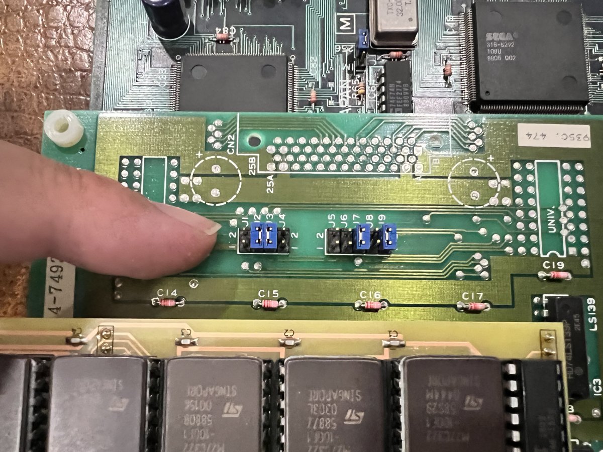

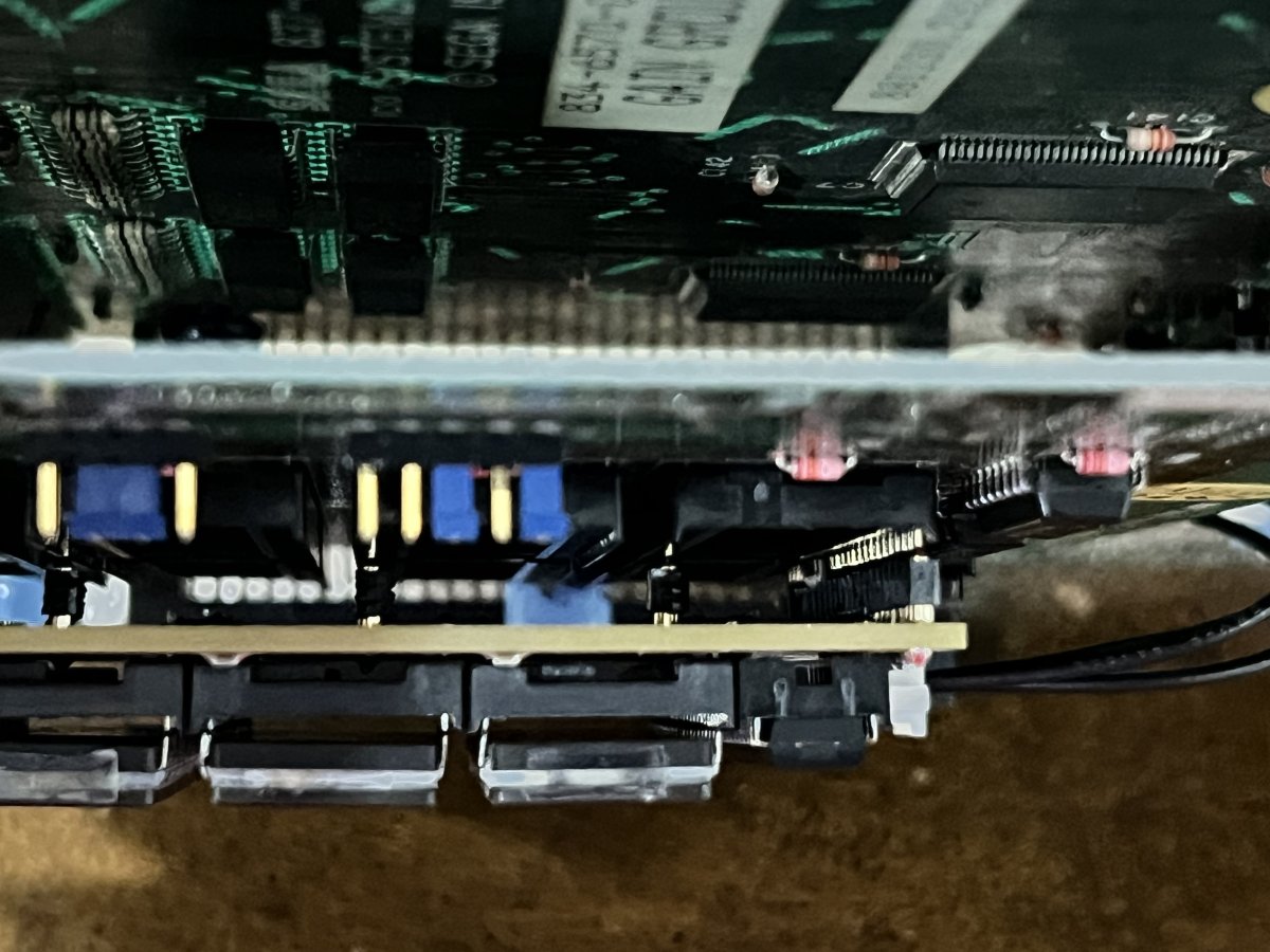

OK, now that it's all plugged in, let's do the jumpers. It's listed above, but an easy reference is also printed on the PCB. You're setting it for "4M" whatever the hell that means. I think it means, "This multi only has 4 good games!" Also, don't forget to swing your ass by and hit the last two jumpers in the bottom corner. There is no cool silk screening here to help you out, so just try to remember, OK?
OK, now you're set to play all the shitty ROM only games. They suck, so let's press on to the good stuff on the floppy drive board.

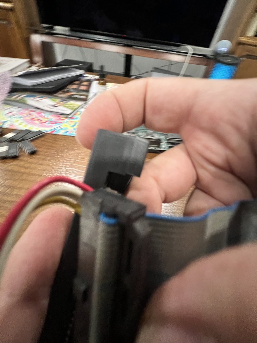

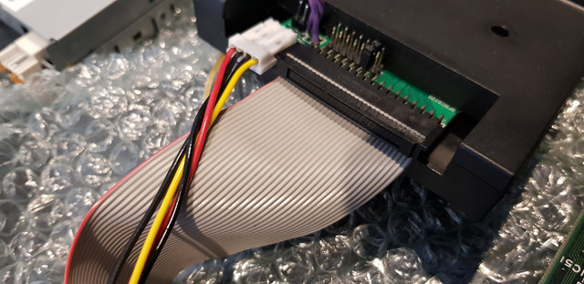

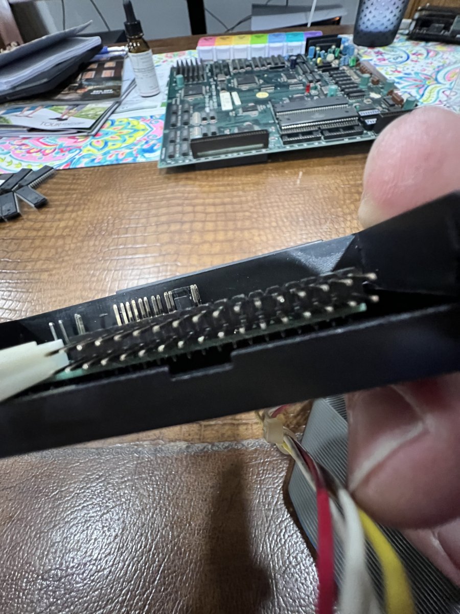

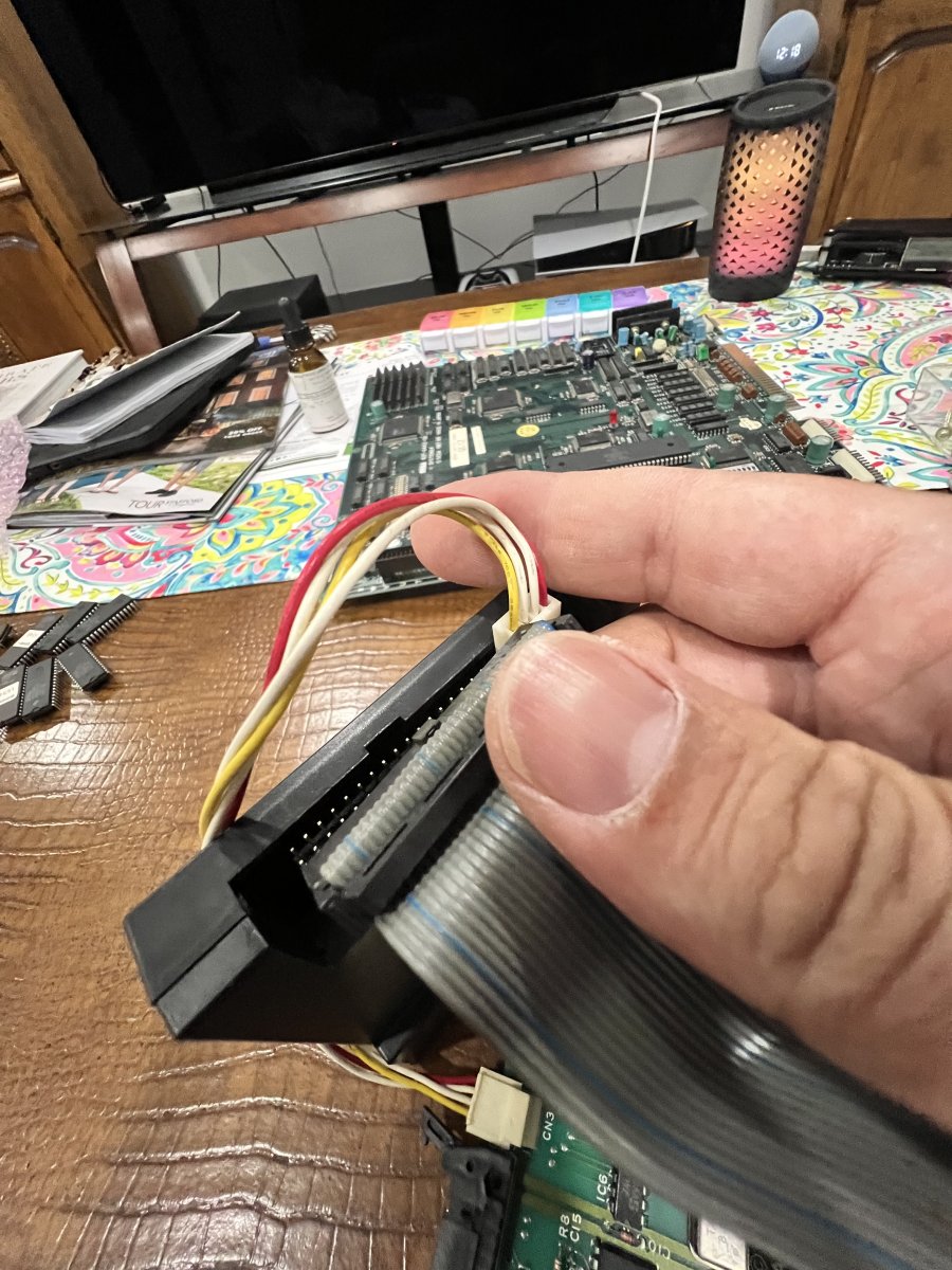

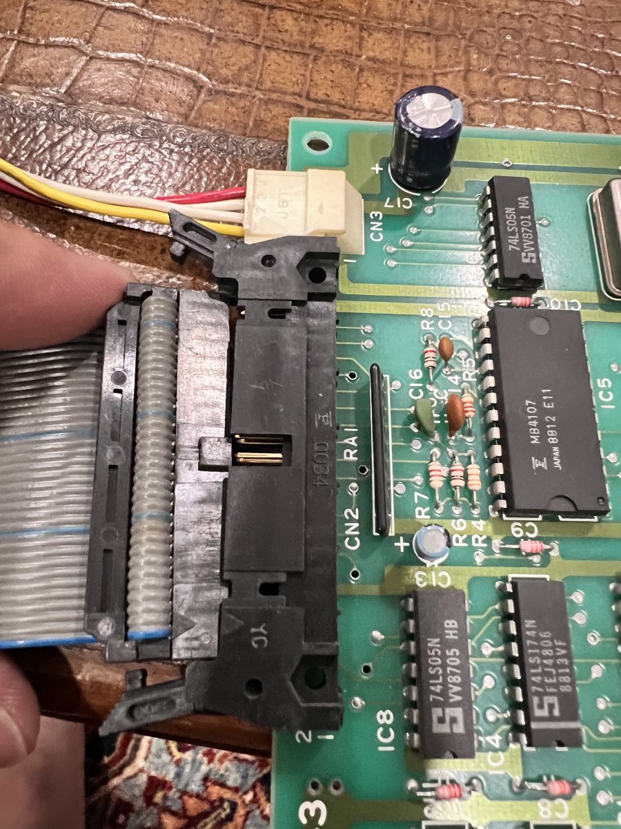

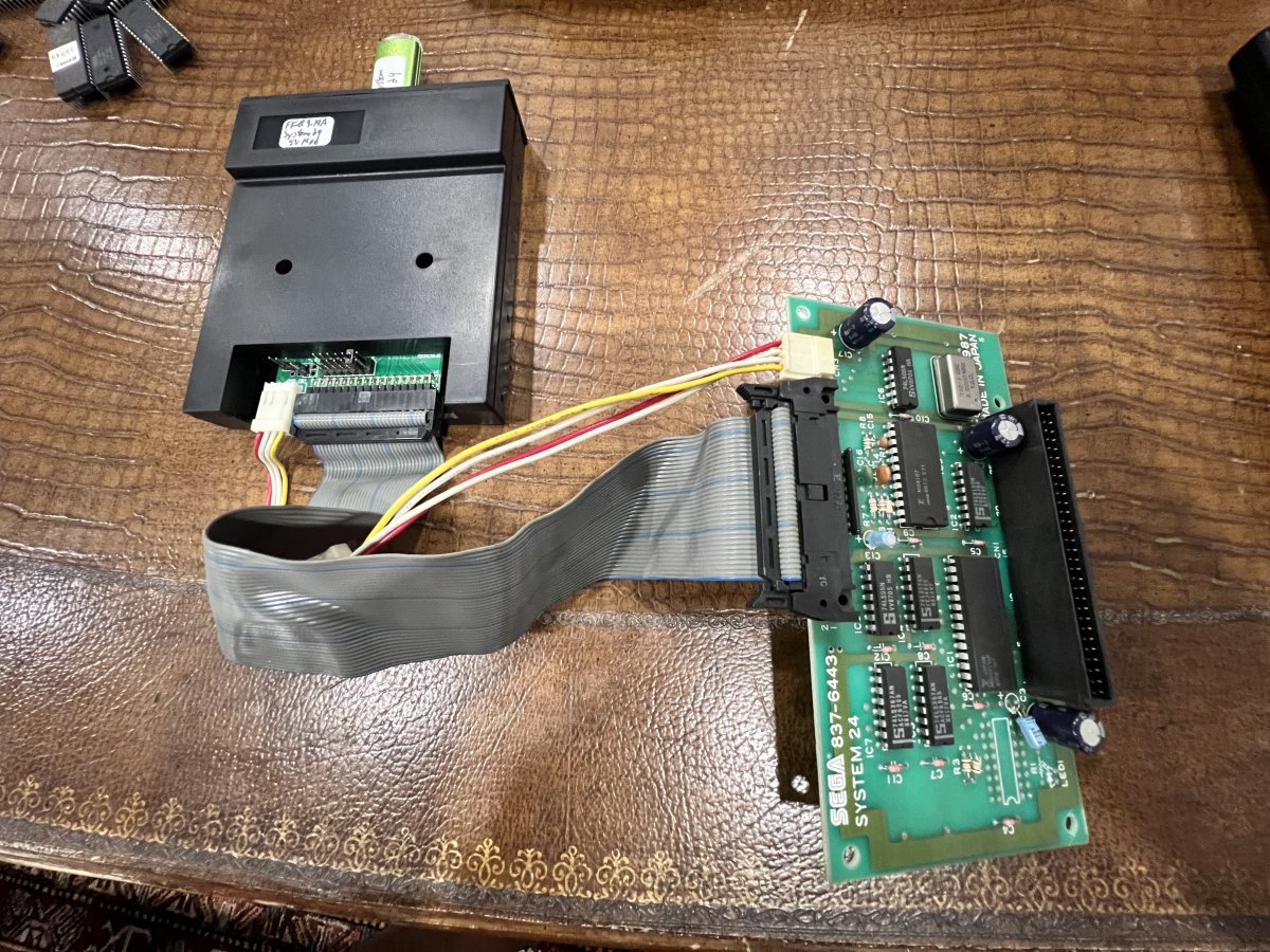

THIS IS THE ORIGINAL S24 ribbon cable. If you get a new one with your kit ignore this and follow @Mitsurugi-w ‘s directions!!!!!!

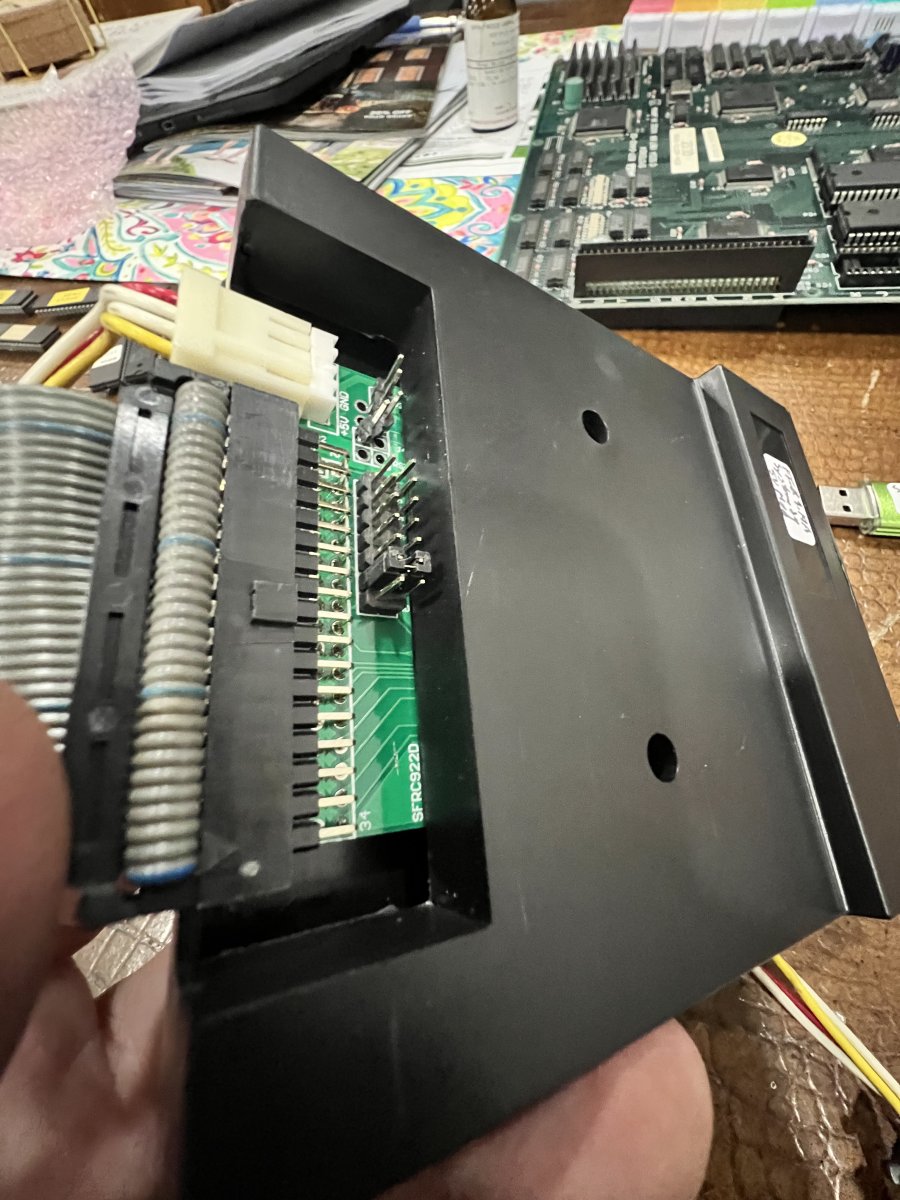

Here is what the floppy drive PCB looks like plugged into drive emulator and with a thumb drive plugged in. THIS IS WHERE I BLEW UP MY OSSC. @Mitsurugi-w, you owe me a free repair buddy.
See how this fucking thing has a notch in it? See how the fucking ribbon cable has a notch in it? Well, DO NOT fucking use the notch. If you do, you will blow the audio out of your OSSC (and get a "floppy data not found" screen). DON'T DO IT! FIGHT YOUR INSTINCTS! Plug that shit in the WRONG way, trust me on this.
here we are, plugged in the wrong way.
Now on the PCB end, you HAVE to plug it in the correct way, it won't fit the other way, unless you shove it in really hard. Don't do that. Just do it the right way.
ANNNND, you're done.

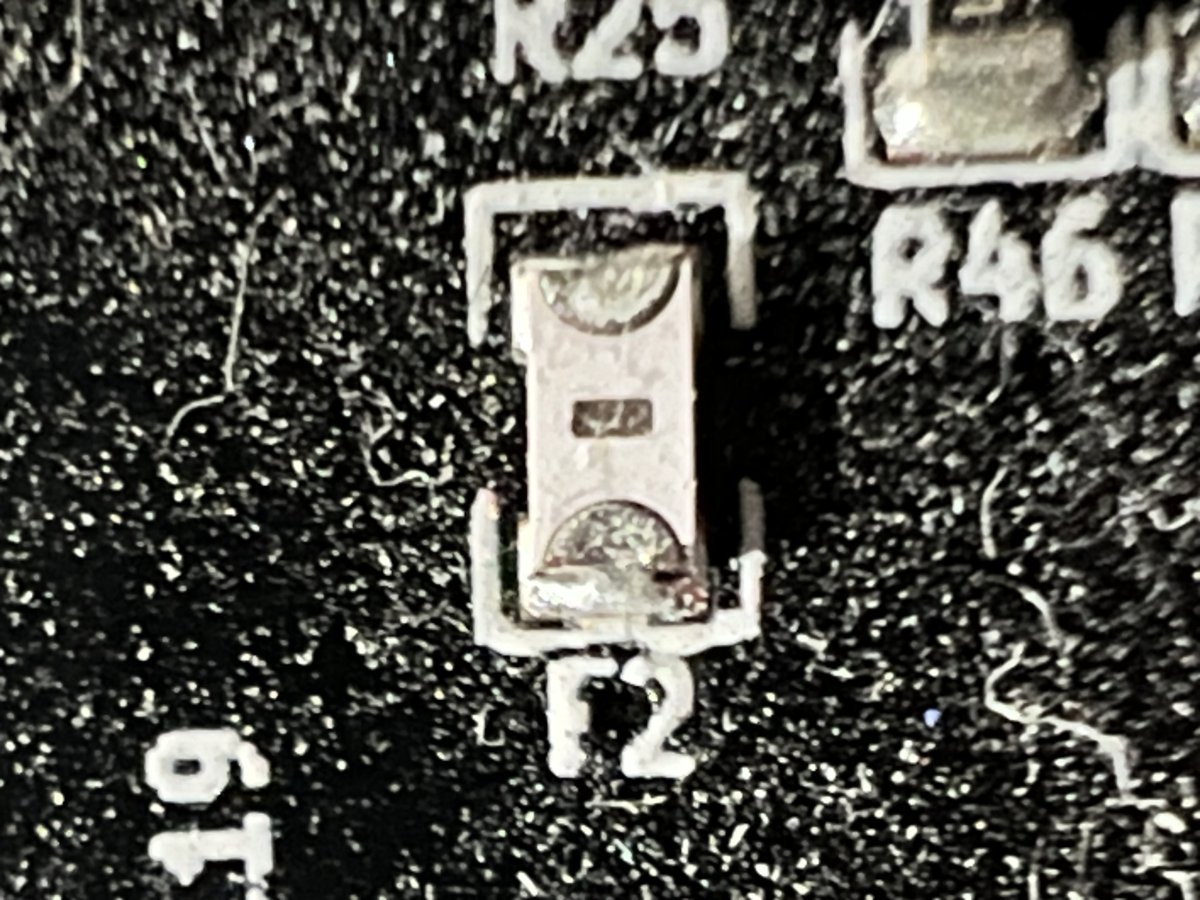

Her is my F2 fuse on my OSSC. I don't have a DMM handy, but it looks like a giant gap in the middle (F1 is solid), so I'm hoping the fuse saved my OSSC, so once I find someone who can do tiny surface repair, I'll let you know!

1: Yes its a pain installing that kit on the romboard. That's why we created the v2 kit that simply replaces the entire romboard. ;)
2: Is that an original s24 floppy cable? I've never had one. The cables I buy and send with the floppy controller repros I sell MUST BE plugged in using the notch. Let me know because it is indeed good info to know if the original is indeed reverse from normal cables.
3. If the fuse is indeed blown I can easily fix that for you.
