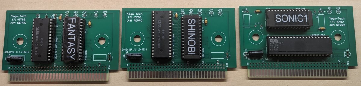

With these 1mm longer Redux carts, the fake shells are fine.
Got the master system roms permanently transplanted to the redux PCBs too.
Legit bootleggery here :)
