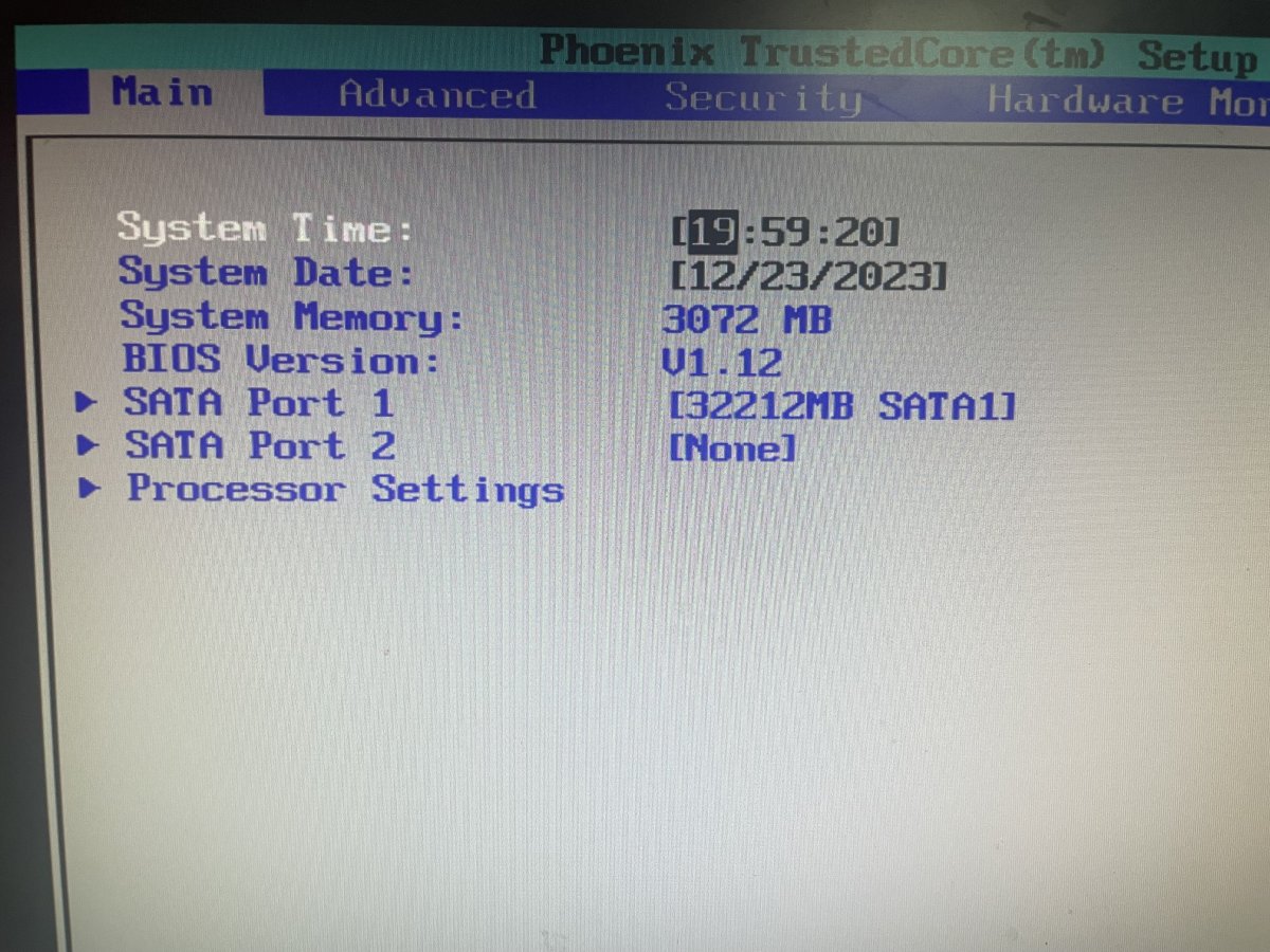

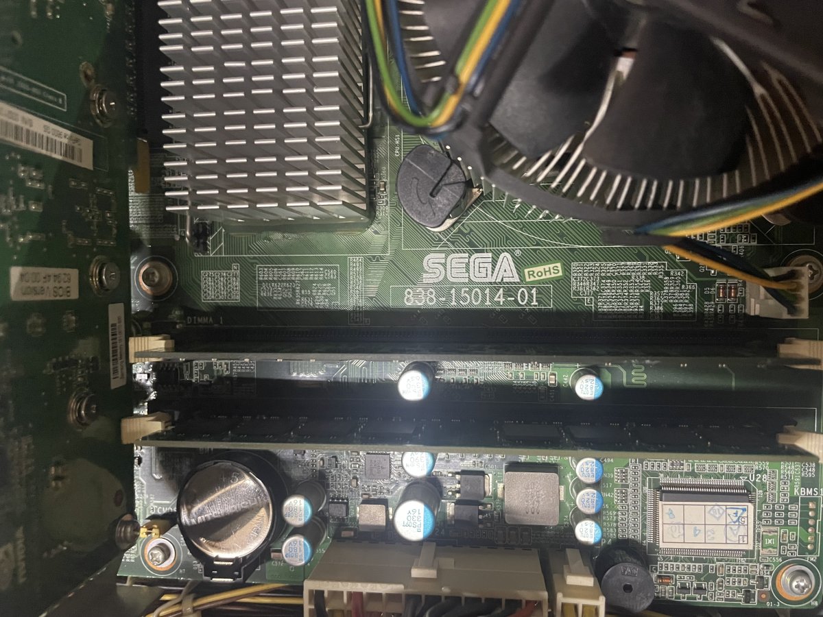

Sorry to necro-bump this thread but it came up when I was working on mine! on the RE1 32GB image you can simply create an additional partition at the end of a larger disk, I'm using a 120GB so no need to use 2 disks. You also don't need to worry about the keys and locking the drive if you disable drive security in the BIOS so you can use any drive you like.
You can upgrade the processor to a Q6600 on BIOS version 1.12 which is twice as fast as the default Celeron, it's also possible to upgrade hardware drivers by coping the inf and sys/dat/dll files onto the drive when mounted on another PC if you need to update the graphics card. The Windows partition has the enhanced write filter enabled but any attempt to disable it results in loss of the other volumes on reboot.
You can upgrade the processor to a Q6600 which is twice as fast as the default Celeron without updating the BIOS, it's also possible to upgrade hardware drivers by coping the inf and sys/dat/dll files onto the drive when mounted on another PC if you need to update the graphics card. The Windows partition has the enhanced write filter enabled but any attempt to disable it results in loss of the other volumes on reboot.

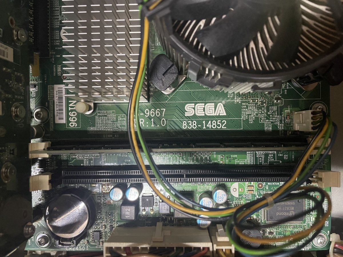

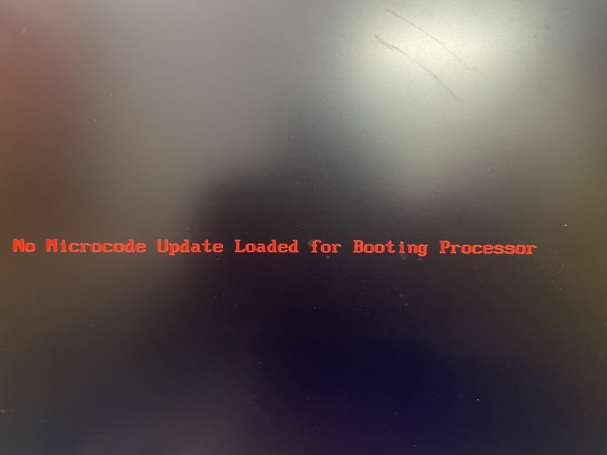

Q6600 838-15014-01 Ok
838-14852 No Microcode Update Loaded for Booting Processor

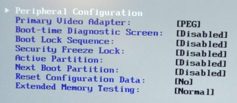

And just so noone makes the same obvious mistake as me you have to make those bios settings from a locked drive first.

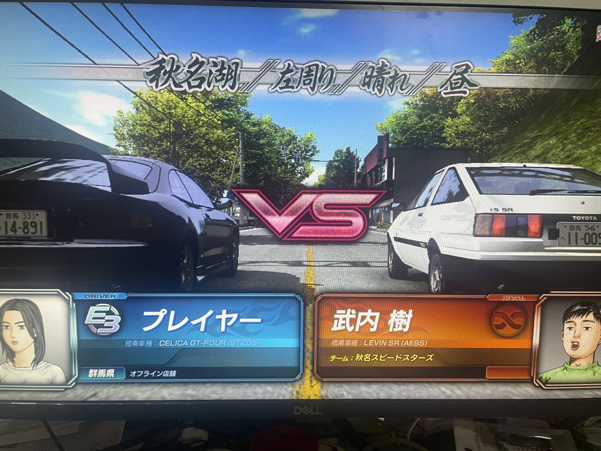

Cool, an actual Thread about the Multi., thank you:)...can anyone tell me, if there is a way to add and run Ringedge/ringwide shooters or racers?
And, Gehirn, since you mentioned it; I still have 1 locked RE, can someone give me a link to an easy desription how to unlock it?
Unless you have the required io boards and add ons for the guns, wheels, etc those games don't boot so there's not much point adding them and I have seen others say some dont anyway. The only one I have seen working footage of added to the multi is Initial D 8 I think.
Accessing bios only works for Ringedge 1:
-Access the bios as mentioned here with your locked multi drive made from the first post.
-As shown in chunksin's post turn off "boot lock sequence" and "security freeze lock". Sorry can't remember which of the headings its under.
-Unlock your multi drive with victoria and the key as per first post.
