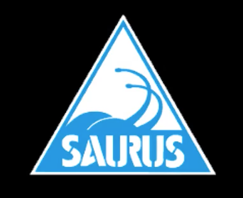

@Vortex hoping you might have some insight. I'm working on a MVS 161in1 with the DIP style C rom daughter boards. I'm not having any luck getting the C rom working correctly. I've had no problems with all the other flash'd roms, but something is off with the C roms. I've tried multiple different daughter boards against 2 different CHA boards on a couple different MVS motherboards and they all do the same thing. This picture from the start if winner stakes 2 shows whats going on the best.
This is what its suppose to looks like
It looks like all the data for the sprite is there, but just seems to be drawing individual rows of pixels are on the wrong lines. This makes me think C_ADDR[3:0] or PBUS[19:16] lines are somehow in the wrong order since these seem to deal with pixel row number. I've looked over the verilog and traced out those lines between the cart edge, cpld and flash chip and seeing any issues there.
hrm I did a quick test by reversing the order of C_ADDR[3:0] in the verilog and its working now.
I did this, but the real fix must be some place else.
Code:
// orig wire [23:0] C_ADDR_1 = {C_LATCH_U[2:0] & MASK[5:3], C_LATCH[19:17] & MASK[2:0], C_LATCH[16:4], CA4, C_LATCH[3:0]};
        wire [23:0] C_ADDR_1 = {C_LATCH_U[2:0] & MASK[5:3], C_LATCH[19:17] & MASK[2:0], C_LATCH[16:4], CA4, C_LATCH[0], C_LATCH[1], C_LATCH[2], C_LATCH[3]};
Yep. Just swap it in the qsf file:
set_location_assignment PIN_118 -to C_ADDR[0]
set_location_assignment PIN_119 -to C_ADDR[1]
set_location_assignment PIN_120 -to C_ADDR[2]
set_location_assignment PIN_121 -to C_ADDR[3]
to
set_location_assignment PIN_118 -to C_ADDR[3]
set_location_assignment PIN_119 -to C_ADDR[2]
set_location_assignment PIN_120 -to C_ADDR[1]
set_location_assignment PIN_121 -to C_ADDR[0]
This happened because in the AES version of the cartridge these pins are swapped and strictly tied to the logic and I had to add the scrambling procedure into the STM 32 programmer.
