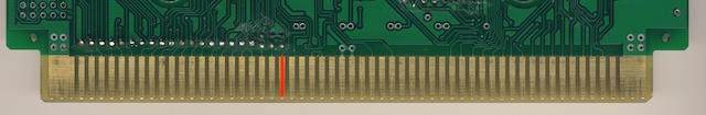

Is it possible that this one goes to B24 68KCLKB ?
Yeah I think you are right, here is a pic
Thanks so far! I'll update my notes with what you found.
I just realized there are 2x HC14s on the board after looking at your picture again. Its super hard to read a couple of the labels on my langsquenet board and thought there was only one of them. In the trace for the LS161 and HC14 above, the HC14 referenced it always the left one. I've updated that post to reflect that.

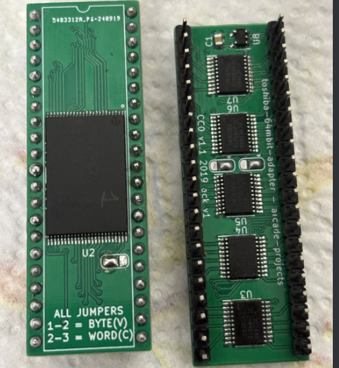

Ah the C-roms (but this also solves the bigger V-roms)? mm... could we have a "advanced/SMD" version that incorporated this on the pcb?
This supports new active parts availible at Mouser:
MX29LV320EBTI-70G-TR
MX29LV640EBTI-70G-TR
tested and working ins this thread:
